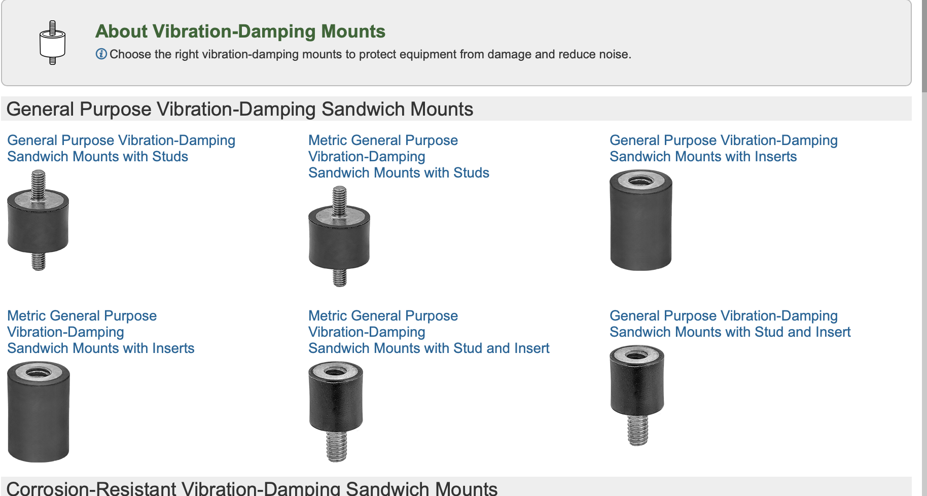

Anyone with a NS4710C HST (or similar) made any changes to improve the ride? Mine is beating the fool out of me on bumps on our tree farm. We have roots and small dips and contour changes everywhere so there is no real way to avoid them. I’ve made all the adjustment I can on the factory suspension seat and it helps but not enough. I have R4 tires which I think are firmer than the R1 tires that could have come on it. Anyway made a changes like a better seat or switching tires to help? Thanks.

When we got these tractors almost 20 years ago the way the dealer had them set up bounced too much for my old back. Maybe some of the things I did will work for you.
TIRE PRESSURE: First is reducing the crazy high tire pressures. Our Kubota is twice the weight of of your Kioti, and running lower pressure has worked fine for years. Running lower tire pressure will make a big difference in comfort, but will slightly shorten the tire life.
Our Kubota has the original R4 Industrial tires - Titan brand, on Titan wheels. Both tire and wheel are made in the USA - which surprised me.. Specs on the tires say they are "comparable" to 8 ply tires. Fronts are 10x16.5 and Rears are 17.5 x 24. Tractor data says yours are 10x16.5 & 14.9x24 . so we have similar tires.
I run 22 psi in the fronts and in the rears. What are you running?
FRONT AXLE: : The front axle center pivot slop or clearance is adjustable on our Kubota. It might be on your tractor too. It makes a big difference if I tighten it up every year or three. The adjustment is done via a tapered pivot bolt into a bronze bushing. The axle slop is is set by raising the front end off the ground with the loader, tightening the pivot bolt into the bushing until there is just a little slop, and then tightening down a lock nut.
SEATS: Absolutely nothing beats an aftermarket Grammerr 12 volt compresser type air cushion seat. It is what all the truckers and tractor operators prefer. Universal fit seat mounts with the standard 4 bolt seat mount to the floor pan. Grammer makes one to fit everything. Yes, I have one on the big backhoe...but not on the Kubota - although someday I will. They are costly and worth it. People here on TBN even put them on riding mowers and zero turns. I'm talking about a thousand dollar seat with an air cylinder and 12 volt compressor.
Be aware that Grammer also makes spring suspended seats, but they are only a little better than the stock tractor seat.
About the stock tractor seat... there are a couple of things you can do to help it. Our Kubota still has that horrible seat with a few mods: First, Look under the seat and see how many springs it has. If it has only two springs, sometimes there are pre-drilled holes where you can add a third spring or even more. That allows you to soften the adjustment and still have the same amount of springiness. While there, Lube the tension adjuster and get it set right for your weight. And add a cushion seatcover.
Next thing I did on our Kubota seat was to buy some one inch high vibration dampening rubber mounts. They made a lot of difference for little money. Put them between the standard 4 bolt seat mount and the tractor floor pan.
