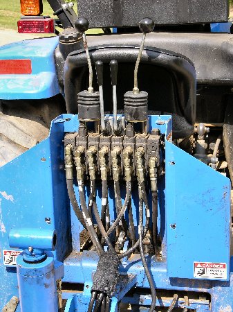

My suggestion would be to remove the cover over the BH valve block (see picture). Then follow the hoses from each left/right cylinder and reverse the hoses on the valve block itself. Then fire up the tractor and see if the cylinder will work using the newly positioned valve. This way you can rule out the cylinder as being the culprit right off the bat and you'll also know if the problem is within the valve block.

Pineridges suggestion is a good place to start to isolate the problem from the hyd. block. You could swap the swing hoses and see if you can't turn the other way. Also look at.
1. The bolt/nut that hold the handle in place under the rubber boot- It may swing easily one way and not so much the other if it's loose.
2. Check your proportioning valve that diverts Hyd. Prx. from front to rear. Probably not the cause as your other hydraulics work but....
3. These backhoes will work even when idling, just not such a quick response or powerful so you should not need 2K RPM's to diagnose.
Keep us posted on where the gremlin resides.
