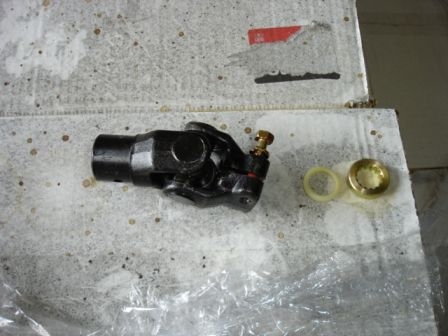

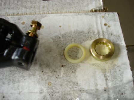

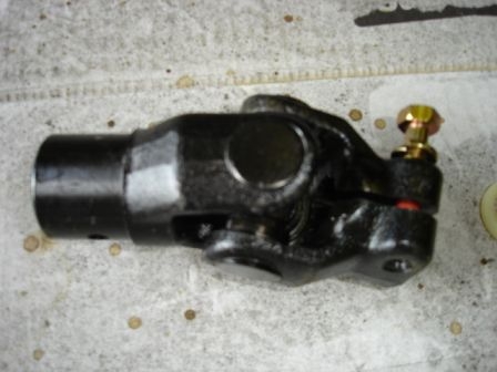

Just got back from the dealer who applied the new yoke and bushings today. They also replaced the fuel and temp gauges as well. The revision dated on the back of the gauges were dated 4/4/05. I'll attempt to attach some pics of all.
So far I haven't put any time on the RTV, just to back it on and off the trailer, but I'll drive it more today and give some type of feedback. Just remember I thought initially it was fixed the first three times as well.
If you can tell in the pics the three parts are the clamp-on type yoke, a brass collar, and a plastic bushing.
This fix is not out formally, it just was supplied hot off the engineer's desk and I guess they are using my RTV as a test machine. I hope it works. /forums/images/graemlins/grin.gif
After trying to attach the pics they are too large, 160K and I think the limit is 100K. Need some help. I can email them to some one who might can post them another way. /forums/images/graemlins/confused.gif
   / News on RTV shaft rattle? #47
Let me try this again /forums/images/graemlins/mad.gif
   / News on RTV shaft rattle? #48
BINGO. I've got a few more pics.
   / News on RTV shaft rattle? #49
Again
