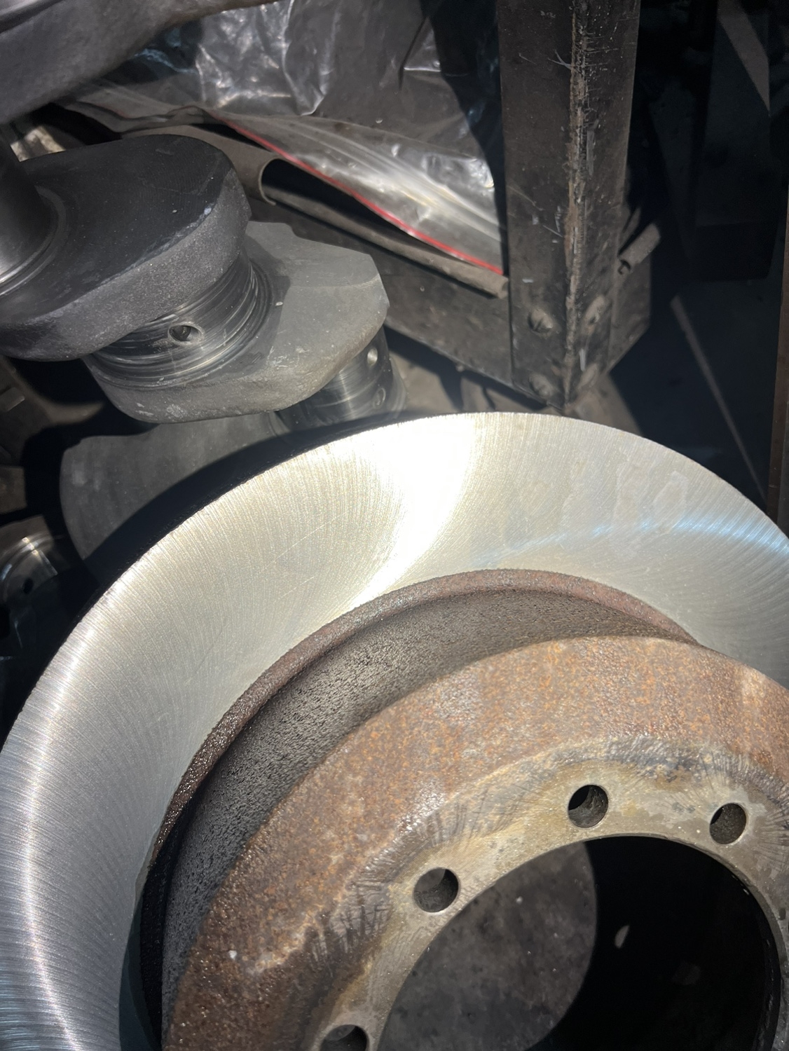

I put rotors on my F-550 a while back and I surfaced 2 of them but the other 2 were beyond saving and they were $110 each. They were too big for the parts store to do in the brake lathe but I have access to a flywheel grinder which did slick work of the rotors.
