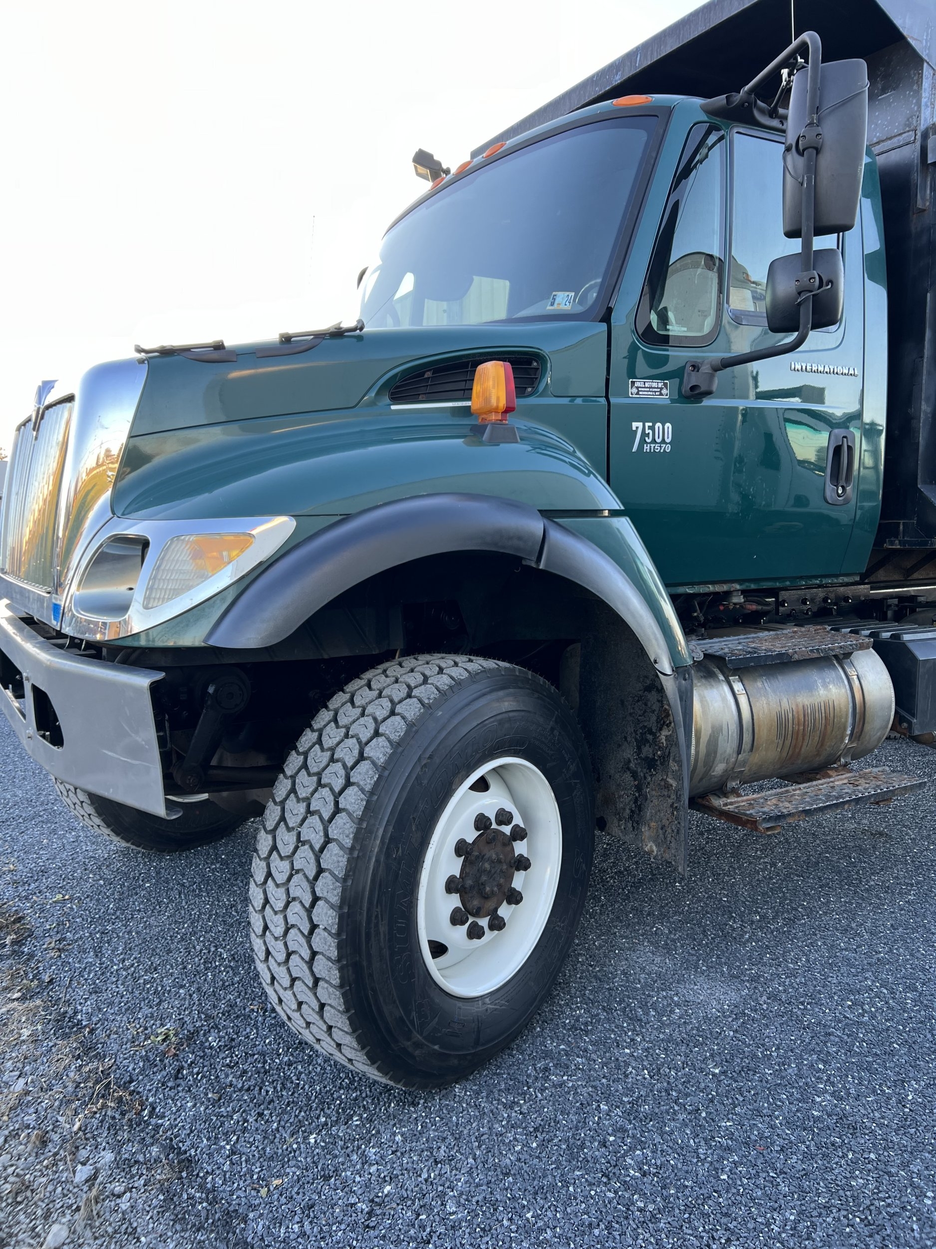

Well, I got the wheels & front tires on. Everything worked out fine except one thing.
First, here’s the truck with the new wheels and new front tires. Did I tell you the wheels are white?
Might be hard to see, but they are white, if you look real closely, you will see.
So we had an unexpected problem. As we were bolting the rear duals back up, the passenger side went right on with no issues. The driver side was a different story.
The previous owner must have installed different, shorter studs on the drivers side rear drum. The studs are about 5/8” too short and won’t pass DOT. So now I have to remove the wheels, pull off the drum, press out the studs and install longer studs then reassemble. I have no idea why this was done, unless the studs were all damaged, needed replaced and the wrong studs were used.
