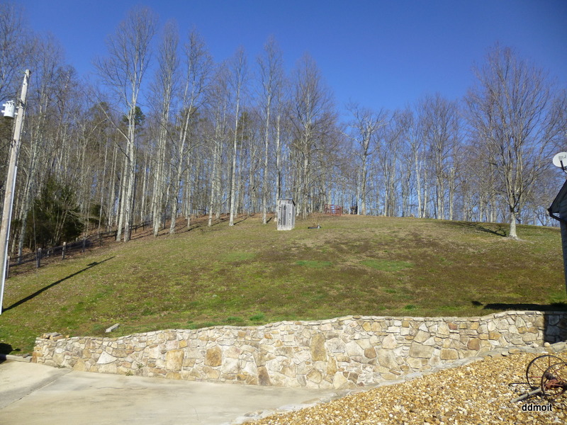

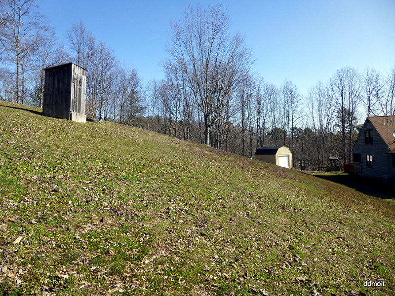

Here are some pics of my property where I try to capture the slopes...

/ New to owning acreage #14
I would be cutting grass with a ZTR, Them slopes look mean for a tractor.

#16
Pretty much everything that needs to be mowed is on a slope - hardly any flat spots.

/ New to owning acreage #19
Whatever you decide to buy had best be quite robust in the hydro trans , and be serviceable . You are going to generate alot of heat mowingand that will kill a light duty unit . Have you ever mowed this place , and with what ? Very nice place , love the crapper .
