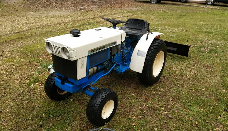

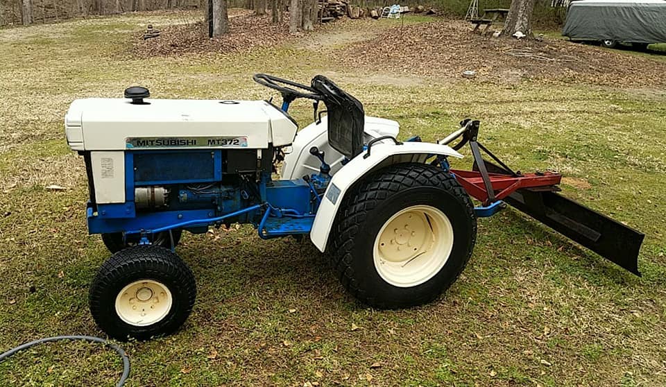

Hope there are still a few people out there loving on these little tractors. I absolutely love mine and I've only had it for a week now. Have already scraped my gravel drive and fixed a washout area in the back of my lot. It's a great little tractor. Would really love some help with the below questions if anyone has the time to help a "newbie."
-How long is the factory top link--mine has one on it now but it seems too long (21inch) on this setup but that look to be "standard" cat 1 top link length
-I'm missing the throttle "knob" and was wondering if anyone has found a suitable replacement and if so where I could source similar
-With the blade on the back the front it is VERY light and was wondering if anyone has some suggestions for a cheap front weight setup I could create (no welder unfortunately so I'm pretty limited in that respect).
Other than that it's very COLD NATURED (hard to start when cold) but that seems to be a common quirk of these little workhorses.
THANKS IN ADVANCE FOR ANY HELP!

Looks like a nice tractor and someone recently painted the wheels.
I found a shifter knob at Ace Hardware in their automotive section that worked great for mine although I can't really see the lever on yours. Mine was a Bolens G154 with a flat, tapered lever. The one at Ace was for a round lever but conformed to the tapered flat lever nicely as it was pushed on. You can put some RTV in the hole before installation to help keep it on. I bet Napa or similar would have things too that would work for a cheap price. I think I paid around $4 for mine.
Yes, they do not typically start "crisply" in cold weather although I've gotten them to start and run down to 6 degrees F with just glow plugs (no block heater/no starting fluid which you should never use and probably won't help anyway). They would probably go colder but that's as cold as I'm willing to tolerate for tractoring! Fuel gelling can become an issue at those temperatures. I had to jump start it off my truck and it took a fair amount of cranking but once you start seeing black smoke you're building enough heat to burn and it should take off. Most of the problem with cold weather starting on these stems from the relatively small piston diameter and the utilization of a swirl chamber which was typical of the era. There is just so much surface area of cast iron in contact with the small combustion area volumes that it robs all the heat until you get those areas to warm up.
Cheap, convenient weights are not readily had but I've seen a lot of effective "home brew" weights that might be inexpensive such as weightlifting weights, cement blocks, steel plates, etc. I use John Deere 40 lb suit case weights for the front but plan on spending $1-$2/lb for suitcase weights.

Thanks for the reply IlikeurTractor. I just threw some new Y110 Glow plugs in it but didn't see much of an improvement in cold starting. Take a lot of cranking and fiddling with throttle to finally get it to fire. I neglected to do a compression test since it was running fine when I picked it up but suspect it may be just a bit down on compression due to the age.

I found a local scrap yard that I'm going to hit up this weekend to see what they may have in the way of some nice steel plates to bolt to that front end. I am going to also try my hand at adding washer fluid to the front tires/tubes this weekend as well. Figure if there are tubes in there, the risk is minimal for rim rust issues.

You're welcome. Make sure glow plugs are pre-heated 20-30 seconds before cranking. If you have to "fiddle" with the fuel lever a lot that is typically a sign compression is starting to go. The knob I used for my tractor is a 76935 Dorman. I'm not sure if it will fit your handle but works nicely for Bolens/Iseki tractors. I even like it better than the original.

Thanks again...I'll see what O'Reilly's has this afternoon. The TEMPS were much nicer today (60 degrees) and she fired right up. Set it middle of throttle range turned GP on for 30-45 second (hot on the indicator) and it cranked no more than 5 seconds! I was amazed. I had also put a fresh air cleaner in there but don't think that was it. I would be interested to know if anyone uses block heaters and if so what kind of block heater do they use on this one Freeze plug, antifreeze style, etc. I would like to be able to plow snow and really don't want to have to store this in the garage (rather put her int he unheated shed). THANKS again for the reply. Good to hear others are still enjoying this little tractors.
