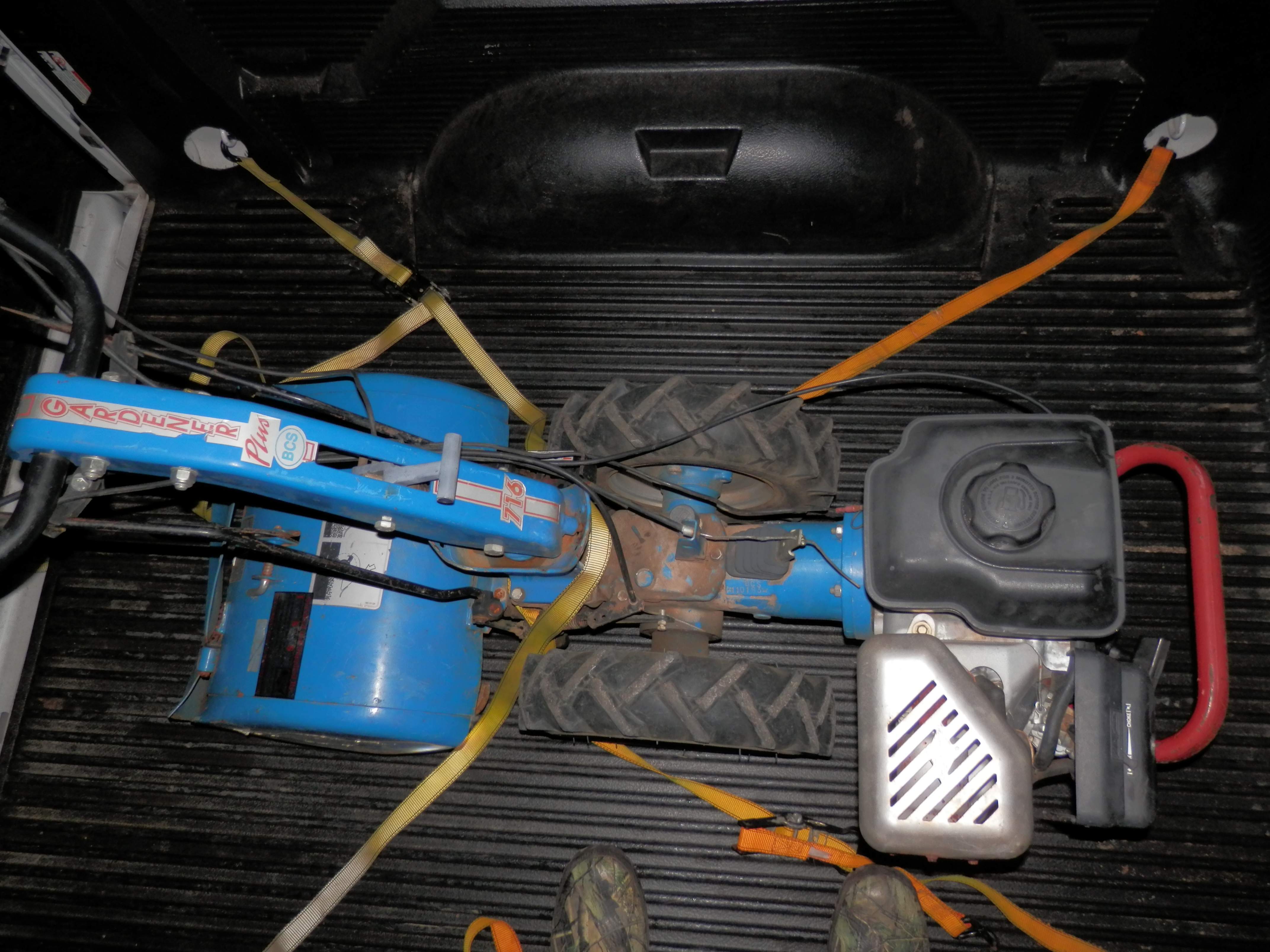

Tried starting a garden last year and the front tine MTD was just making me mad. When I saw this one on Craigslist I jumped on it. It's a 1999 model according to the label on the tiller attachment. It got a new clutch and 5.5hp Intek OHV in 2013 according to the seller. This was the owner's personal machine at an equipment dealer/service center. He had acquired a larger model they were going to repower to replace this one.
Now I'm anxious for some warmer weather.

Nice little rig. It has exactly thee same transmission case as the 730, but with smaller tires (3.5 versus 4 by 8), smaller engine (5 versus 8 hp), and smaller tiller(18" max). You're gonna like it a whole lot better than your MTD. It'll make a bang-up tiller.

Your 716 has smaller tires and a smaller engine, but yes, it has the same transmission as the current model 710.
It's not like the 710 from 15 years ago. It had only one speed forward and reverse. They're well built, but aren't much good for anything with such limited speeds.

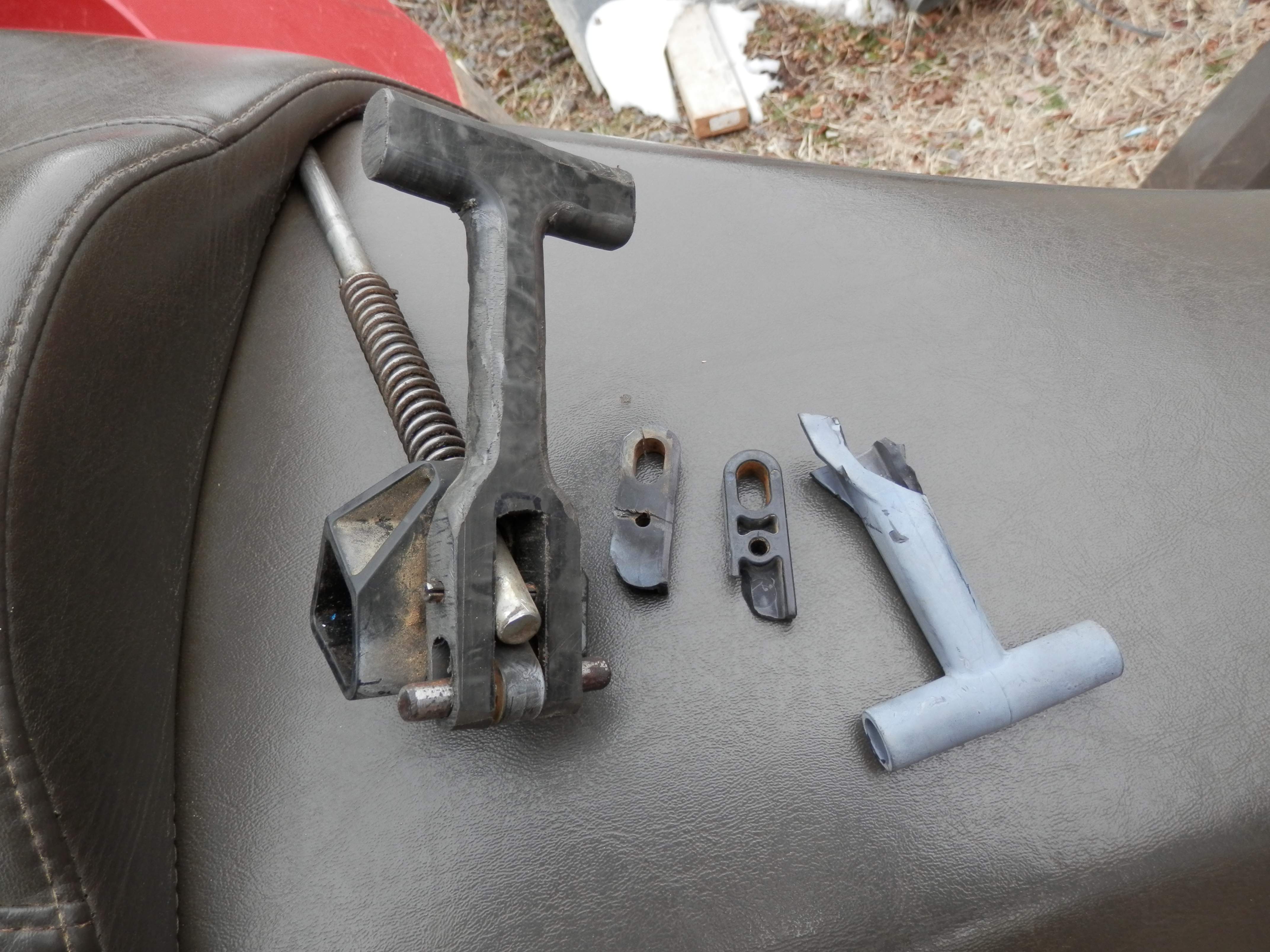

The other item is the handle adjustment lever. The pin was a little rusty and when I went to adjust it yesterday I pulled a little hard on it and broke it right off. I'm going to try carving one out of a piece of 1/2" acetal scrap I have. It looks like it's only a $14 part but shipping makes it over $20 and I impatient anyhow.

That lever was a weak point on them. They were fine if the PO kept them lubed and out of the weather, but would break easily without much persuasion if the pin was allowed to seize. I've seen one lever made out of what appeared to be aluminium. I can only assume the owner was a machinist and made it, as I've never seen another.

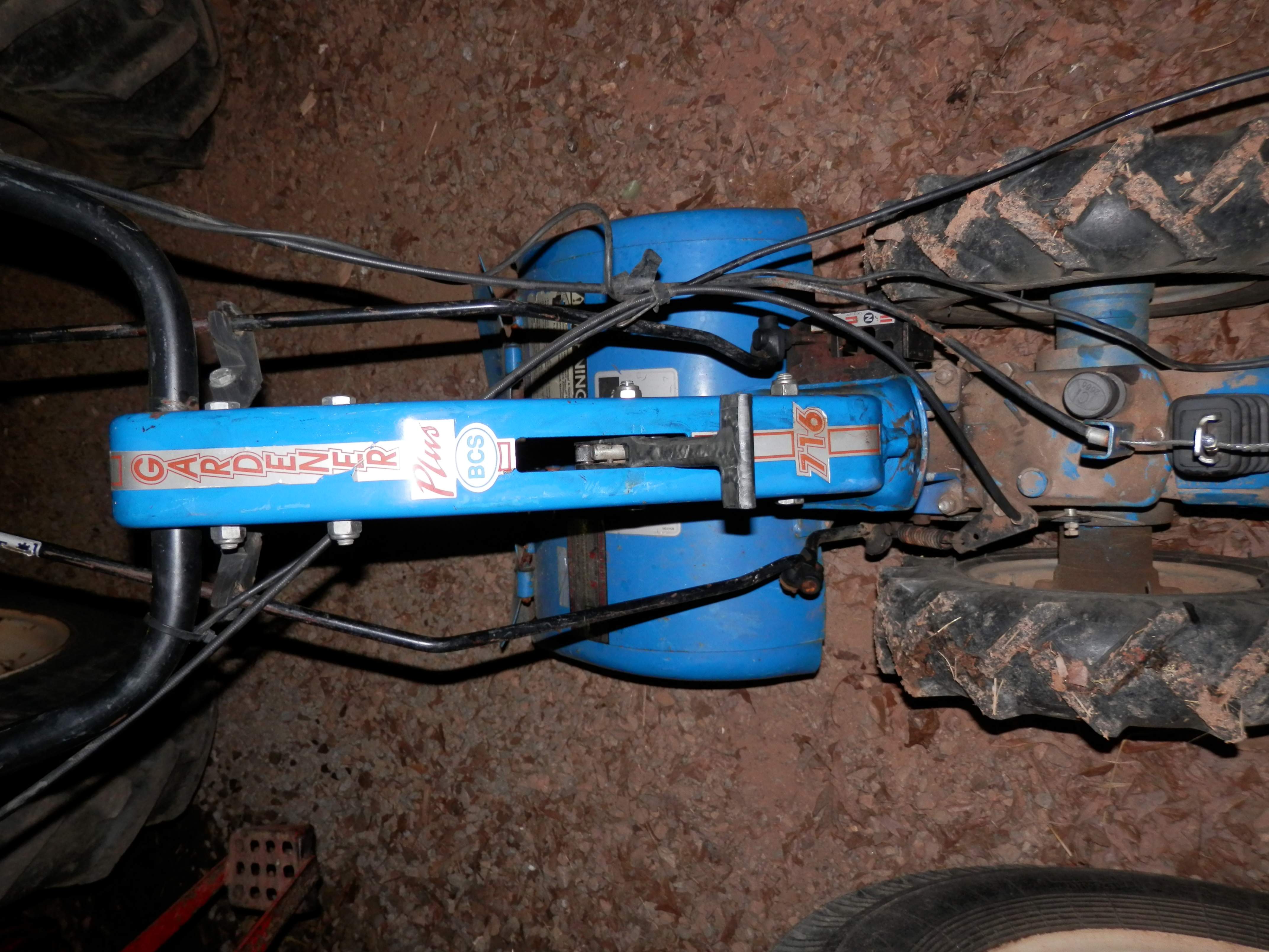

Here's my lever. It started out looking better but I had to trim it down to fit through the slot properly and I just did that with a flap disk. The 1/2" stock got a little thin around the oval holes but it really does work easy now that it's cleaned up and lubed. I thought about steel or aluminum but the plastic was easy to work with.

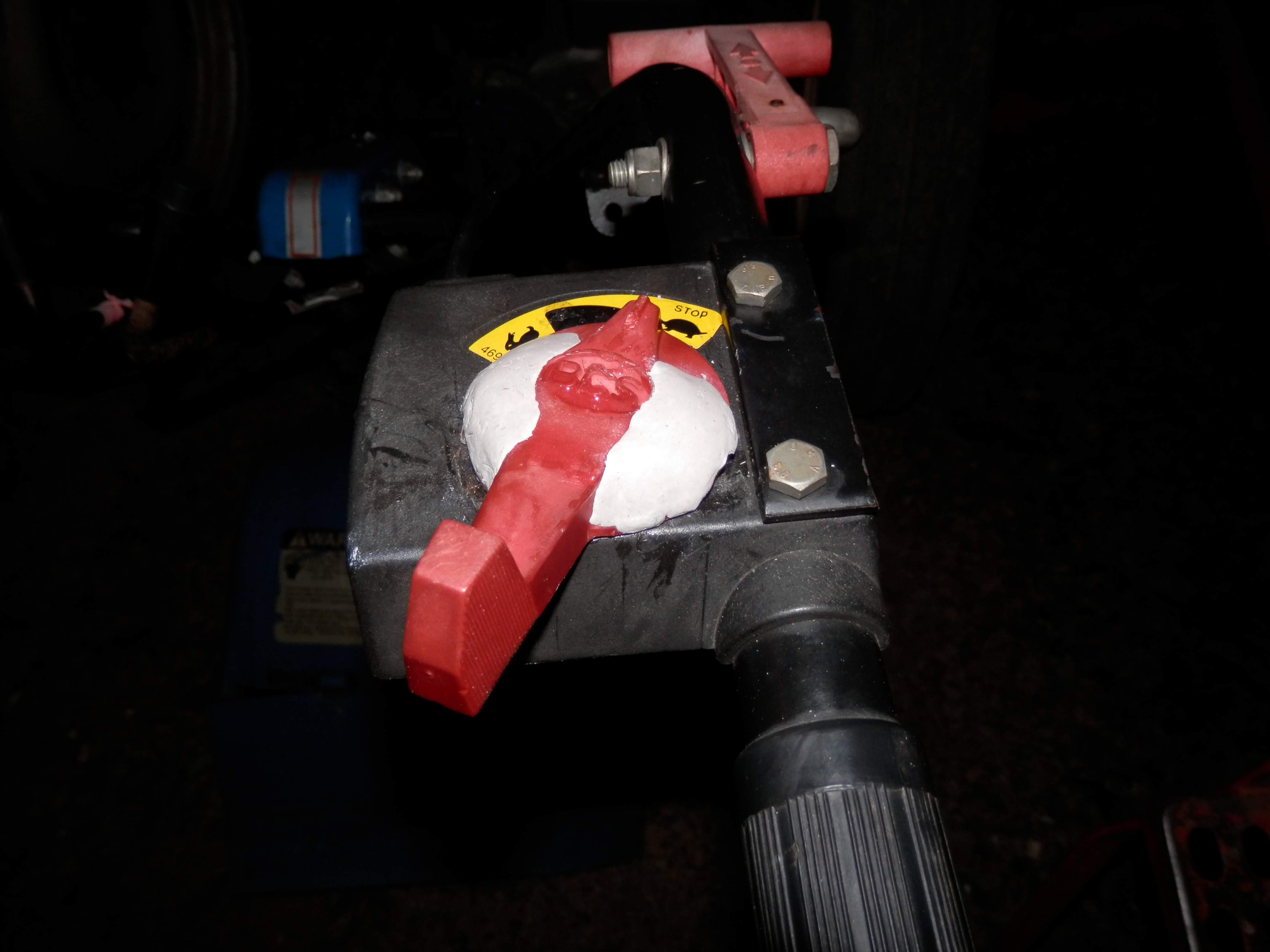

While I had the handlebar off I tripped over it and broke the cool throttle lever. At that point I was "somewhat frustrated". I hope the epoxy holds.

The throttle level on my 722 has been broken for some time. I adjust the throttle at the engine. Some day I will replace it, but so far, not an issue. My 722 is a lot like yours but has the 8HP Brigs IC
