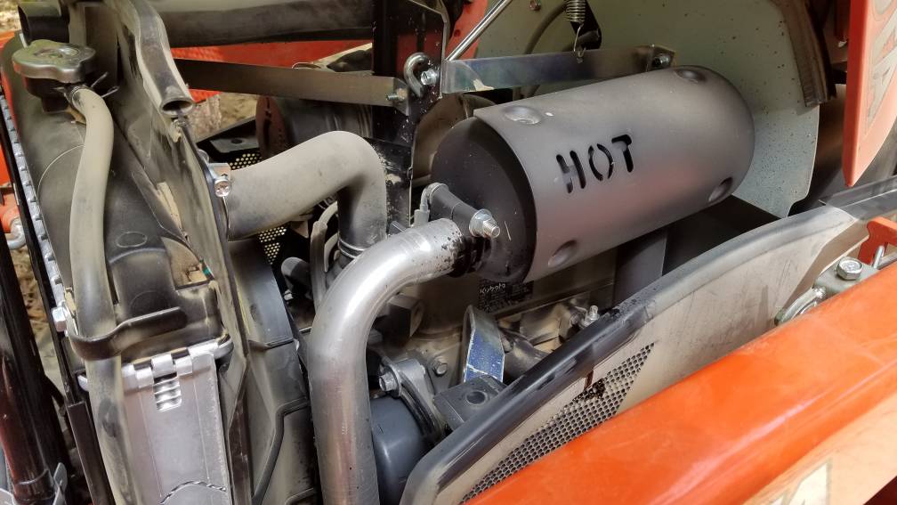

Started the tractor and had light smoke coming out of the front. Looks like oil, not sure if would've continued to come out or not. Maybe I should've ran it for 10 or 15 minutes? I know fuel leaked out some. 20190926_135305.jpeg
   / New to checking fluids #14
Prob just pil that got ontop of the piston. Run it long enough to heat it up if all the fluids check out and you dont hear any noises.
It would have been good to rotate that engine by hand to make sure you didnt hydrolock it. After that fluid check and start it.
