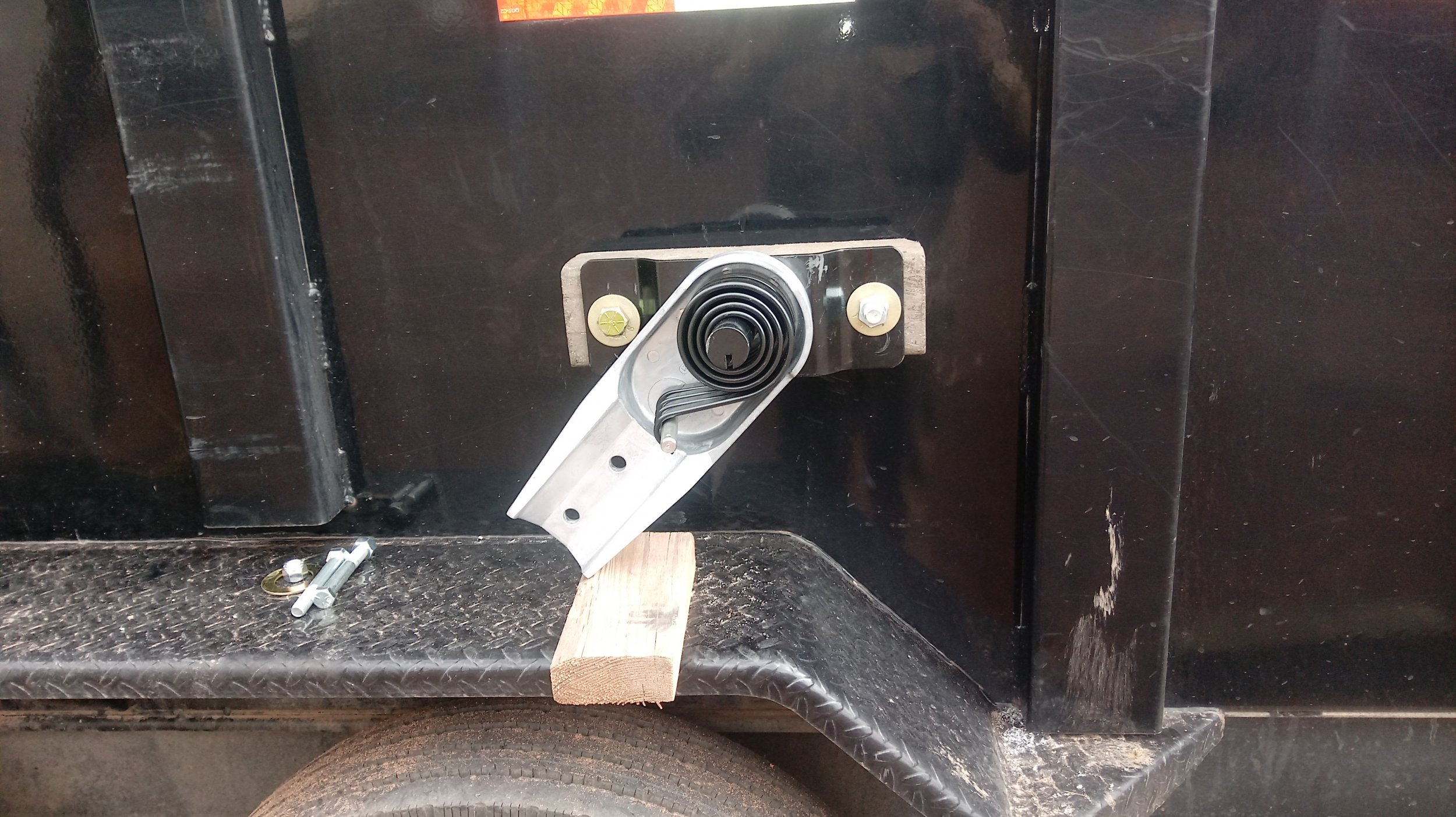

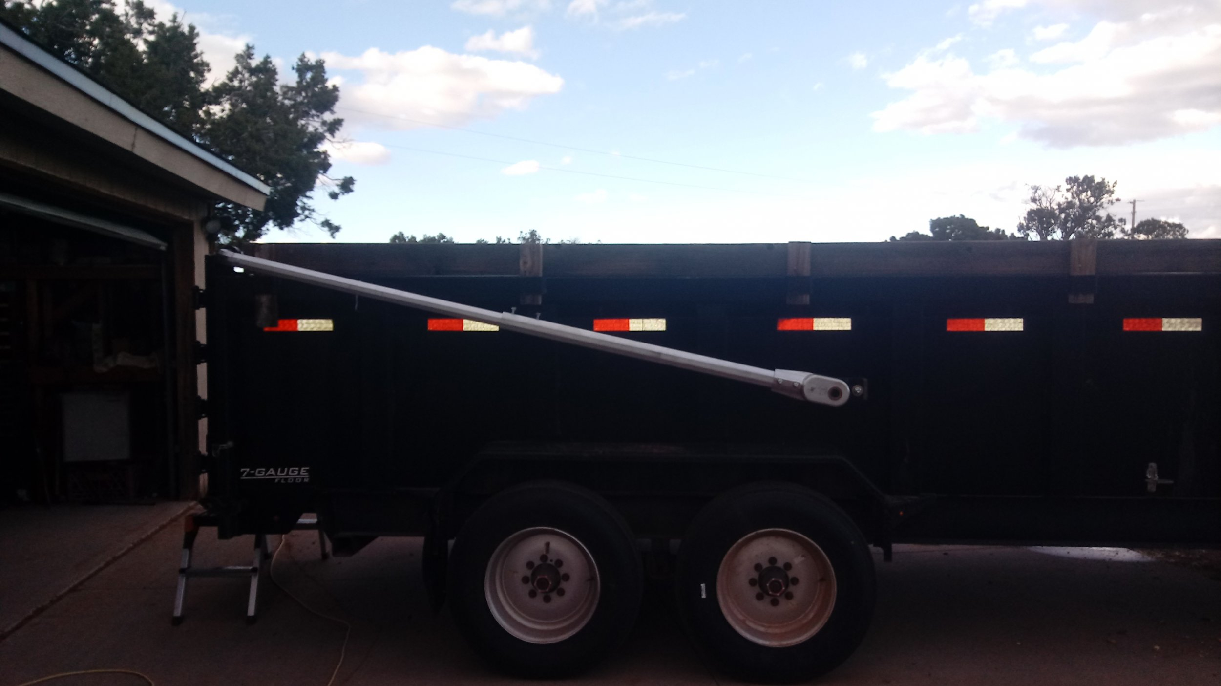

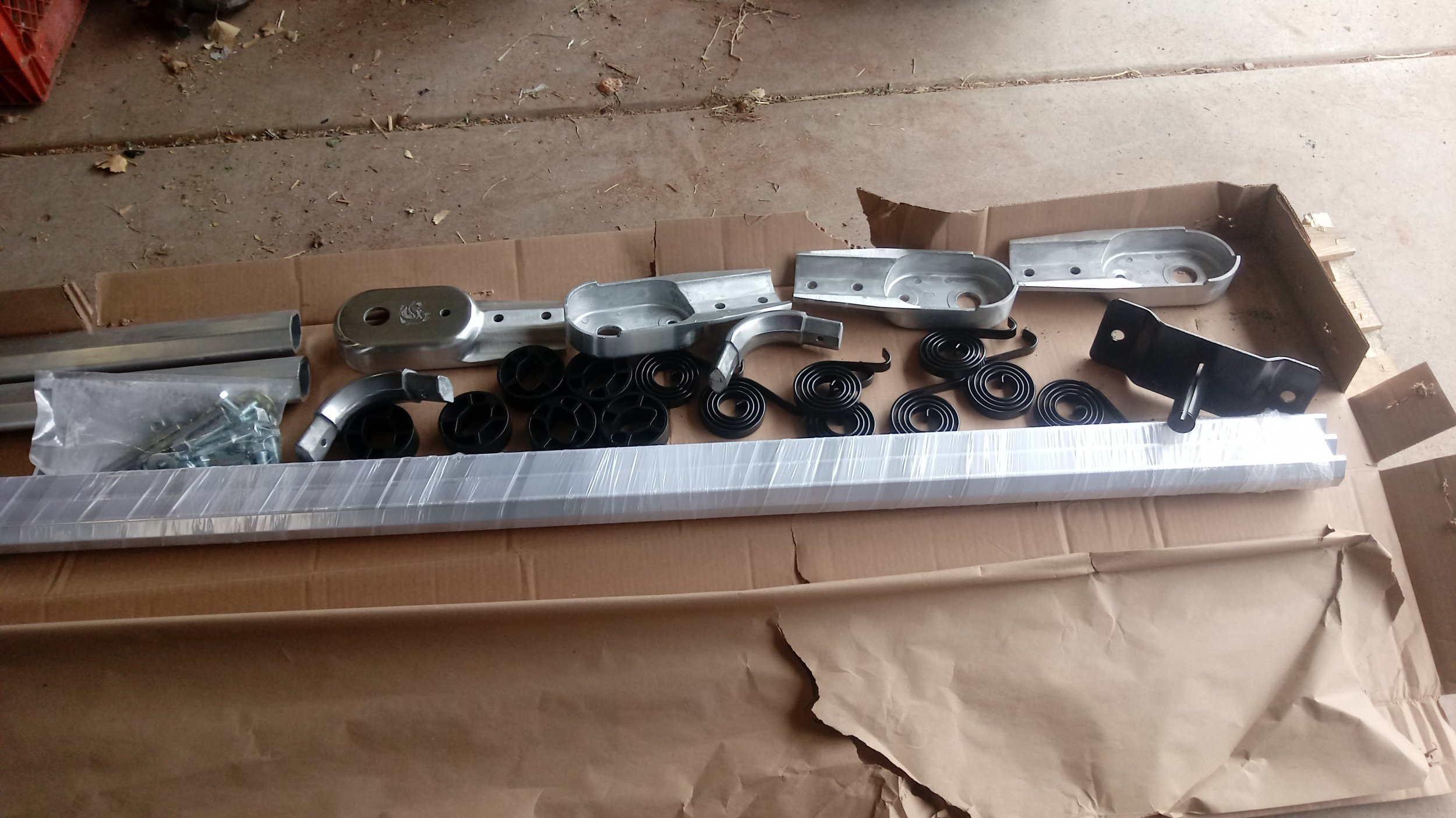

Had a heavy wet load of mule manure on Sunday and blew one out. oem is 215/75x17.5, 8k axles, so I went with 235/75x17.5 Sailun S637, 16ply, 75 mph all position. It is hard to unroll the tarp with a tall load, even with 2 people, so I got a long arm kit to do that for me. Buyers Products 3016666 kit. New set of batteries too. oem were 550 cca, new ones are 800, I had to order one, should be here tomorrow.
   / New tires and long arm tarp kit for my dump.
#2

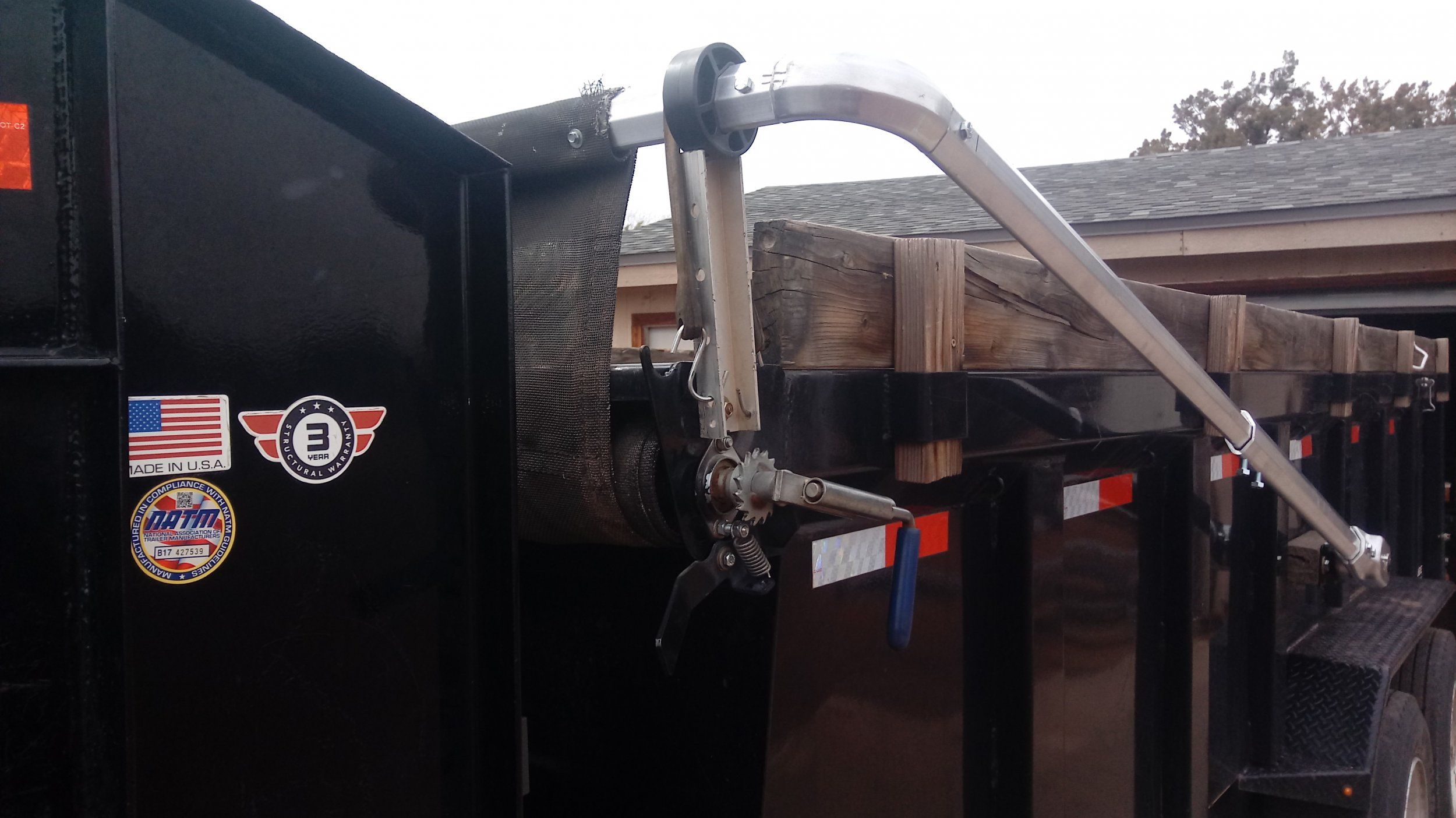

Installed the arm kit but I have to pull at least two springs out, it is way too stout with all four, I could only crank it about 3/4 forward. Then I can finish the final adjustment. The fit and finish is really good other than the 90 degree elbows, they are too tight. You have to grind them some for a slip fit. It is a universal kit, so you have to cut and drill holes for your application.

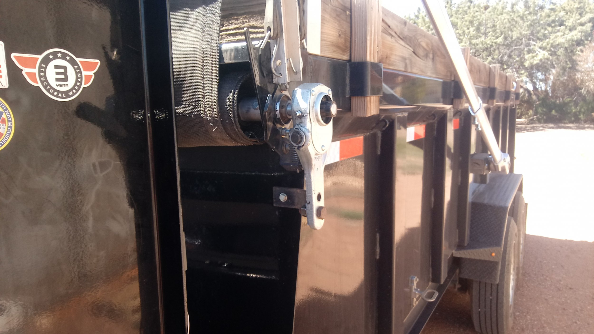

Installed another slack adjuster to my dump trailer. This time to my tarp crank, works good.
Before:
After:

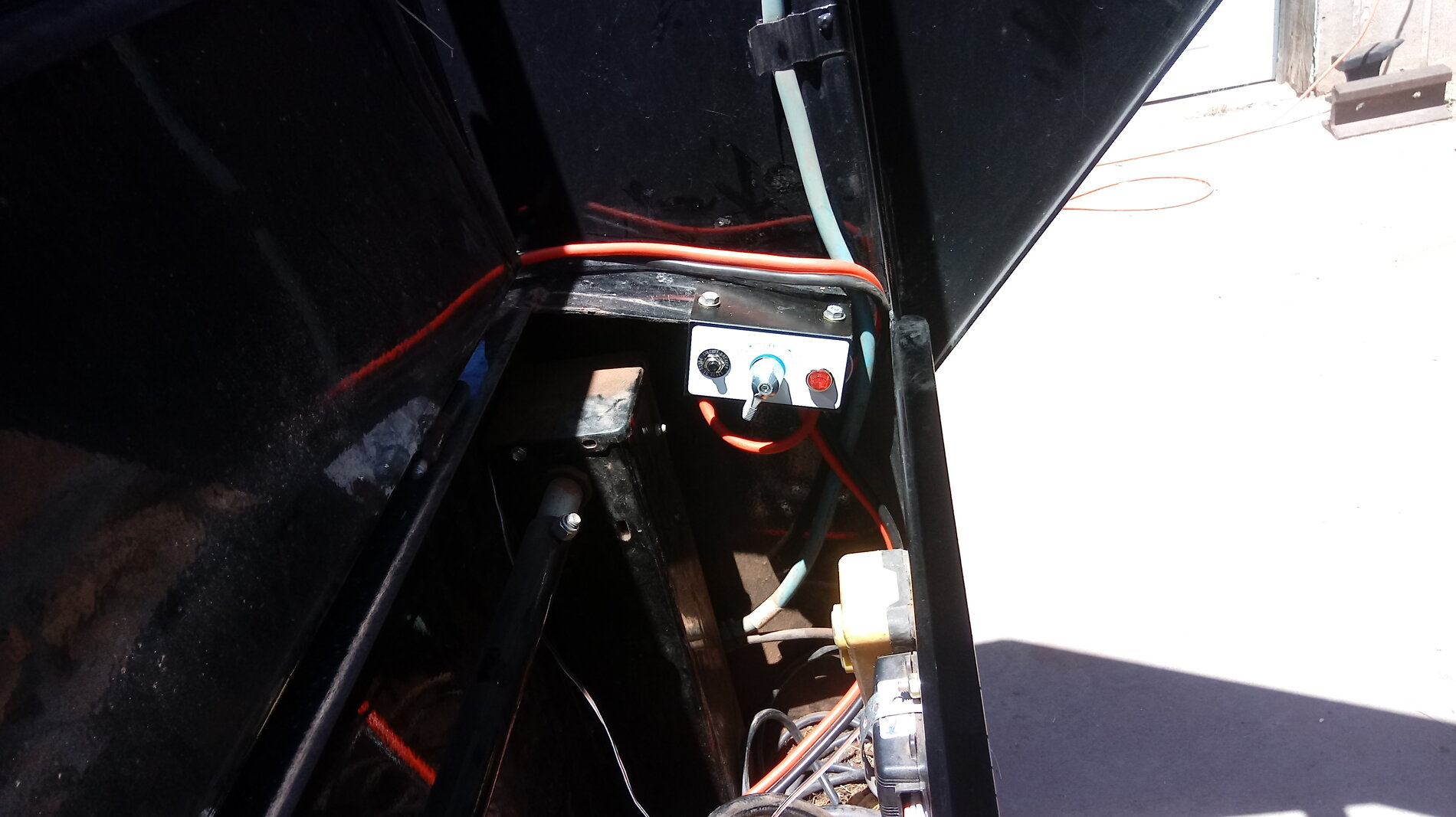

Finished the install yesterday. Nice! Not quite twice as fast (up) but almost. The gravity down is still slow but since there is no battery drain, I will just deal with it. Not sure what the flow is but I think in the 3-3.5 gpm range, standard pumps are 2. The motor on a standard pump is 1.6 kw, this one is 2.2. I was a little worried about programing the wireless remote but it was easy. It is way more handy, than using the corded remote.

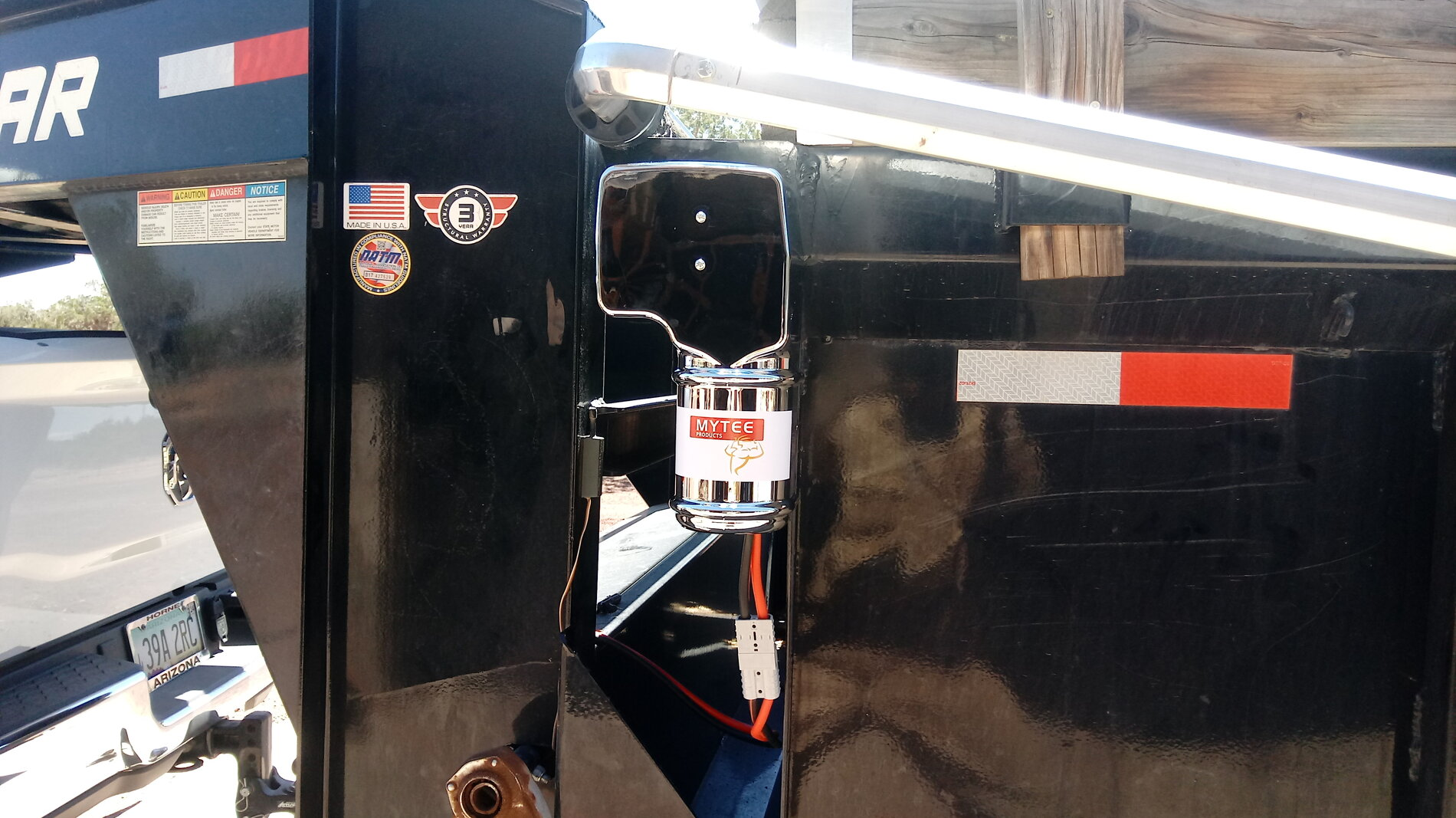

#9
Before:
After:
Too much work, so I installed a tarp motor. Works awesome and fast. The drill had the power, but too slow and would twist me into a pretzel.

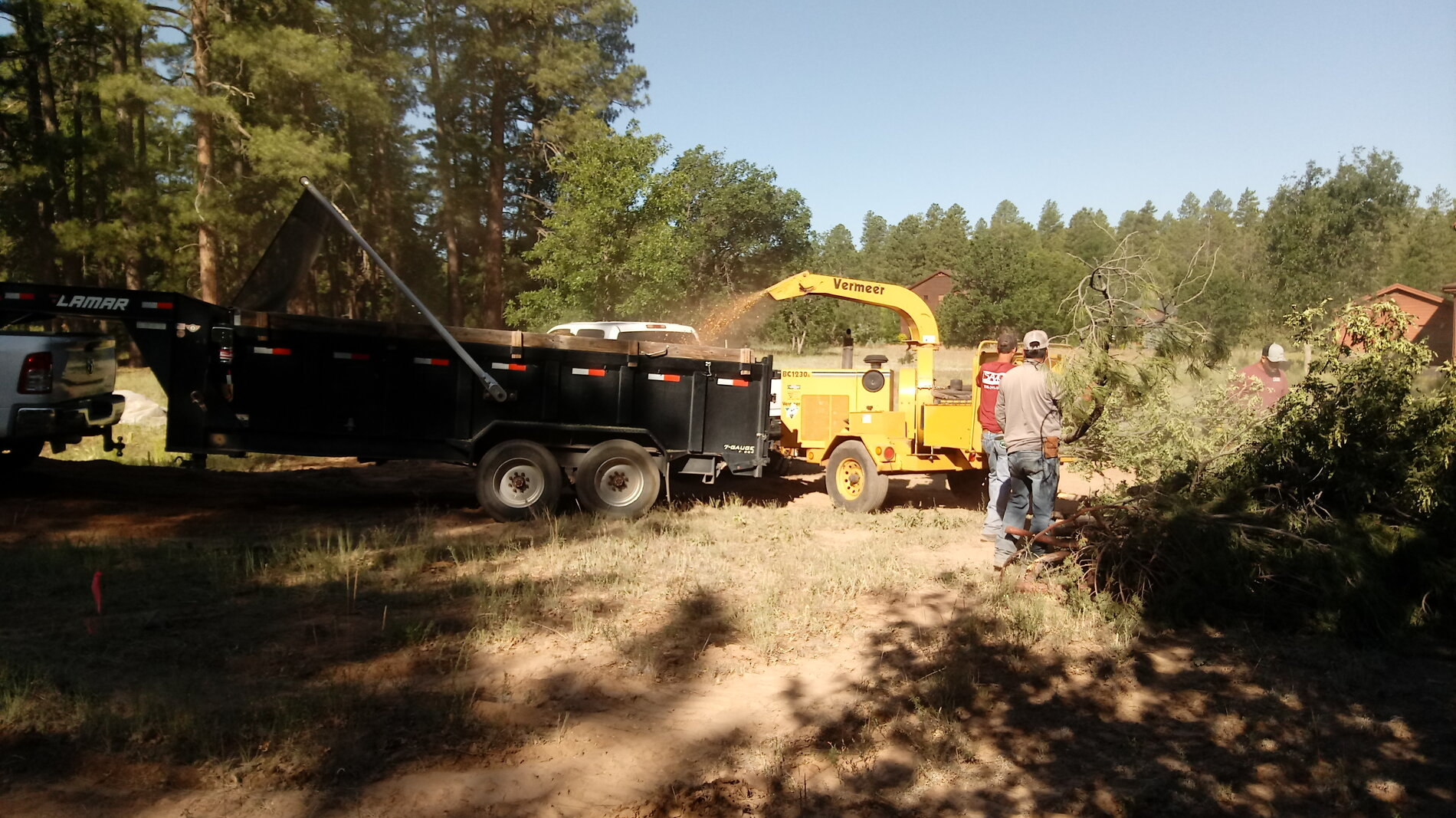

Sure do like this long arm tarp kit. I can deploy it a couple of feet and protect the back of my truck cab. The commercial chippers can throw the big chunks 50' There are times when there is no room to get beside the trailer and they have to shoot it up the rear. I have a small dent above the rear window from the sucker.
It does look like I am going to have to fold out the tow mirrors, the motor is creating a blind spot with them folded in. Even on 7' wide dump trailers I always keep them folded in, due to delivery location obstacles and narrow roads.
