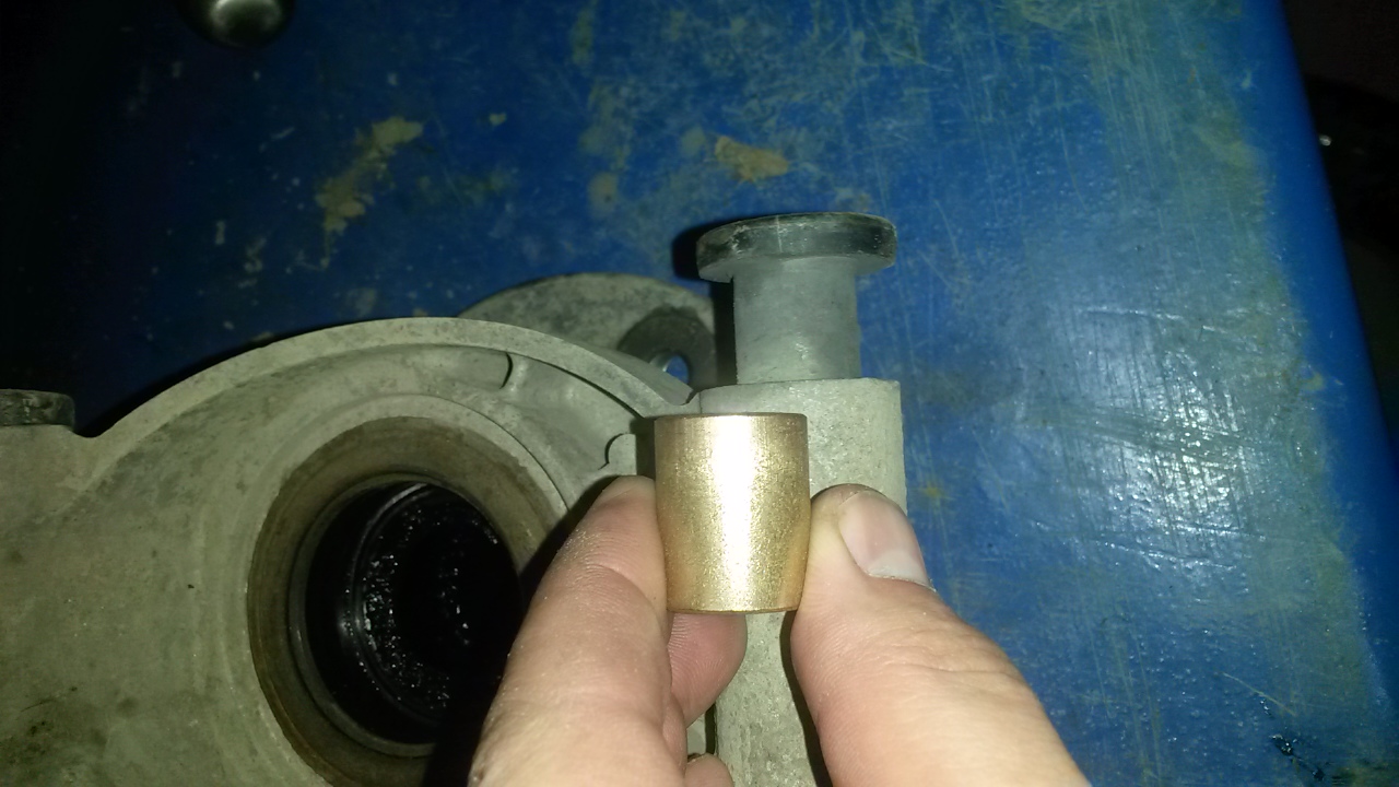

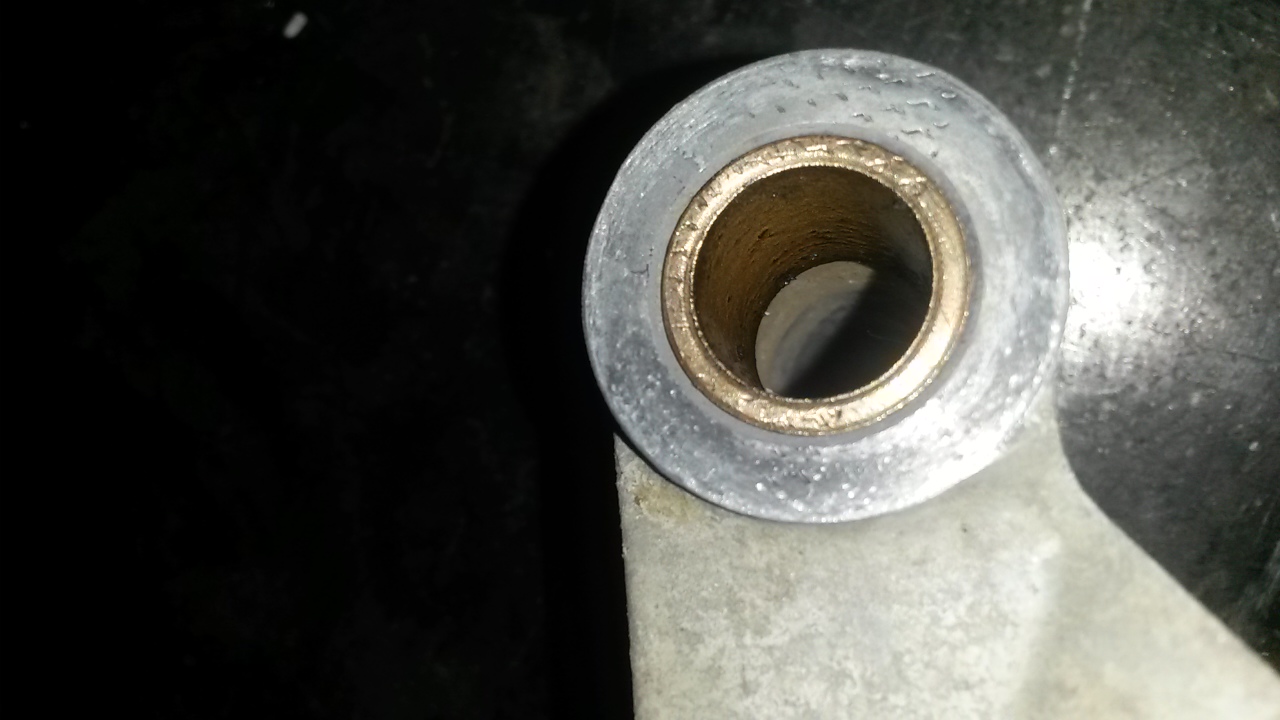

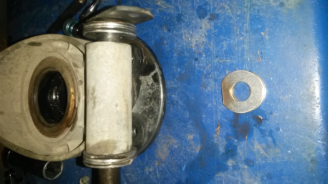

I have more photos if anyone is interested in this repair. Just send me a message.

I recently replaced the same worn "plastic" bushings on a Yamaha 250 raptor, but with OEM bushings. Wear was due to no lubrication because owner did not notice grease fitting. Replaced all bushings anyway and found the lower ones, which were greased, had a lot LESS wear.
Nice job on the bushings, problem solved. To bad Kubota would not follow your lead.
PS: your previous attachments are invalid so we can't seem those.

Dealer fixed mine with a similar procedure to what Great Dane outlined. Was having buyer's remorse but now I'm Very happy!

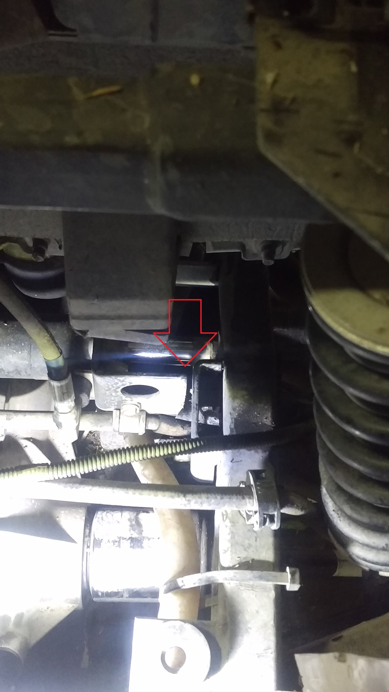

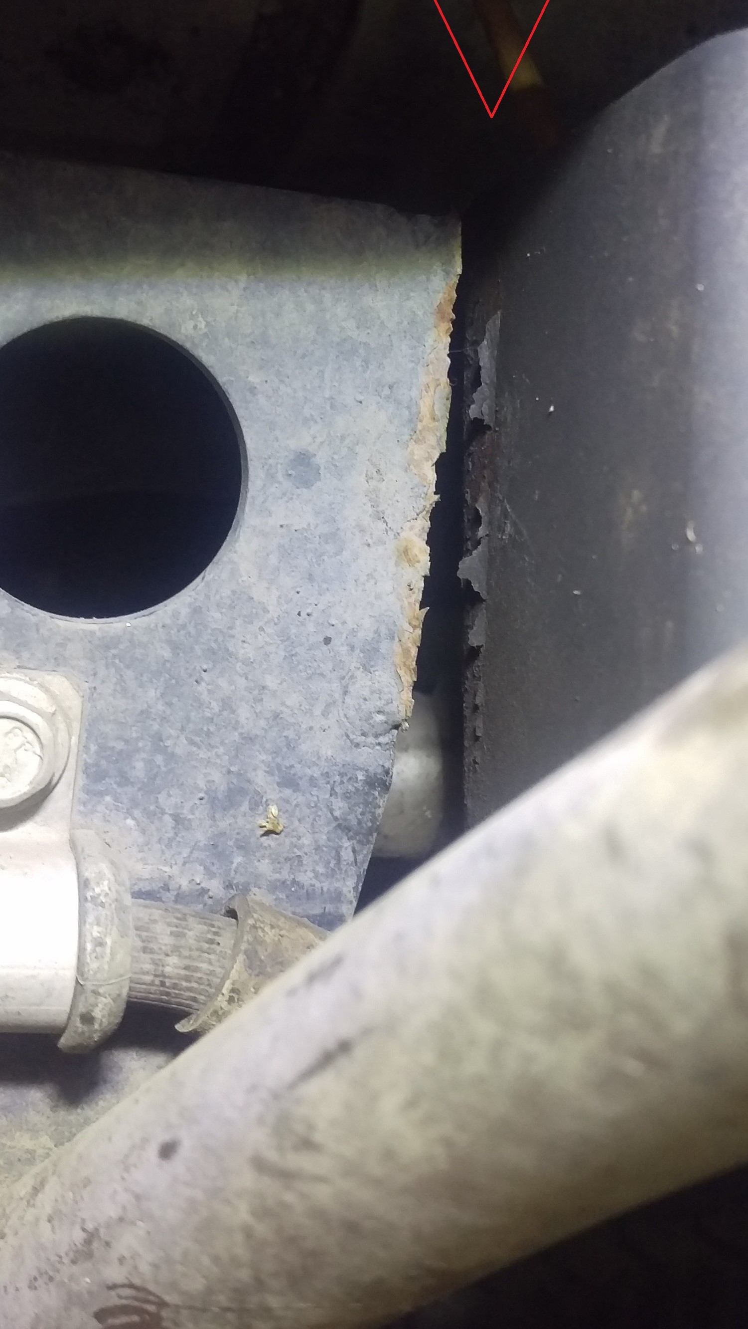

You should also check where the steering ram mounts to the left side of the upper frame rail. I was checking over mine due to abnormal tire wear/change in toe-in and looseness in the steering and found that the weld holding the mount to the frame didn't have any penetration and the frame rail was bent outward 1/4". This caused my tire wear/toe change because the upper control arm (which is the load carrying control arm) moved out ward and forward when the frame bent. I am going to add additional support after I bend the frame back into place. I guess you don't need to be a certified welder to work at the Kubota factory. My Kubota has not been abused and it only has 254 hours on it in the two years that I have had it.

Great Dane could you please provide me with more details? I don't have a lathe but would like to find someone to make me similar bushings. I replaced all suspension components except shocks on my first machine (1120D) with 2000 hrs on it and when it started getting sloppy only about 50 hrs later we sold it. Bought a brand new one and imagine my surprise when it started the nonsense less than 100 hrs in. Wore the tie rod ends out as well. It has about 2000 hrs on it and I'd like to run it for several more years. If I can get this bushing Crap straight I think the other components should be OK.
What size bushings did you start with? On the lower fronts did you just machine bushings for the ends, or do they go all the way through? If I remember correctly the lower fronts took a single long plastic bushing oem?
Thanks for any help you could give me.
