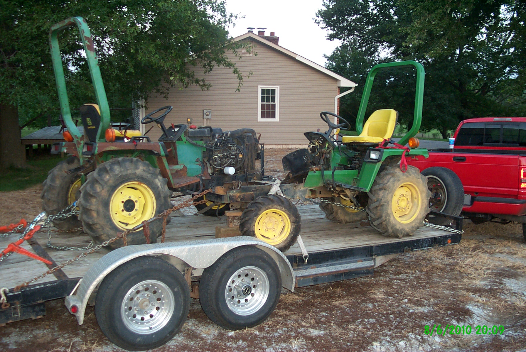

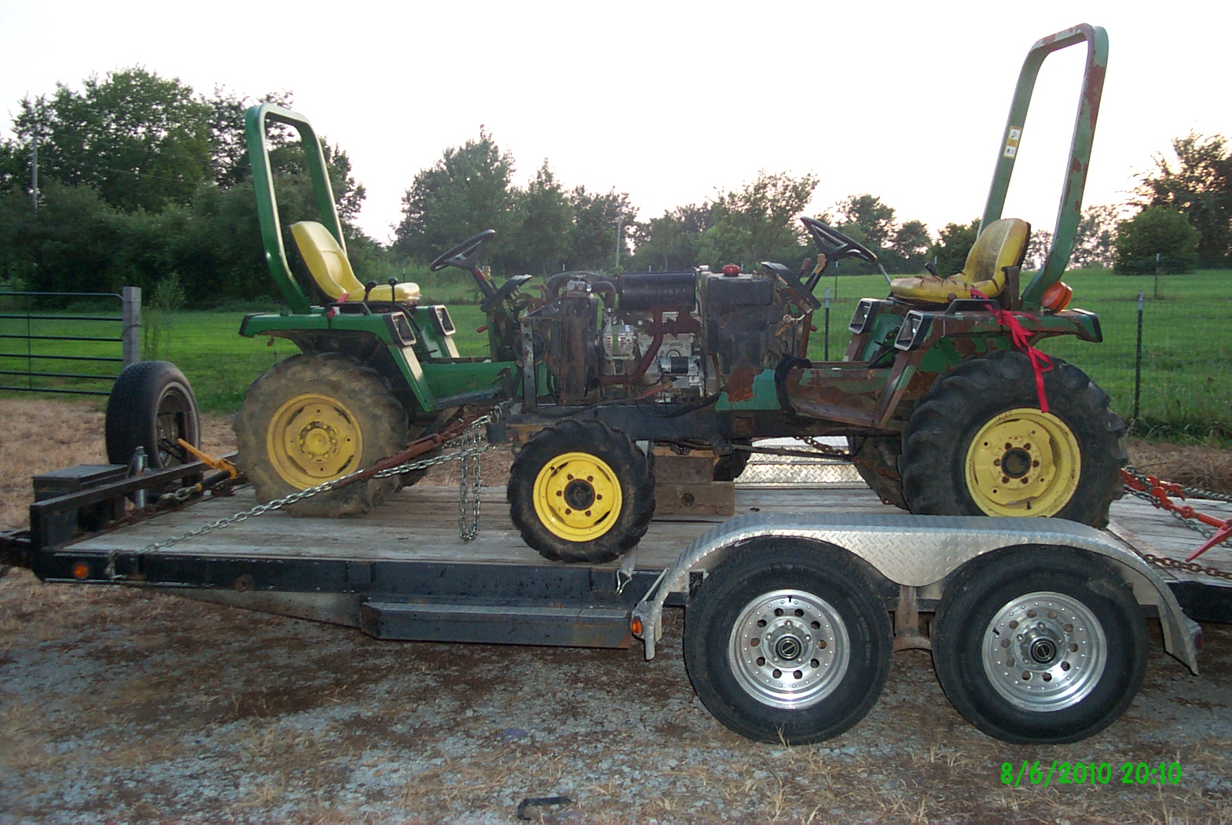

I've been following your progress on the 955(s) over the last 18 months. You have certainly come a long way. How about some pictures of the two CUTs when you first started, and a picture of the current 955 with the new tires?

I've got some pictures of when I brought them home last year, but don't really have much since then.

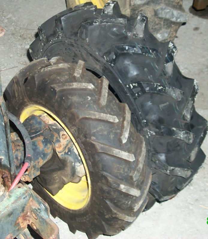

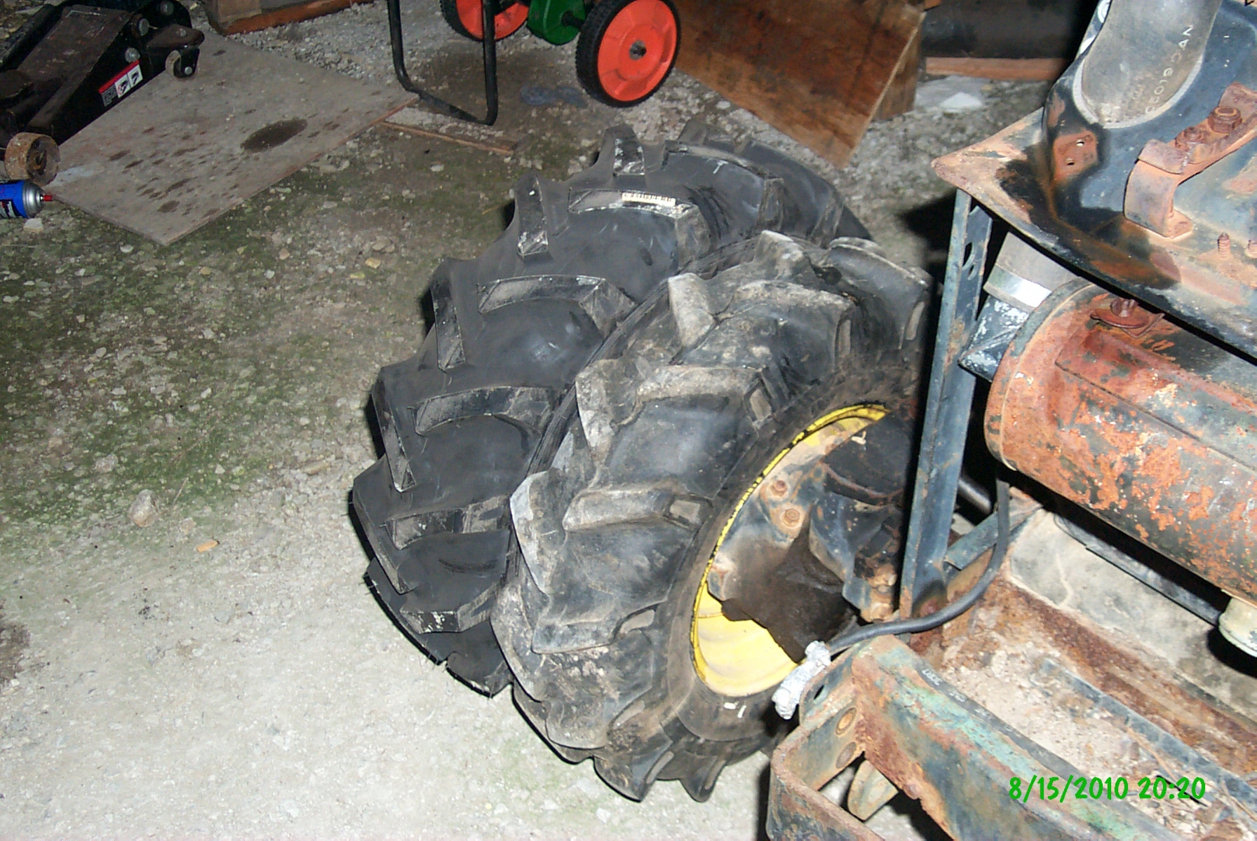

Also a couple of pictures of the new 7.00-12's next to the 6.00-12 on the right front and the 6-12 on the front right. I guess the PO didn't realize that a 6.00-12 and a 6-12 are completely different sized tires.

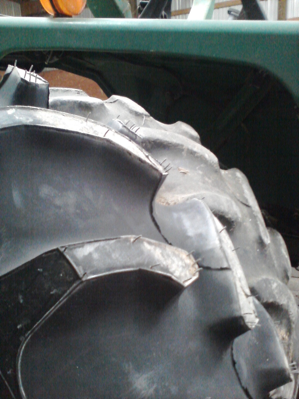

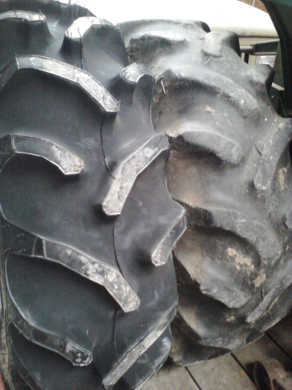

My new rears showed up today... I'm thinking that once I get them mounted, I'll notice a bit of an improvement in traction. :thumbsup:

I knew the old rear Goodyear's were worn... but I really had no idea how worn they were until I stood a new one up next to the old one. There's a good 1" to 1-1/4" difference in the tread depth. I ought to be able to really dig a hole if I spin a tire now.:laughing: I'm going to try to get the old tires dismounted this weekend and the wheels cleaned up and painted so I can drop the wheels/tires off on Monday to have the new tires mounted and filled with RimGuard. But I am also working on rebuilding a finish mower deck this weekend and may not have time to do both.

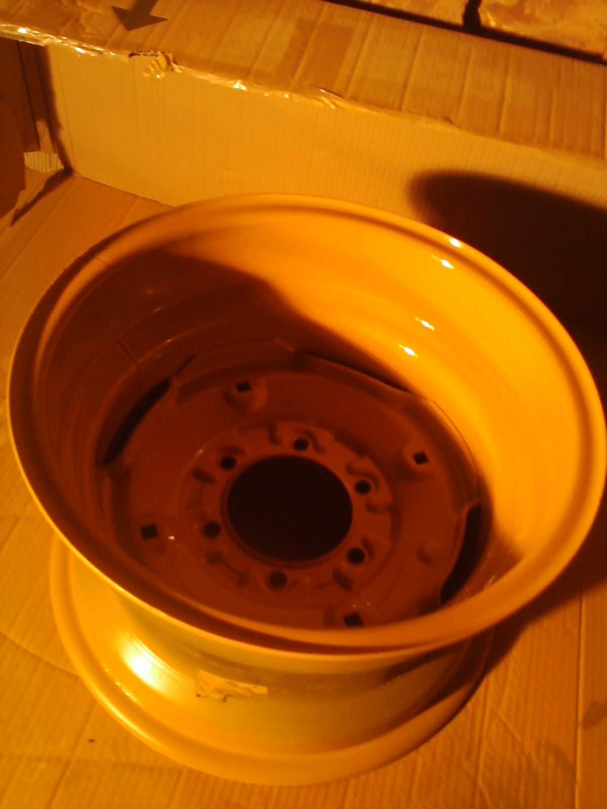

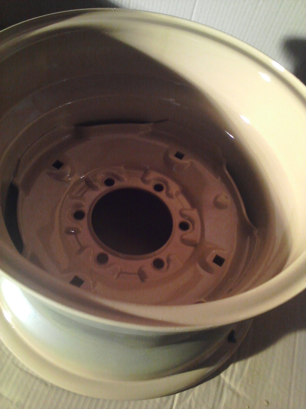

Since it's getting colder and the R4's I'm currently using are filled with straight water, I decided the finish mower deck can wait. Dismounted the old R1's a got the wheels all cleaned up. I even managed to get them in primer. I used a flat yellow primer I got from the farm store. Here's a couple crappy cell phone pictures with even crappier lighting. The first one is a "normal" shot and second one is with the white balance adjusted a little bit. They're still glossy in the pics because the primer is still wet.
Tomorrow, I'm going to get at least one side of them painted with JD Gloss Yellow with catalyst/hardner. If they dry in time for me to flip them over, I'll get the other side painted too. If not, I shoot the other side on Monday.

Thanks. Well the paint will be JD Yellow, but it's not coming from Deere. I'm sick to death of overpaying for stuff simply because JD put their label or part number on it. Whenever I can source something elsewhere, I compare prices and go the most economical route. Sometimes Deere wins out.... sometimes they don't.
I'm using Van Sickle Tractor & Implement oil-based enamel paint with the catalyst/hardner additive. I had to go a local autobody paint supplier to get the correct respirator for the nasty isocyanates in the hardner.
