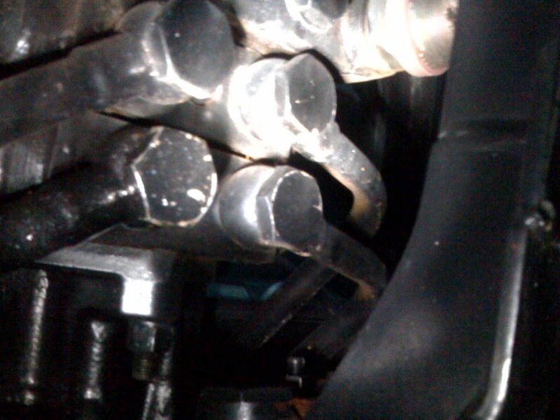

Ws using the TN today and noticed a puddle of oil under it when I moved it. It appears that it i scoming from the PTO area. I can not see well because I need to drop the PTO back hoe to see better. Does anybody know how much of a deal it is to replace the seal on the PTO?

Dont know, but probably it isnt that. Probably from the BH PTO accouterments. Give it a wash then run it and watch it.

Actually easier than that. One of those pesky bolts holding the rigid lines from the rear remotes to the loader which seemed tight wasn't tight enough. A quick wrench and voila, no more leak.
See picture, Bolt lower left is the one leaking and I do mean leaking.
