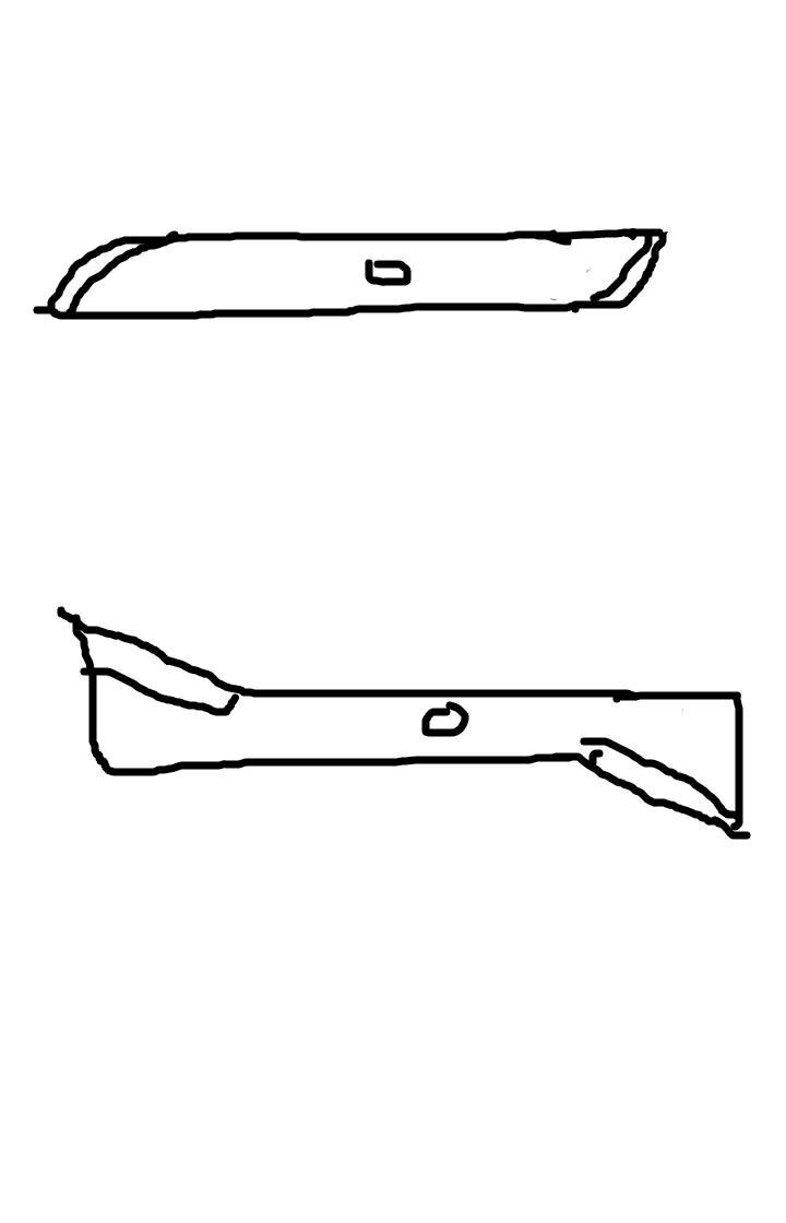

As a kid my Grandad and Dad would sharpen blades on a bench grinder until they looked like the top one in drawing. Then I realized that had to me wrong because as the blade spins the tip is what cuts first and most.
I always thought blades should be made like the bottom drawing. They could be sharpened a lot more. That's why I like the sandpaper pad grinder. You want it sharp but not remove much metal. mower%20blades.jpeg

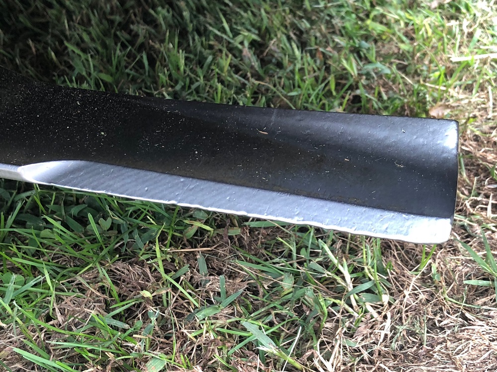

Here's one of mine this one has 3 summers worth of grass cutting. I don't have a wheel grinder and i'm not sure how hard it would be to get them balanced. They are $15 each new and a cheap wheel grinder is around $50 so buying 3 blades would cover a wheel grinder plus a balance tool.
Wow those look like new! Mine get worn pretty thin after one season...we have sandy soil and it kicks up tons of dust and the blades get sandblasted. I wish I could get more than one season out of mine.
I always thought blades should be made like the bottom drawing. They could be sharpened a lot more. That's why I like the sandpaper pad grinder. You want it sharp but not remove much metal.View attachment 572076
That’s the same thing my grandpa did. Cut quality goes to crap with blades like that. If you care at all about the cut quality blades like that need replaced.
