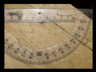

Here's a pic of a simple inclinometer I made to measure the hill I mow.Just a scrap of plywood about 12in tall and 3ft or so to approximate the wheelbase length of the tractor.Then a pencil line parallel to the bottom edge,and a brad to make the pivot for the protractor.Maybe you could whip up something like this to get an exact measurement on that hill.Angles are tough to determine with photographs.
In this video the downhill run is right at 30deg.The tractor will go about 2/3 up that run before it stalls.The run is 16ft.The uphill runs in the video are between 25 up to 30 deg,but shorter.Seems about 10-12ft @ 30deg is when the hydro gives up due to torque multiplication deficiency and forward momentum depletion.Maybe they intentionally designed it this way for safety reasons.I'd love to try out a 4X4 Simplicity or John Deere to compare.
Probably not too late to trade for a BX if you could live with the much larger turning radius and front end push when it's in 4-whl drive.

Hey, THANK YOU SO MUCH. I really appreciate you taking the time to do that. I'll show that to my dealer also.
I told you about 40 degrees. I went out and did a couple of checks. The long slope is 32 degrees and the short one nearest the camera is 37 degrees.
You make me feel better. Your the only one I know that I can compare my experience with. Looks like your's and mine are about the same. I was thinking about changing the transmission fluid to the synthetic. Mine seems to slip more when it gets warm, and I thought the synthetic might hold it's viscosity better.
I was a machinist and used a long level and protractor I had from the old days to check the angle. That was the steepest part. The rest of the hill is shorter and not so steep.
