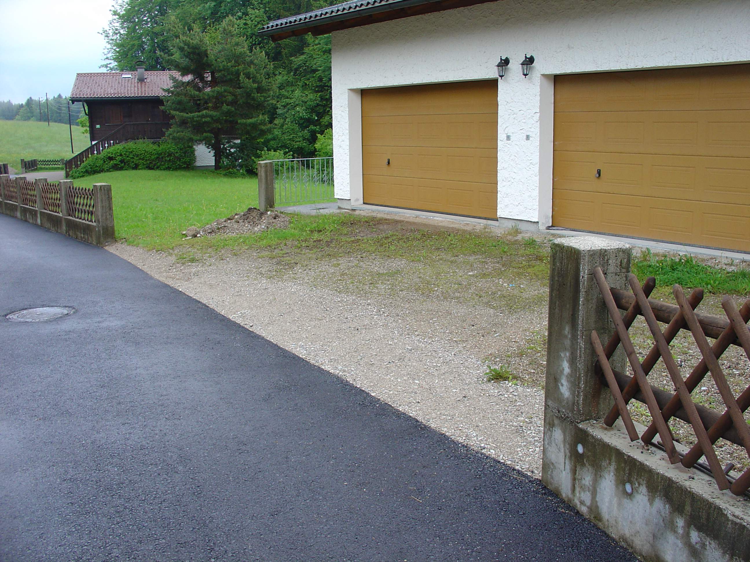

Are you going to park three cars in those three garage doors? 9ft doors are super cheap, ten foot doors jump in price. I've never heard of or seen a 9ft 6inch door, so that must mean they are being custom built. To me, that's just a waste of money.
That must be the ro Eddie cuz I'm sure the doors are 9'w
There really is no room to open a door once you have three cars in there.

36x48 to gain a little width for 3 garage doors? (It's easier to spend other's money)
My first thought was if it is possible to rotate the garage 90 degrees and so you could have three 12' doors on your 42' wide wall?
The minimum here for sheer was 18" between doors and now it is 24"
I own a nice home but is has three 8' wide doors... it sure does limit and make it tight unless you drive small cars... the previous owner had a Mini and a Miata and BMW... they fit OK... but two were only 2 seat cars.

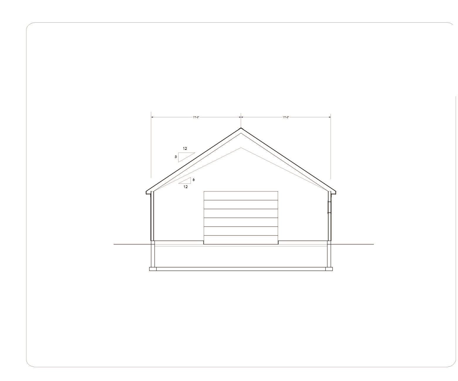

1) What type of truss do you have in mind to allow that tall of rear door??? It does not look doable.
2) Do you really need two man/walk doors? I would eliminate the rear one.
3) Depending on your plans for stall 3, you might want the side door further back, so you can walk across the front of any vehicle parked there. OR further forward, all the way to front corner, so you can walk behind anything parked there (just leave room to pull forward at least 3')
Very first thing I thought of.

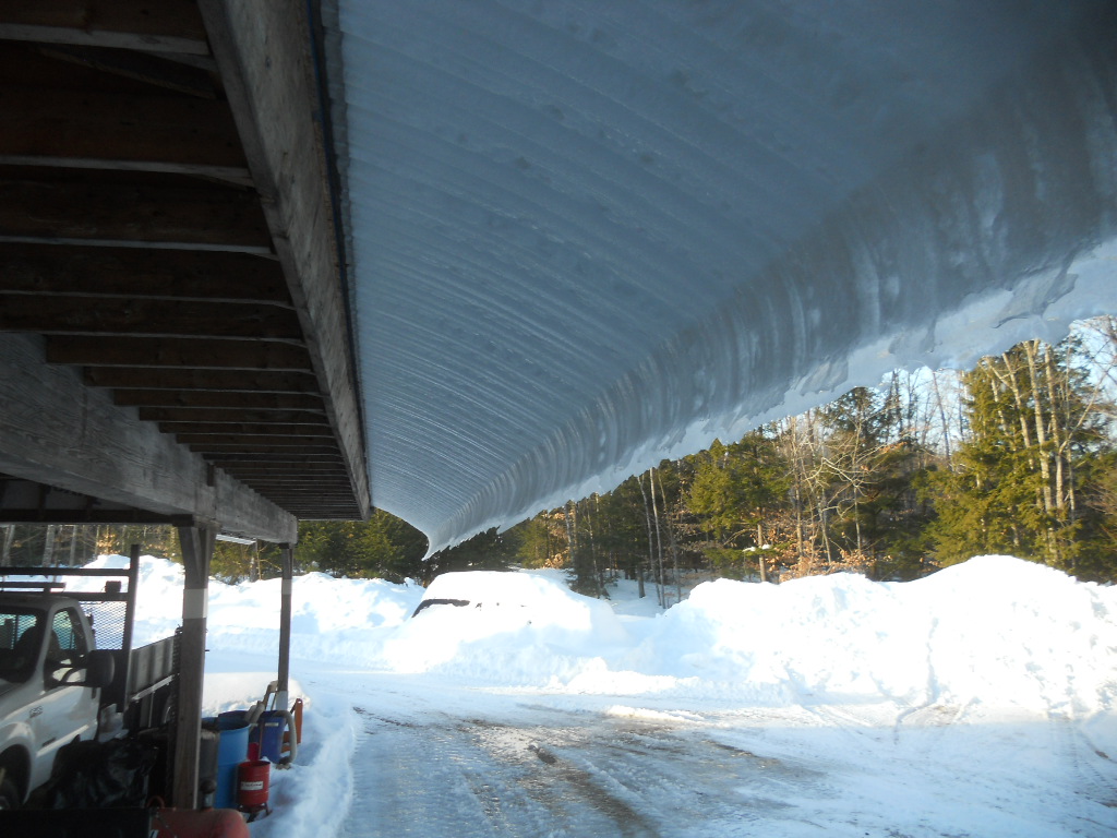

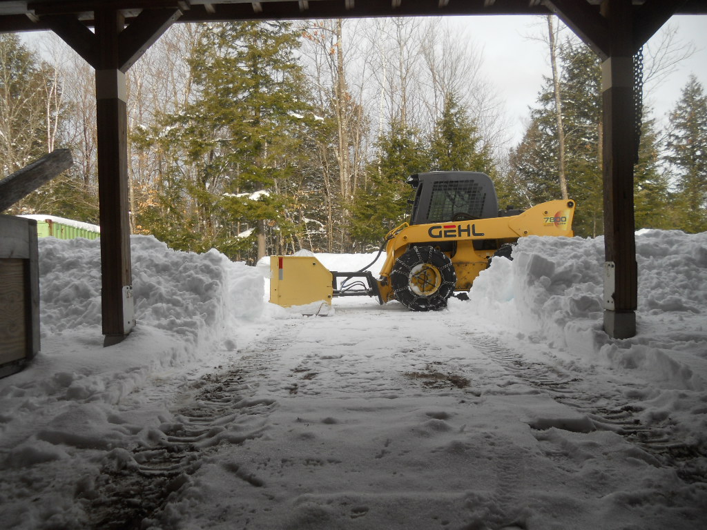

In snow country it's best to put your doors on the gable end if possible. Here's why;
This is what you get after you've plowed when the roof decides to shed it's snow.:laughing:
   / New garage and home build #18
Makes sense... "Almost" nothing I own is in snow country but of the two... one has a gable door to the rear of the property with distance being a problem and the other has doors on the side but the prevailing weather keep the snow at bay on the that side...

Here's the roof cut away. I assume they are trusses but I'm no builder.
Compare this picture with you first picture of the rear. Notice where the top of door comes in relationship to the bottom edge of the roof. VERY different.
