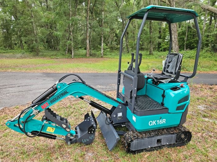

Yesterday I picked up a new QR16K AGT 15-horse gas excavator. For $5K, there was no way to resist. I should be able to get rid of it with a minimal loss if I don't like it.
I have questions, of course.
1. People are saying I should change the hydraulic fluid because the Chinese put everything from Crisco to Vitalis in there. Okay, I bought fluid from Tractor Supply. But they also say I should wash out the tank with detergent and/or use a magnet to get rid of metal particles. My question: what do I care about metal particles if I have a filter between the tank and the pump? How are particles going to pass the filter?
2. Does anyone know if this machine has a second filter hiding in the back somewhere? I haven't found one yet.
3. The machine was making kind of a roaring noise yesterday when I did certain things and gave it a lot of juice. Anyone else have this issue? Wondering if the sheet metal just likes to vibrate at certain frequencies.
4. The jerkiness issue is real. It only applies to the tracks. Some dude on the web claims the Chinese don't make much effort to set the hydraulic pressure, and this causes the jerking. Apparently, the pump likes a slow diesel, and gas engines turn too fast. Has anyone here checked and adjusted their pressure? It looks easy on the web, but I can't tell exactly which gauge and fitting to buy.
5. It seems to me that I could reduce the jerking a lot by making two longer track levers. The longer the lever is, the farther you have to push it to get the same response. Has anyone here tried this?
6. Some people say there is no need to run the excavator at top RPM, and that slowing the engine down reduces the jerking. Plausible? Can anyone suggest a target RPM? I would guess low RPM's wouldn't cause overheating in an air-cooled engine, but then I don't know anything.
The hydraulic fluid was a little low when I got the machine, and I could swear topping it off reduced the jerking a little, but I don't know how that could be possible.

I would hesitate to use any type of detergent unless you are 100% certain that you remove all of it from the reservoir or it may dilute the new oil.
A typical inlet filter is 20 micron or coarser so the finer particles will pass on thru. If it is a screen potentially even coarser.
Was roaring potentially the pump cavitating? This can sound like a rock crusher.
Pressure shouldn’t make the system jerky. Poor metering valves or air in system can and will cause jerkiness.
If the track drive motors have counterbalance or overrunning load control valves these can cause jerkiness if set incorrectly
If pump was cavitating if would potentially cause jerky movement

I don't know what it sounds like when a hydraulic pump cavitates. I would say the system was something like a quart and a half low. I will see if it makes noise tomorrow.
I don't know how to put a second filter on the system. I'll have to find out and see if it's practical. I haven't even found the engine oil filter yet. It was boiling hot when I was fooling with the excavator today, and I didn't feel like spending a lot of time with it.
It is normal for these cheap machines to be jerky, but the impression I get from reading up is that various things can make it worse.
I don't know much of anything about pilot controls, but I don't think this machine has them.
Just for the heck of it, I'm going to put long PVC pipes over the track levers to lengthen them, and I'll see if it improves my control.
   / New AGT Midget Excavator: 6 Questions Including Jerky Control Stuff #10
No engine oil filter on the Rato engine. And the QK16R doesn't have pilot controls which are the digging controls next to the seat.
The main boom is the only this that is jerky on my LS15R, It will start out jerky when cold going up and down, and then seems to smooth out until about the 3-3.5 hour mark and then it will about throw you out of the seat. Just gets really touchy. The rest of the controls are actually rather smooth considering.
