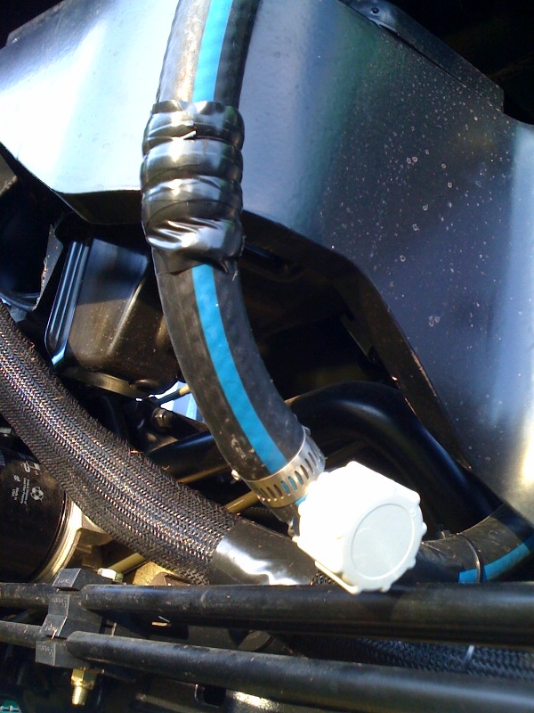

Check your heater hoses where they go up into the cab frame, and where they cross the metal supports for the cab and loader frame. Mine were rubbing on the frame. I added some spiral wrap to protect them.

Thanks for the info Pete. I will give the lube a try. I will also address the hose issue, thanks for the heads up. As for the shifter I guess I will just have to get used to it. If I come up with a fix I will post it.
