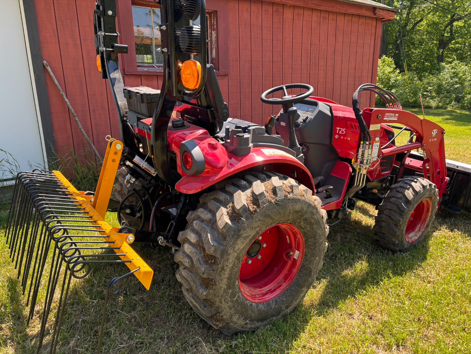

That’s what I liked about my T25. More of a medium-sub compact with beefy tires. No lawn tractor tires here.

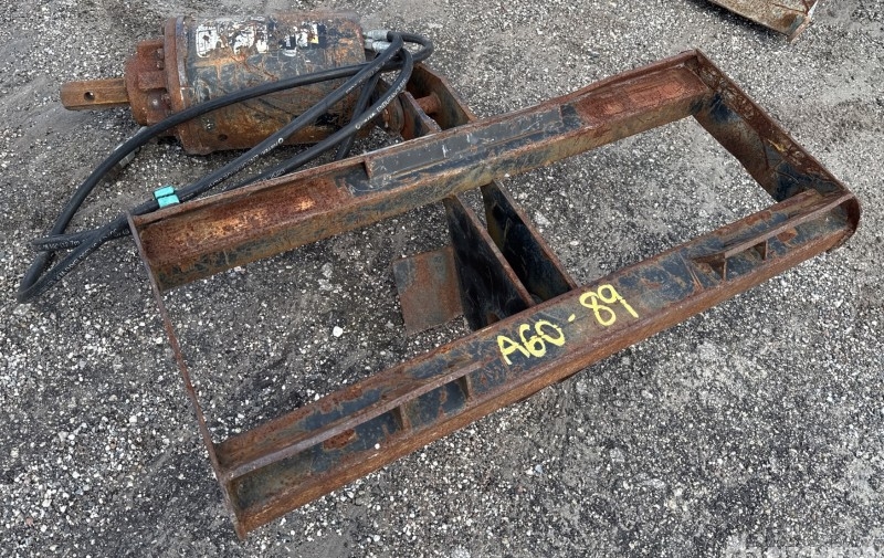

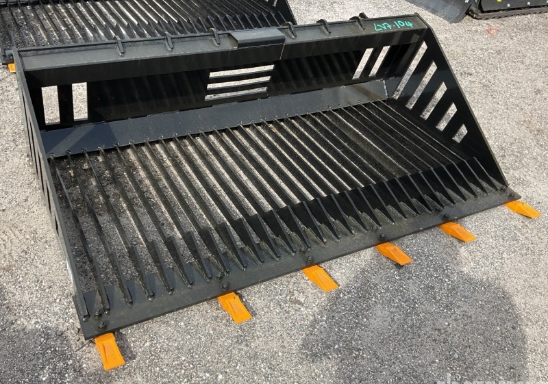

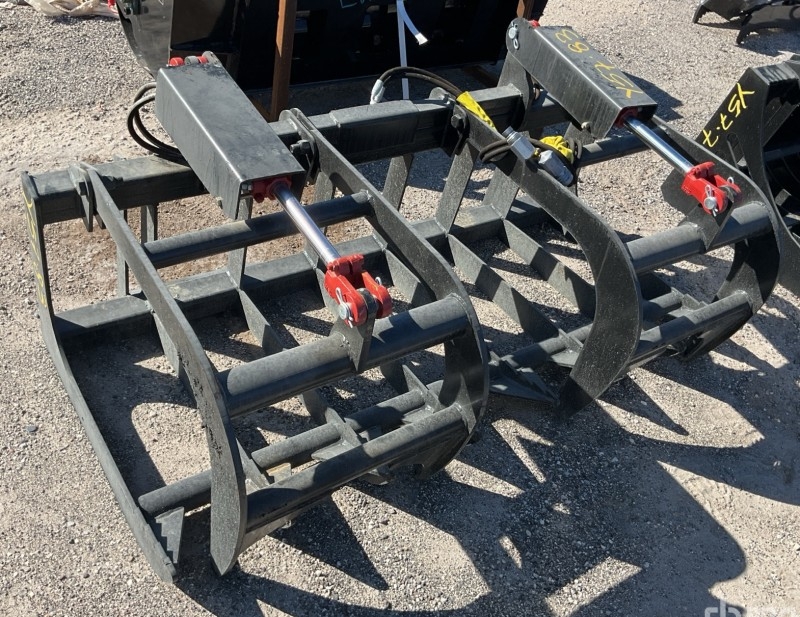

Haven't take delivery yet, but I made a deal on the CK2620H. I will certainly post pics. I did have winning bids on several attachements at RB auction as well, here's some picts of those. Of course I'll need to buy or make a SS adapter plate for the mini attachements. I'm also not sure there will be enough hydro flow for the auger. I might get the mid pto and run a second pump from it.

Those "rock buckets" ive seen at Weeks several times, I think branded Wolverine or something. They have kinda interested me, not for rock, but for getting light trash (roots, sticks, bottles, cans, ect) from piles, and also demucking.
