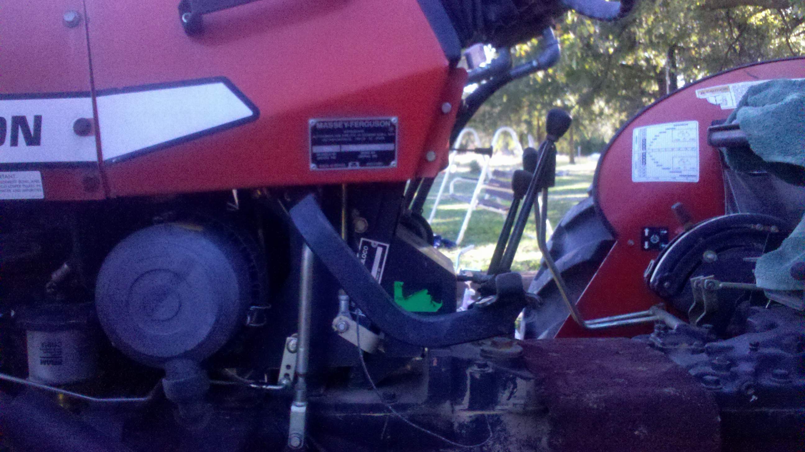

When he brought it back, the clutch pedal was 6" higher than when he took it. What happened and how do I fix it?

Welcome to the forum. Do you see any linkages attached to it bent up or replaced. Or is the seat moved ahead and the different possision of the reference point deciving you that the pedal is further out.

Here's a pic of the clutch position. I've travelled all week and this is the first opportunity I've gotten to send it. 2012-10-20_17-11-01_172.jpg
/ Neighbor borrowed my MF 451
The linkage looks fine and the seat has not been moved (I'm reupholstering it). I guess I'll adjust that linkage and see if the pedal will move back down to the normal position, knowing that I'm looking at a clutch replacement soon. I guess the tractor has to be split to replace the clutch?2012-10-20_17-11-01_172.jpg

I was having a bad day yesterday so I wasn't as helpful as I fould have been. Have you looked at the online parts manual for your MF? For me I've found a lot of times I can get a good feel for how a system is supposed to be if I can study the parts illustration.
I still can't visualise how he did that to the pedal unless he snagged it on something. Does the clutch pedal still work ok, or is it stiff now?
I would guess that he adjusted the linkage and that it can be adjusted back down.

Most likely a travel stop bumper has become dislodged. How much free pedal does it have?

The linkage looks fine and the seat has not been moved (I'm reupholstering it). I guess I'll adjust that linkage and see if the pedal will move back down to the normal position, knowing that I'm looking at a clutch replacement soon. I guess the tractor has to be split to replace the clutch?<img src="http://www.tractorbynet.com/forums/attachment.php?attachmentid=285570"/>
Is it possible that it got bent upwards from something striking it from below? The arch in the pedal seems extreme to me with the pedal platform pitched toward the motor more than the tractor seat. There is a little color change in to photo but that could be dirt or fading but could also be from some different paint after trying to straightening with a torch. Find someone with the same tractor to send you a picture of that pedal from the same angle.

Hopefully you have it repaired by now. Mine, showing clutch pedal normal position. Check clutch adjustment setting in operators manual.
