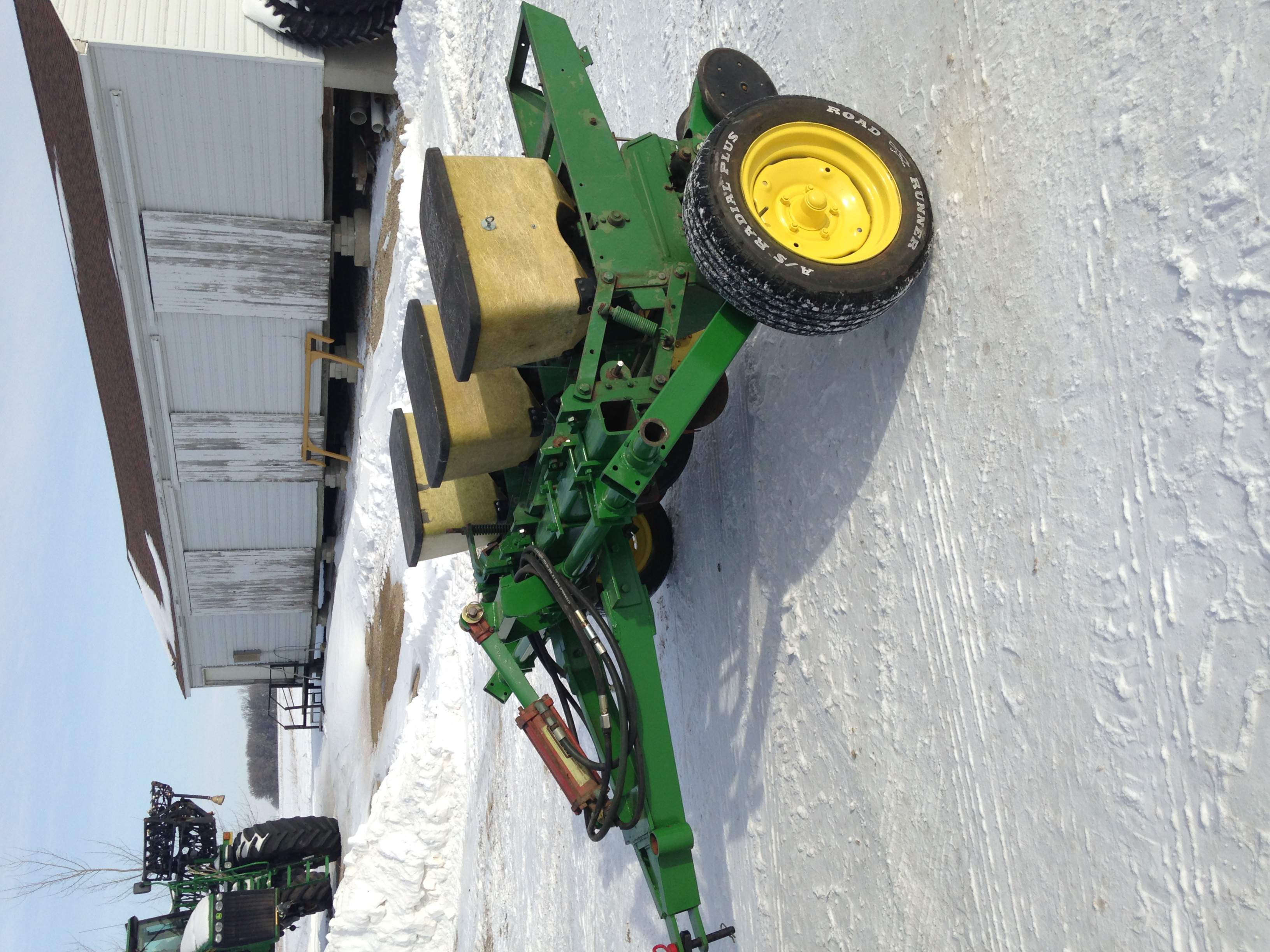

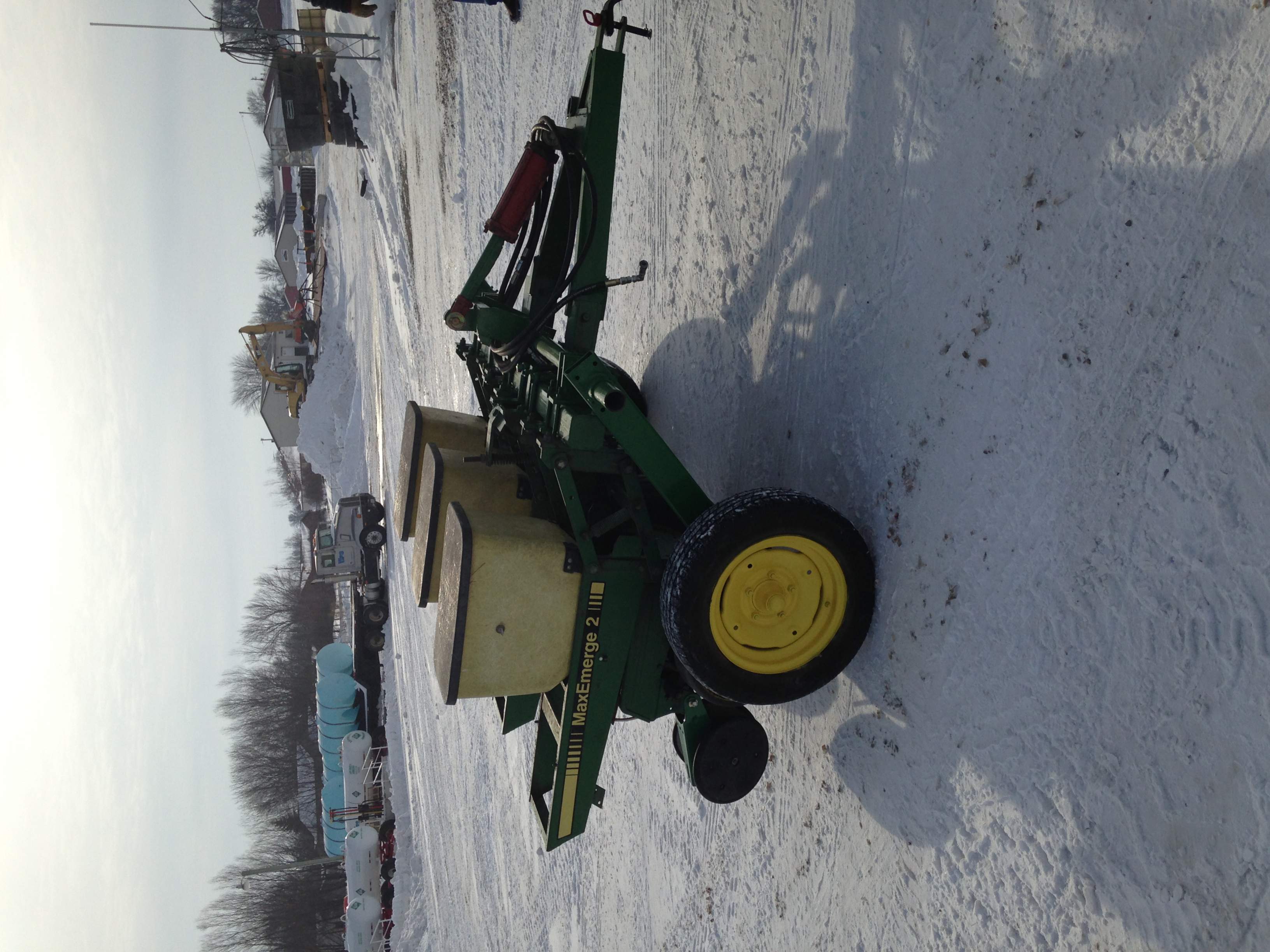

Need to talk with Kenny Pullit and Willy Pullit. Built this planter to pull behind my BX 2350 with R-1 tires and I am questioning if it will work. What`s your opinions? First time posting pics so be patient if it doesn`t work please.

Crud- how do I get pictures to rotate 90 degrees? Also- running a 15 gallon starter fertilizer tank in loader bucket for extra weight and will drag marker chain off of bucket for the marker system.

Can't tell if the planter is ground engaging. If it is, it looks to me to be a bit much for a bx. If it's just a drop spreader, I don't see why the bx couldn't pull it.
   / Need to talk with two guys #6
Three rows, with disk openers ? No problem. a grassland manure injector has 25 of these disks with an opener behind it, i used to pull one with 2hp per coulter, and 10m3 of manure in the tank... If your tractor weighs 1000kg it will pull it.
