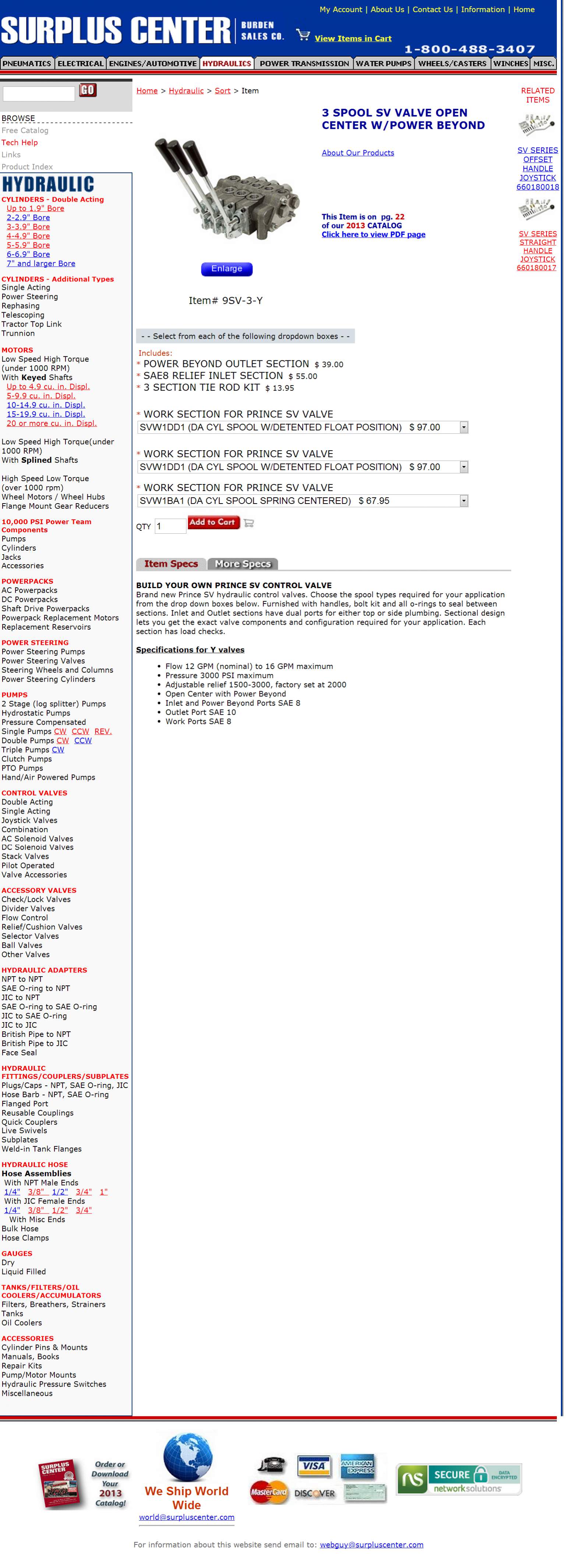

Need to order remote kit for my M9000 2005 Kubota tractor. I have one remote and am wanting to put another one on the tractor. Where is the best place to order this? Do you just call it the remote kit? Do I need anything else? What is the anticipated cost?

A do it yourself kit will be cheaper but won't fit as smoothly/easily. Do you anticipate requiring a "float position" on the added remote kit? It's my understanding that non of Kubota's 1st remote kit's have a "float position". I think a Kubota 2nd remote kit is in the $800-$900 range.
   / Need to order Hydraulic Remote Kit for Kubota M9000 #5
Here is a Surplus Center three spool stacked valve to get you stated.
$369.90
Add hoses, QD's, and mounting bracket.

My suggestion is to get the OEM price for the 2nd rear remote. Then you will feel good about any of the ways that you can go with aftermarket stuff. I suggest a diverter setup and use the single OEM rear remote to feed those. Have done this many times and most everyone has been happy with the results. :thumbsup:
