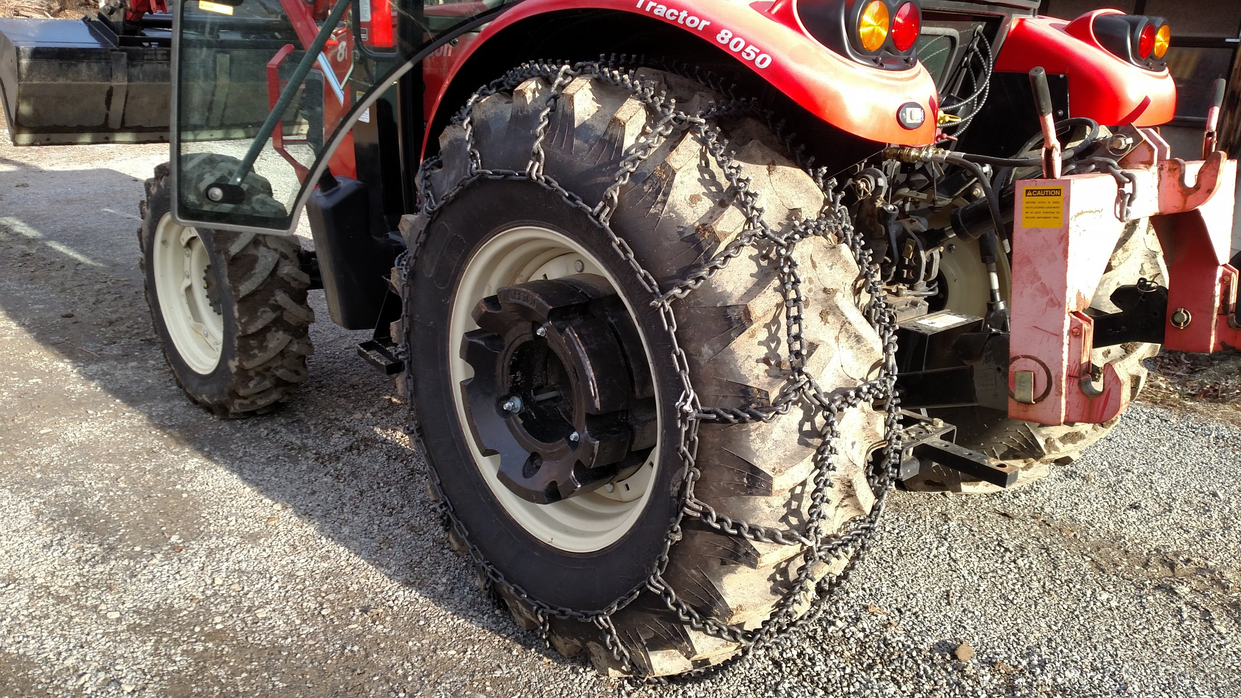

Mine are designed to run loose,
they have jusr been put on and the side chains adjusted evenly and that's it, no binders, no straps, no playing around with the tire pressure
after they get run for a few hundred feet there will be some slack chain sitting on the ground in front of the tire.
Lou, those are sure nice chains. I can see how far the sides come down. No way those chains can "walk off" the tires. And I would say that the way the sides fit are the key. They don't need bungees or springs.
Also look how the entire center of the chain cannot drop down into the lugs. It has to sit on top of the lugs where it gives the best traction to the snow.
His aren't the only way, I personally like an X pattern in the middle rungs instead of a ladder style like Lou has, but that is splitting hairs. Either center pattern will work fine when the sides of the chains fit as well as these.
BTW. the only way I've ever gotten chains to fit that well is to start with a good set of chains and then modify them until they are right. I've never been able to find a set of ready made chains that were right.

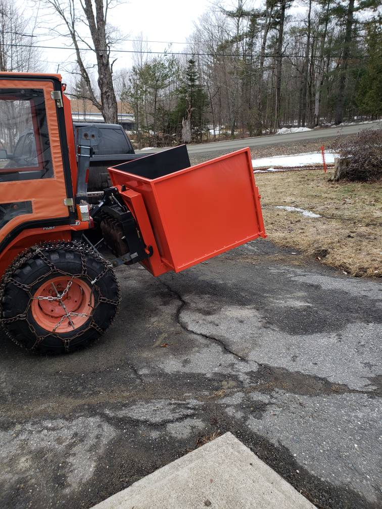

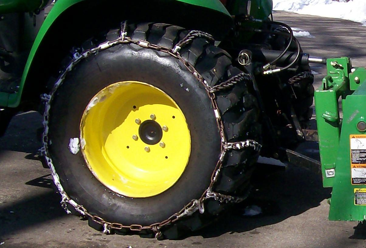

I cut my chains to fit like many have posted, align on tires, then I made my own tensioner out of short chains with hooks on the ends and threaded rod through the center of each chain. Zoom in on tire. My chains stay tight for months, long winters in maine. Easy and cheap to make/use.

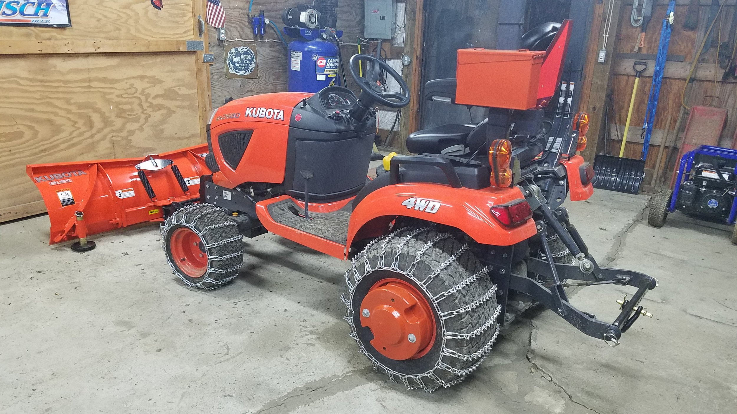

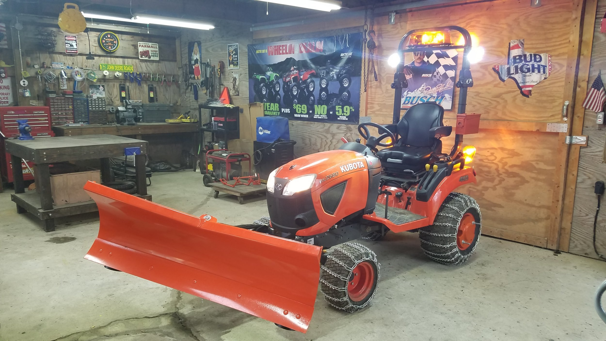

I have used tensioners before on a bigger tractor, but for my BX2680 I don't need them.

I cut my chains to fit like many have posted, align on tires, then I made my own tensioner out of short chains with hooks on the ends and threaded rod through the center of each chain. Zoom in on tire. My chains stay tight for months, long winters in maine. Easy and cheap to make/use. View attachment 718222
Have to disagree that these chains "fit" the tire. Side chains shown are a few links too long for a good fit, and shows the extra slack, but agree they are clever tensioners. just sayin..
