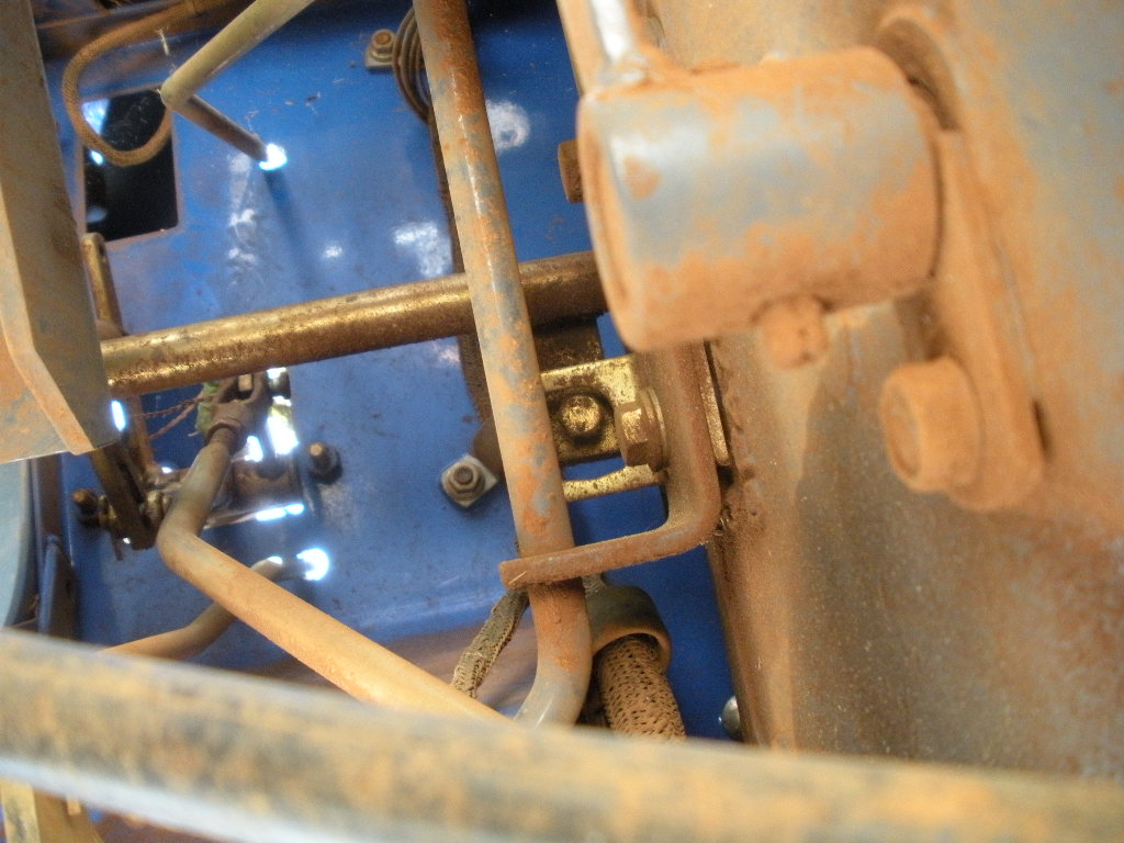

I got my TC40DA used a few months ago. The pto safety switch has been shorted/bypassed, and is just dangling. Found that out crawling around underneath greasing zerks.
Can someone post a picture of the switch in it's proper place and position?
I would just leave it; I do not like "Mr Safety". But, my soon to be 16 year old son drives the tractor too. I need him to mow at my parents next week. He is very responsible on the tractor. But, for him, I would like ALL the safety devices to be operational.

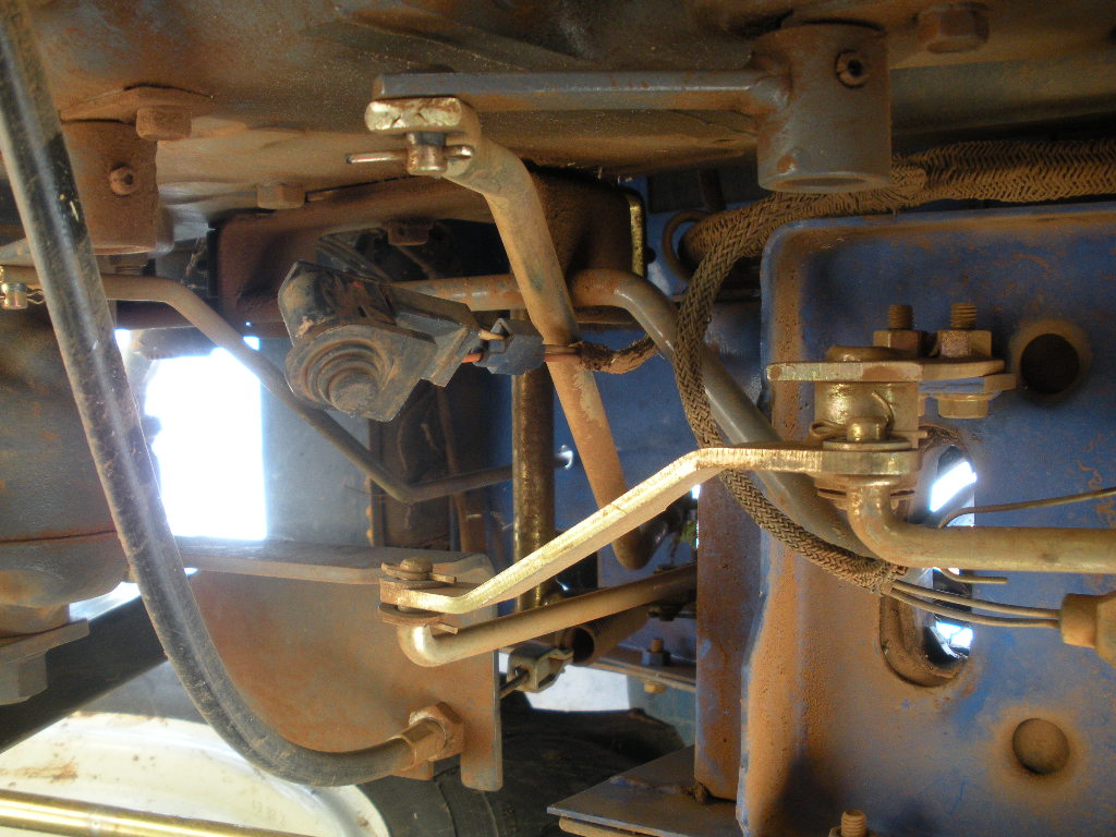

Here are pictures of the switch, and maybe where it came from. This is looking up, near the inside front of the left rear tire.
I did not try starting it with the PTO in the engaged position; will be back out there in a little bit and try it.
Are you sure it is the PTO safety switch?

Yes, it will start with the PTO lever engaged. Exactly what I do not want for when my son operates it.

I am not 100% sure since I am not at my tractor so I can visually confirm, but I believe the switch goes into this holder. You should test the switch - it is a single pole switch that is open when the plunger is out, and closed when the plunger is pushed in when contacted by the hex head in the small black square outlined in the picture.

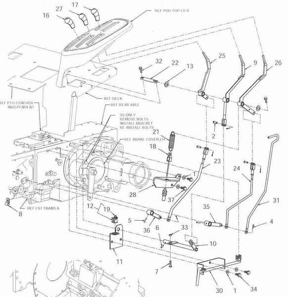

Robert, I was about to give up on finding a better illustration or picture of the PTO switch and lever mechanism that Chris posted when I stumbled onto the attached drawing of the levers and how they all mount. In the attached diagram, item 12 is the pto switch and it mounts into item 11, a bracket on the side of the rear transmission housing. Item 10 is a rotating shaft that mounts through a hole in the PTO switch mounting plate and the opposite end attaches to the PTO lever. It has a finger that sticks out with an adjustable bolt (items 7/33) that is adjusted so the PTO light comes on when the lever is moved to the engage position. By following all the assembly lines, you should be able to see just how and where the switch mounts. If you remove your left-rear tire, the job of reinstalling the switch should be a snap. I don't have a picture, but this should help.
