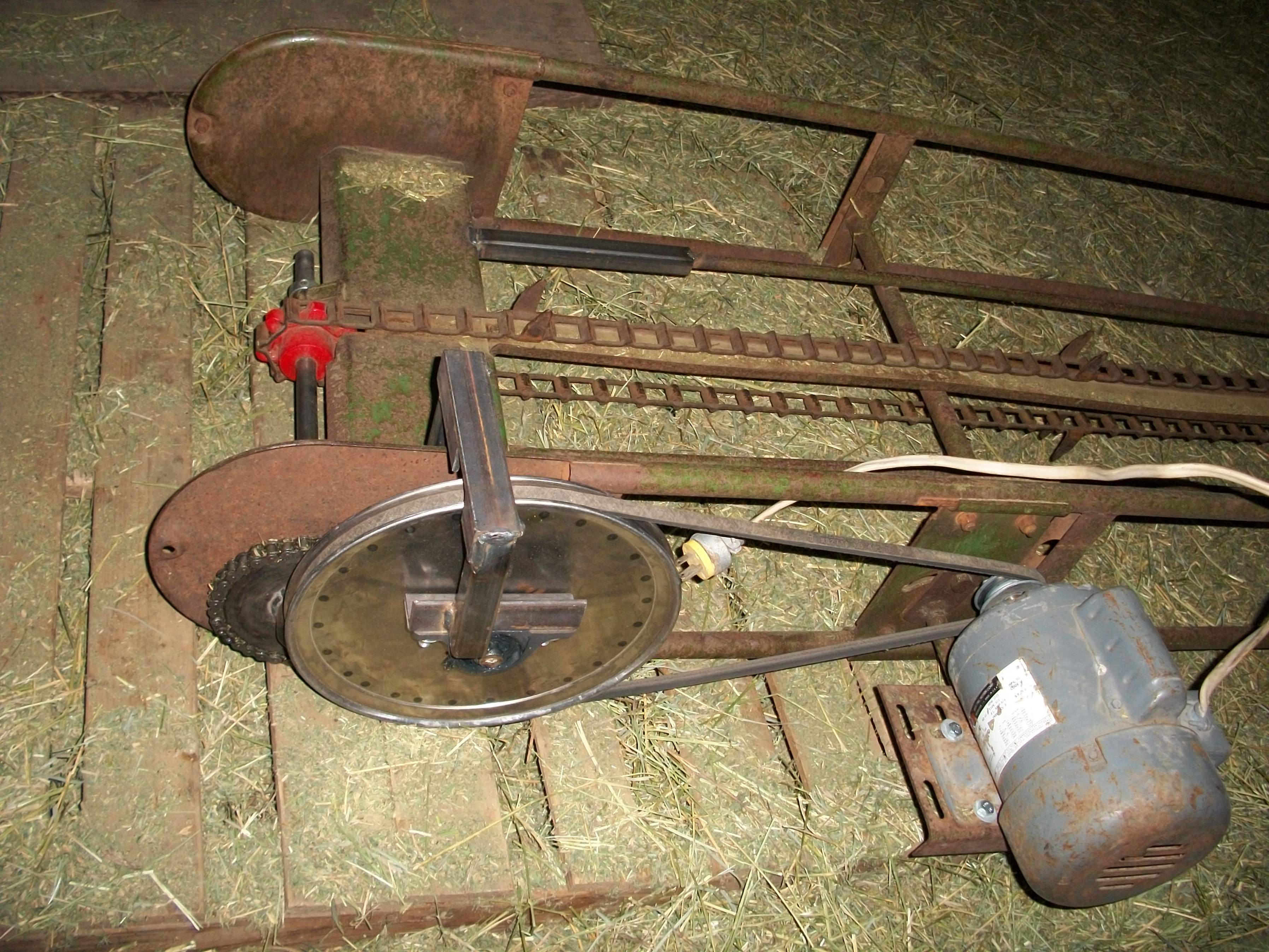

#20
Here is what I ended up with. I found a 1/2 HP electric motor with a pulley on it for $20. I used a 12" weld-a-pulley, they were way cheaper then a cast pulley plus I able to use my Miller 211 MIG welder on it. I found an old belt hanging up in my barn and used it.
Behind the 12" pulley I used a 3" 40 chain sprocket and connected that with a 6" 40 chain sprocket.
