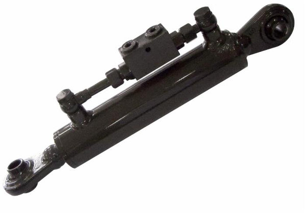

This is the one I got:
It's cat 1 only, but the majority of my implements are cat 1. If my implements are cat 2, I use bushings, and they are cat 1. The measurements are close to your stock manual toplink. The little bit shorter is not an issue. You shouldnt have your top link that far out anyway.
You will also need a hose kit:
Hydraulic Hose Kit with 1/2" Ball Type Couplers
And you need to watch my video on the subject:
You won't be disappointed with a hydraulic toplink.

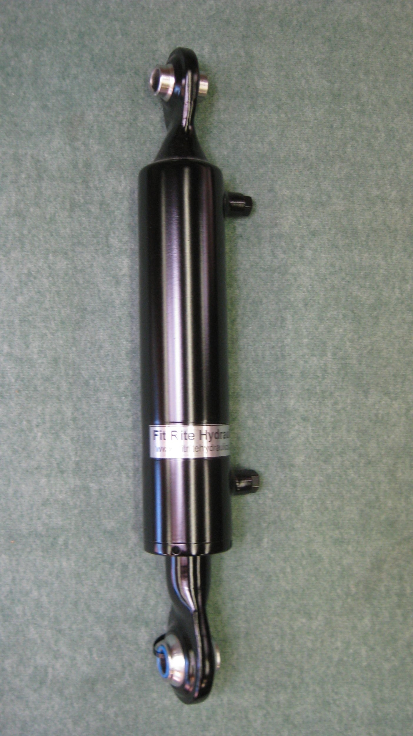

I can provide you a cat 1-2 top link built with a 2 1/2" dia cylinder with a 1 1/2" dia rod with a 19 1/4"- 27 1/4" working length. This has a cat 1 tractor end and a narrow (1 3/4") cat 2 rod end with a floating cat 1 reducer bushing.
Unfortunately, I am currently backed up a minimum of 22 weeks. This is not anything special, in fact actually common. Fill out the Fit Rite contact page if you decide you can wait to get a top link kit that actually fits right.
Thanks for the reply.
I actually visited your site and would be love to order from you, but I am needing it sooner. I need to build a road this summer and want the top link before I start working on rear blade work. Especially since I am a beginner just learning to use the implement. I am sure that, without the hyd top link, I would spend 10x as much time off the tractor making adjustements as an experienced operator might.

I agree, time can be a VERY big factor, just letting you know that the unit you need is not anything special for some (me) companies.

If my current hose is not ball type couplers, can I purchase a new hose with ball couplers, or should I stay with normal couplers? Are they interchangeable?
   / Need help finding a Hydraulic Top Link for my MT352 #8
Ball couplers & poppet couplers are interchangeable. You have poppet couplers on your tractor.
