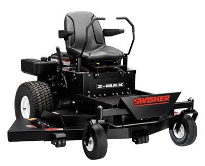

I had thought a little about a commercial mower (zero radius) as an option. This might actually do the mowing quicker than a tractor/bush hog set-up-you think?
I have a flat bed trailer I pull with a bumper hitch. I would like to pull that around the farm and pick up limbs, etc. Could I set-up the tractor to do that?

I have one of these, 60 inch Zero turn. It is by far much faster that anything else I have tried for mowing. These things can be a little hair raising on steep hills however. One of my properties has a house on top of a hill with a walk out basement on one side. The lawn slopes down very sharply on that side of the house, and about 1 acre of the 5 acre parcel has a slope of around 10 degrees. My basement floor is about 6 foot above the center of the road. The nature of the zero turns is they will "crab walk" if you try to mow side hill. It can be done but it isn't a lot of fun since they require constant steering correction to go in a straight line. They are much better going up hill. Down hill is O.K. but they tend to gather speed quickly and the steering gets a little vauge as the weight transfers off the drive wheels to the front casters. Mine isn't as fast as a true comercial mower, but the 26hp motor seems to be a good match for the 60" deck. My local farm supply store has one of these on clearance for $3400. If I didn't already have one I would buy it in a heartbeat. A lot of mower for the money. Nothing fancy but heavy gauge metal all around.
It also has a bumper that you can mount a hitch to to pull a trailer. It has very good traction because most of the weight is over the drive wheels and the dual hydrostatic drives gives it a great amount of power for pulling a heavy load.

Interesting thought about pulling the trailer with the mower. I will research that further.

I forgot to answer your origional question about the tractor pulling a trailer, yes, most of them have a drawbar that you can attach the hitch ball to. The delux way is to mount the hitch on the 3 point so you don't even have to lift the trailer to connect it, just back under the trailer and raise the hitch.
