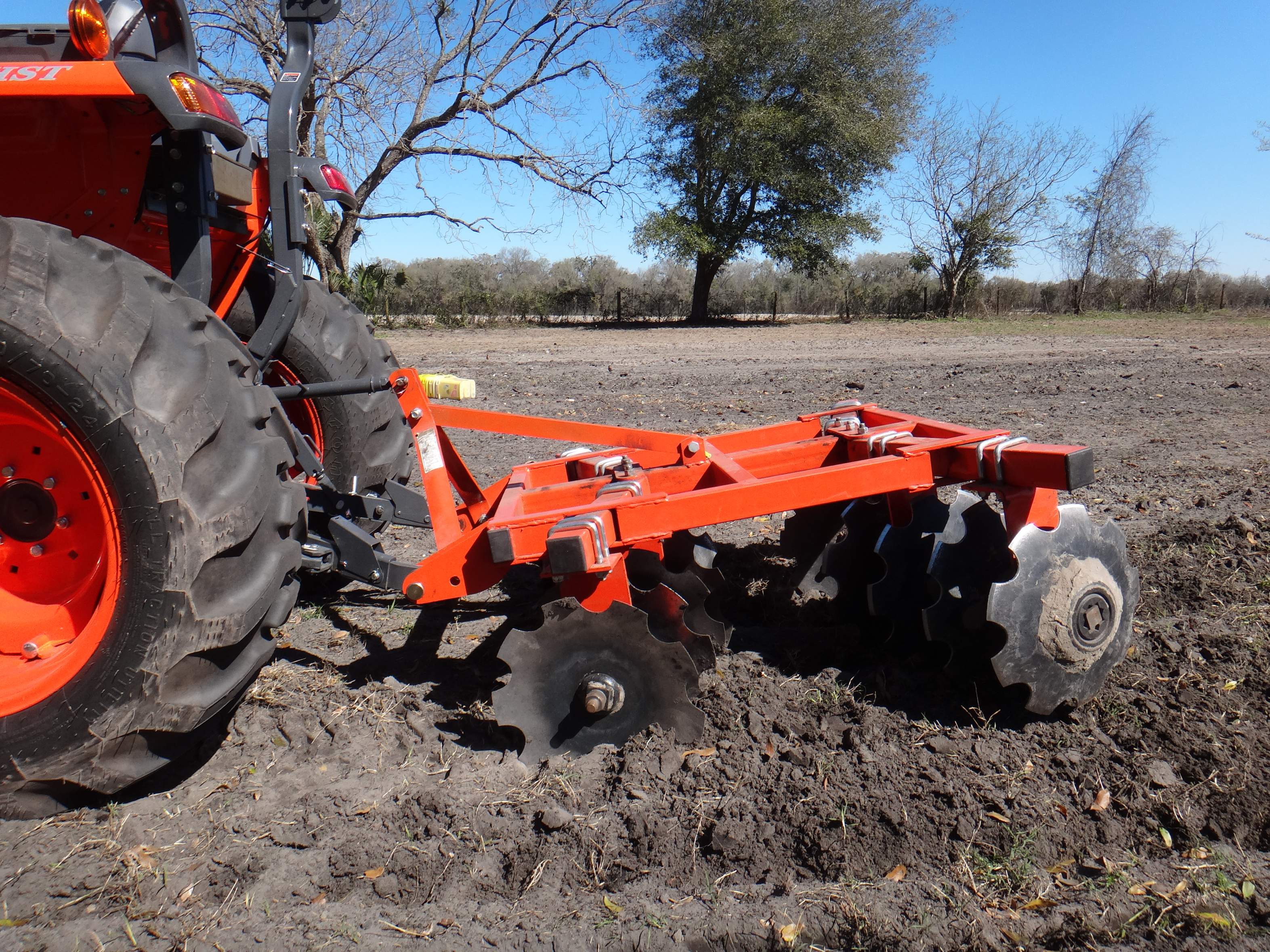

I own a Howse 6' like jeff9366 showed. I use a pin and lynch clip in the center to make changing the angle easier. Just lift it up and slide with a spud/crescent wrench I keep in the toolbox. I have 4 solid 1" rods 12" long welded on each corner of the frame for old steel barbell weights to stack on for up to 400# of extra weight when needed. It works great on the small fields and is easy to transport.

Shorten your Top Link until the rear gang is completely in the air, all the rear gang weight then transfers to front gang, improving penetration.
Howse DLHT 16/18"; 587 pounds, 37 pounds bearing on each pan, 74 pounds (+/-) bearing on each pan with Top Link shortened to lift rear gang off the ground.

You might consider the Howse DHT. Its their heaviest cutter and weighs in at 1100lbs for 7.5' cut. I have owned mine for years and it cuts very well. I also have the lighter one mentioned in the original post. It comes in around 800 lbs but doesn't do nearly as well as the DHT series.
