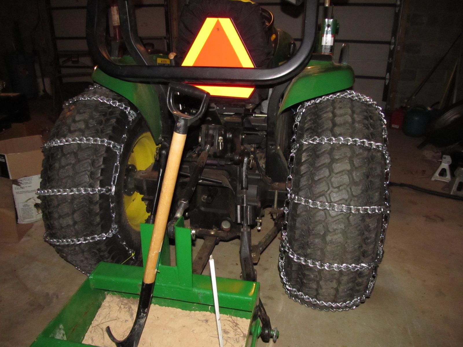

As I'd written in an earlier post, I gained a total of 4", give or take, reversing my turf tires. Most posts I've read on industrials indicate you won't see as much of a difference (on many Deere's, R-1's are mounted on wheels with multi-position rims, so no need to swap).
Pics show the difference before and after I reversed the tires.
