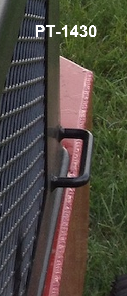

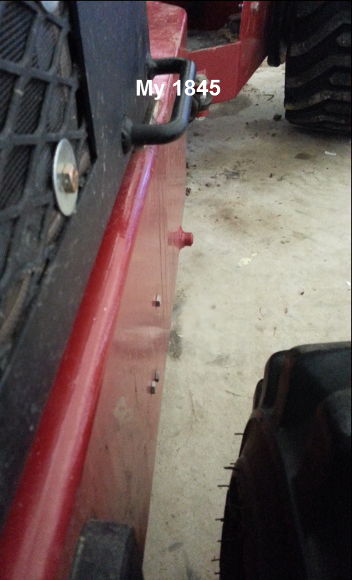

One other thing I noticed was the decline in fit and finish on the welds. On my tractor, most of the main joints are "grinded smooth." You can see an example of what I'm talking about below. There's no "shaping" of the weld anymore. It looks MUCH more home-made and "raw". It's not a big issue, just a surprise. I'm sure they save a lot of money with this approach. However, many of the welds look rough and a bit sloppy for my taste. As someone that knows the value of these machines, this would make little difference. However, for someone considering their first purchase and concerned about the lack of a dealer network and perhaps comparing this machine to a Kubota or similar traditional tractor, this could be a big turnoff.

In reality, cosmetically finishing the weld by grinding can make the joint weaker (and the bondo smoothing does nothing). I personally do not mind the "rough" look; if I wanted smooth plastic panels I would have bought a JD....
That being said, there have been some complaints where broken welds on the PT discussed here have shown evidence of inadequate root penetration.

The rounded area on my 1845 is not bondo. It's all metal. I know this because I stripped the paint off this area for repainting purposes with a scrapper. Still...I agree that it's cosmetic only.
