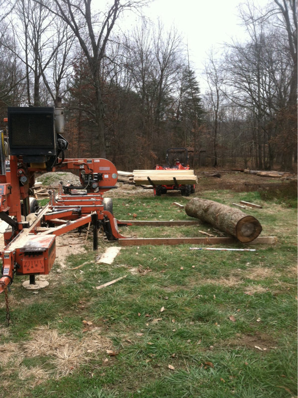

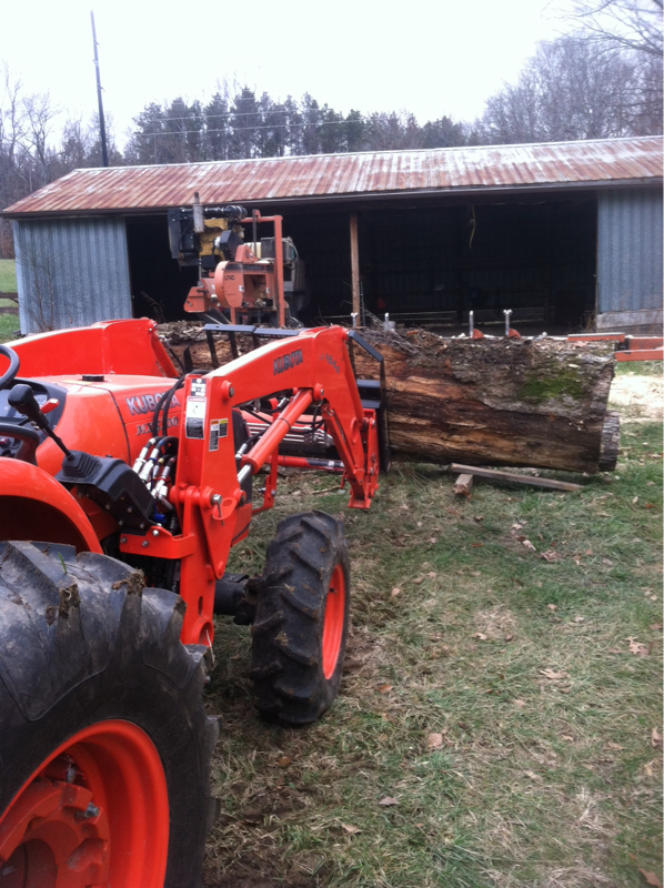

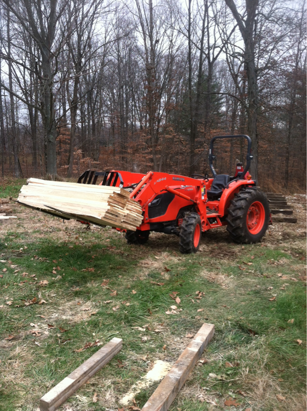

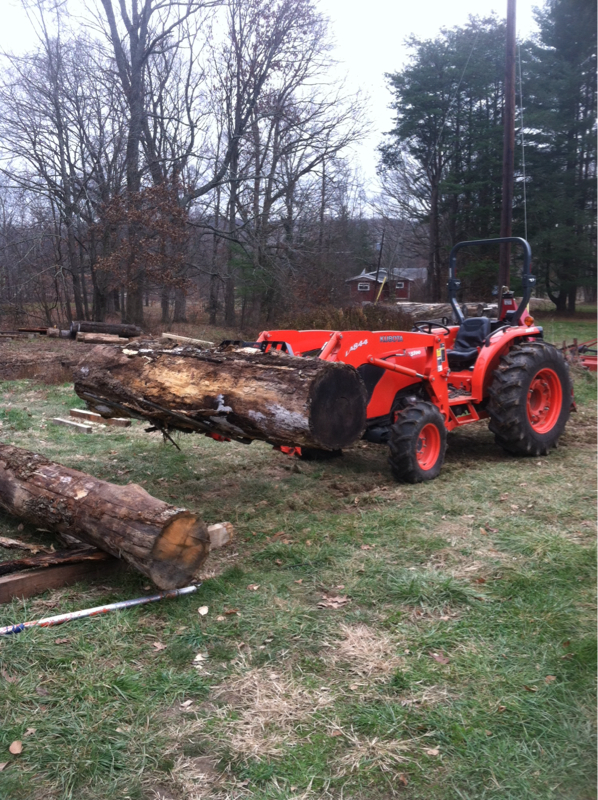

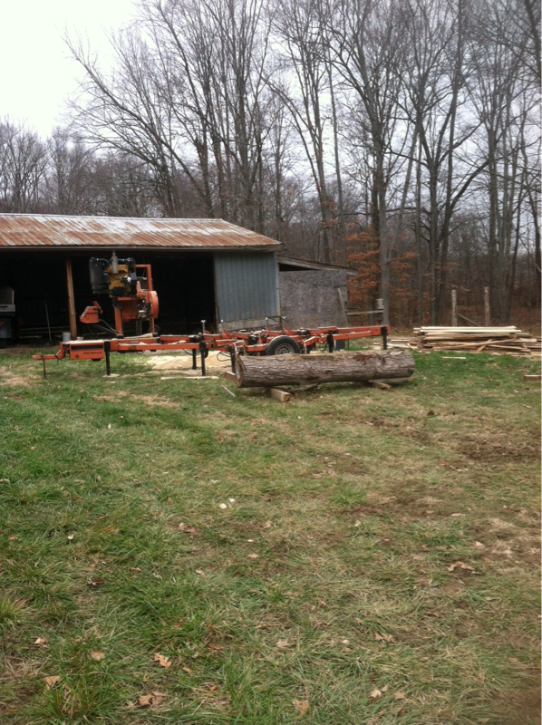

Put some good hours on the tractor as I had some lumber milled for my barn project. There were three of us and we did Jst shy of 6000 bf in about 12 hrs.

Yeah and the sad part is I only have about half what I need. I need to round up quite a few more poplar logs this winter.

How much weight do you have in your wheel weights? Are your tires filled also?

I believe the weights are around 100lbs a piece and I'm running two on each side. Tires are loaded with rim guard and it's still not enough. I have a sheet of 3/8" plate I'm gonna make a skid plate out of. That oughta add some weight...
