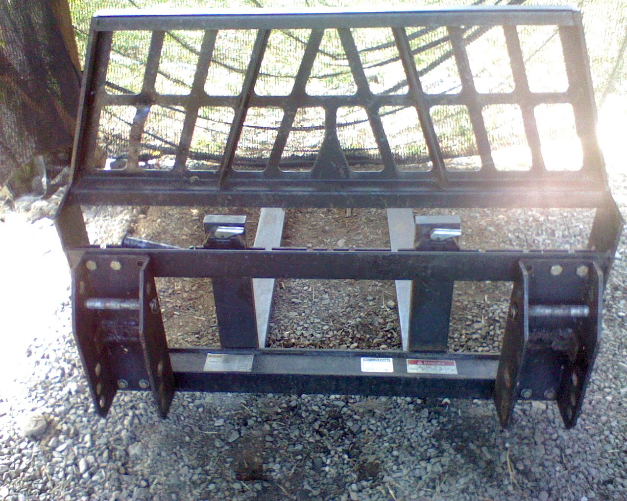

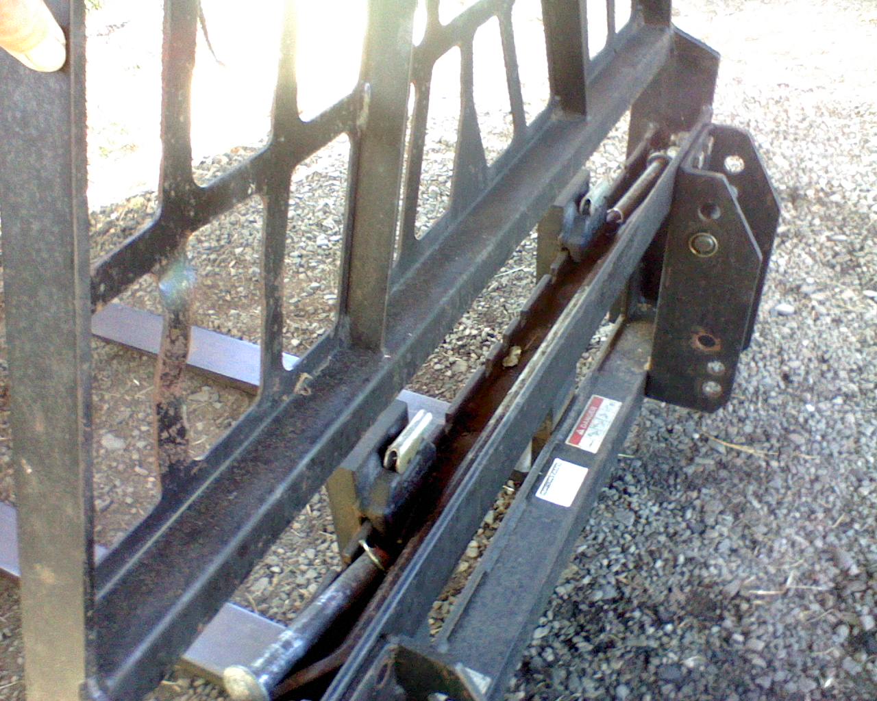

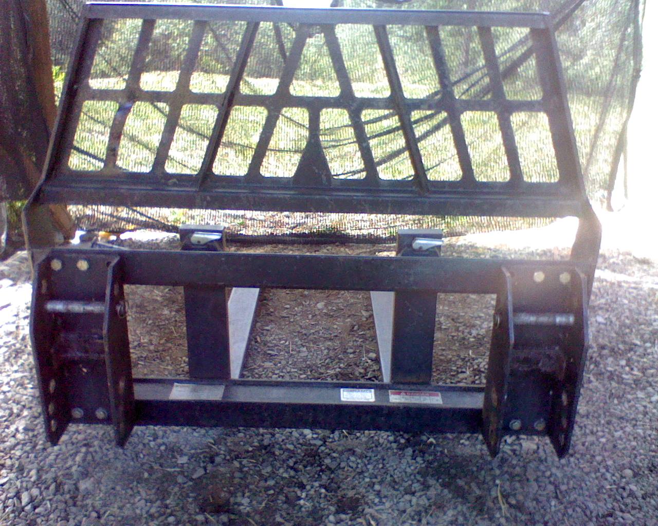

I want to increase my firewood carrying capacity. If this is doable, I won't have to buy another set of forks for the 3 point hitch. Does anyone have an idea on the best way to add pins and a top link to this unit? I have an excellent mobile welding service so I don't have to transport it to a shop.

My guess would be to make up a subframe/adapter that pins to the 4 bucket attachment points.
It would have correct class 1 spacing between the lower links and a center mount for the top link at the correct height. Advantage is that you remove the subframe when you pin it back on the FEL, so no extra weight/lost lift capacity.

We sacrificed the 3 point hitch assembly off an old scraper blade, and welded it on. Works great.
The carrier came off an old MF industrial fork lift.

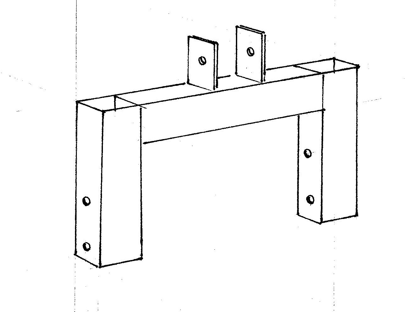

Here's what I was thinking of ...
Pin it to the forks when you want to use it on the 3pt & remove it to use forks on your FEL.
... dang, just realized I forgot to sketch in the lower pins .... they would be attached to ears
on the front of the vertical tubes.

Thanks a million Baby Grand. I will show this to the welder.
