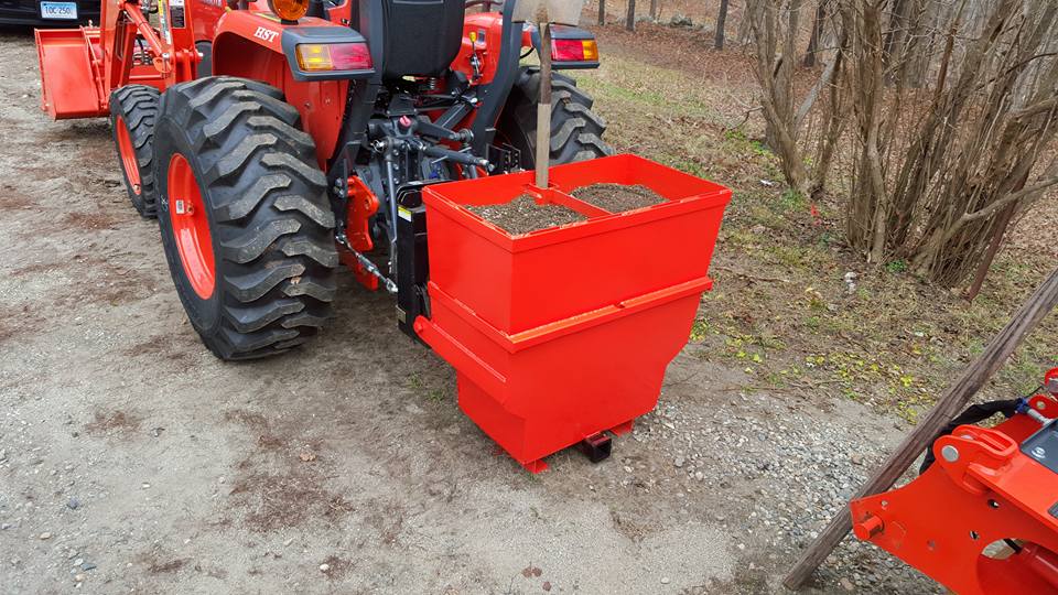

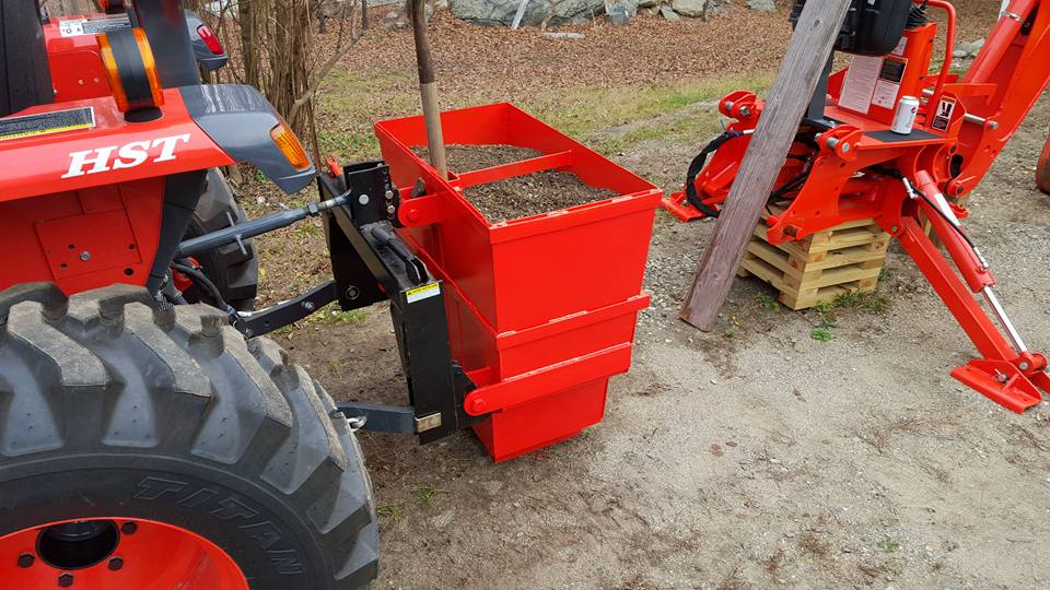

I did a little customizing on one of Kubotas ballast boxes. I made it a foot taller, modified it so I can use the quick hitch and added a hitch receiver. I filled it with pea stone and figured it weighs around 1000 pounds, give or take a few.

Looks great. Handy to have stone for winter traction too if needed. What did you do for drainage if it's raining etc. ?
   / Modified my Kubota ballast box
Drain holes at each bottom corner..
