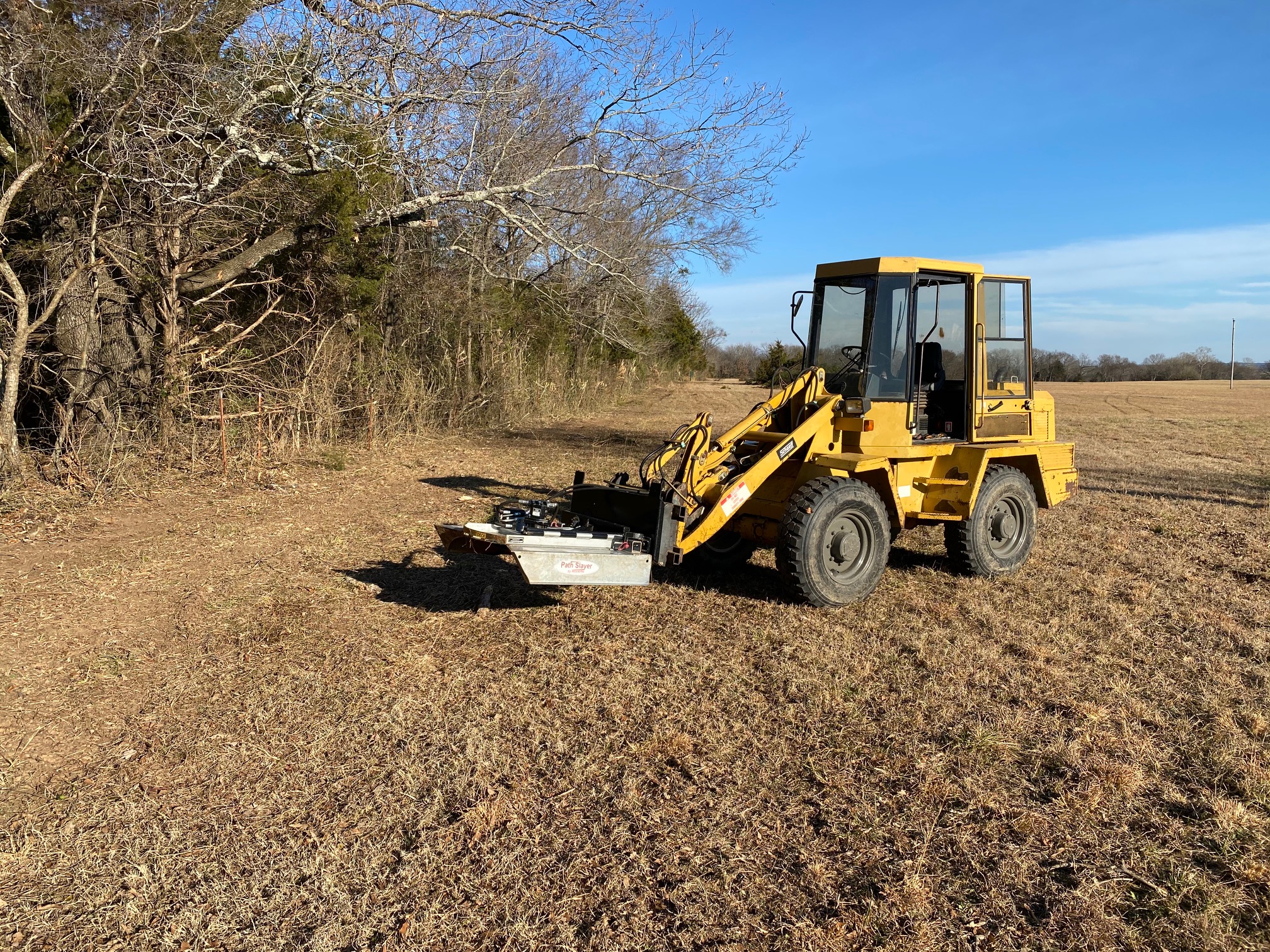

I just finished the first job with the Modern Ag Products Path Slayer. The task was pushing back many years of fence line growth here in our temperate hardwood forest. With 50 or more inches of rain a year it does not take long for the undergrowth and Eastern Red Cedar to make a lot of progress. At least I can now see the back fence I bought some years ago. I've attached a picture of what I cut, grappled and stacked over a period of under 30 hours of work. The machine did work but with some misgivings.

5. So long as you keep the thing wound up it will actually cut nearly 4" stuff. I was able to cut the whole side out of some fairly large cedar trees. What I could not cut off with the Path Slayer I lopped the top out of with the tree shear. It is a Quick Attach and a great piece of equipment by the way. The branches are numerous but brittle and just nasty to mess with. Six things I hate: Eastern Red Cedar, gophers, yaupon holly, wild ligustrum, snakes and fire ants. This is not a complete list but I'll leave it at that now and not get into politics or social engineering.

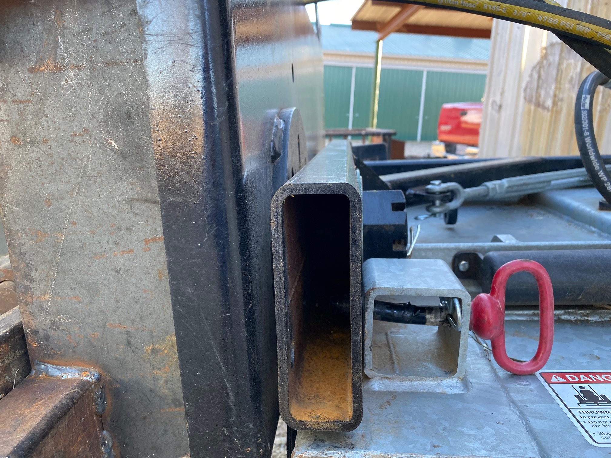

3. The main pivot is sloppy and makes the unit droop and flop around. I just hope it does not get worse. A bolt and hole just don't cut it to cantilever 500 lbs on a moving machine.

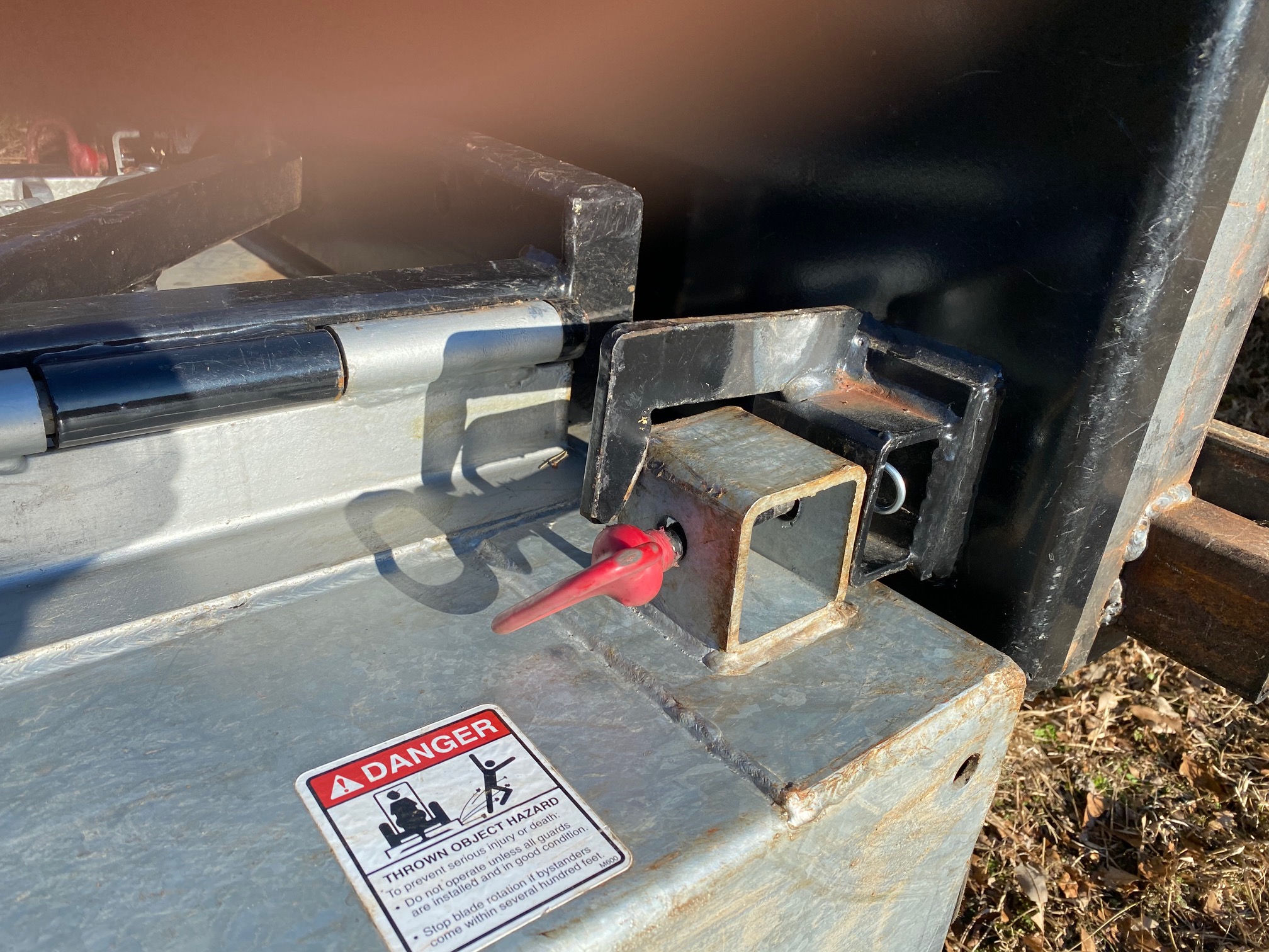

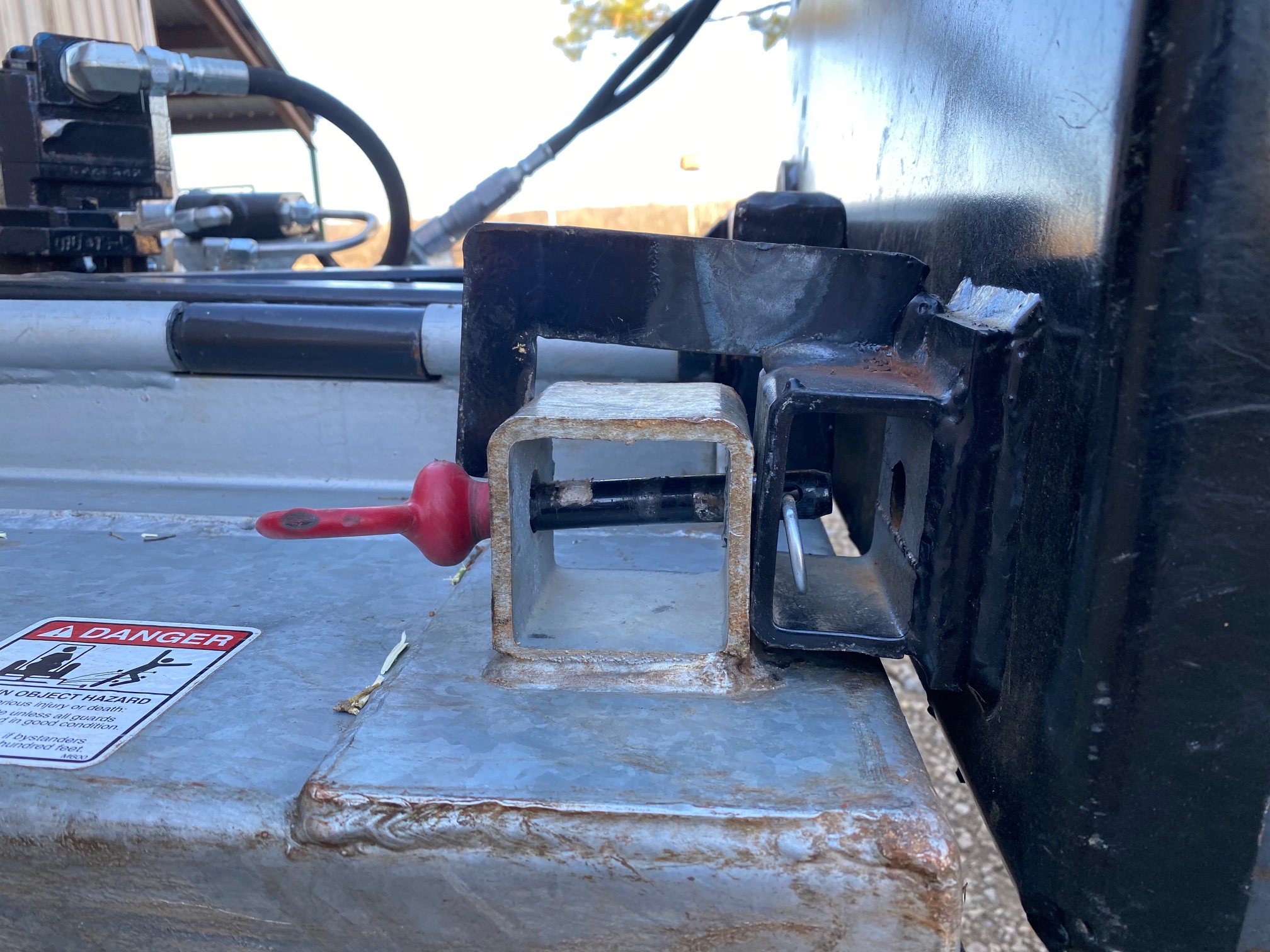

4. The finger they added to hold the deck in place while stowed is flimsy, just a Rube Goldberg band aid fix. I've already heated it once to bend it back in palce and will have to beef the thing up with a set of gussets to keep it in place.

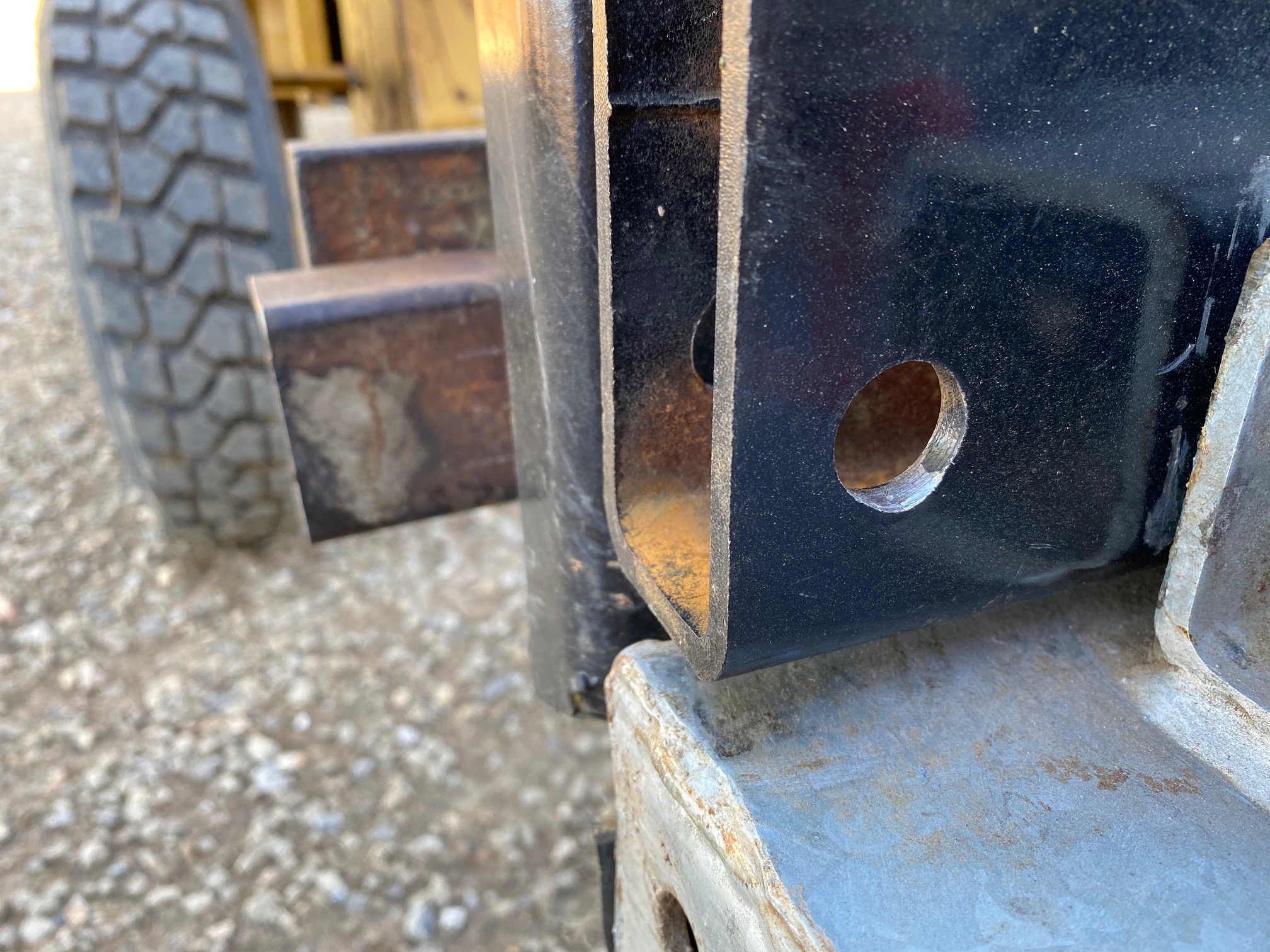

5. The pins that hold the swing arm in the various positions are not nearly big enough for the loads imposed. One has already bent. I'll have to make the pins bigger but first I'll have to make all the holes the same size. You just can't put a 500 lb force on the end of a 36" lever arm and hold it in place with a 3" lever arm on the other side of the fulcrum. Just won't work. Not with sloppy pin holes and small pins. That 500 lbs becomes 12 x 500 lbs force on the dinky little 1/2" pin. Easy math and physics.
6. Holes that hold the pins are not the same size. Not only will I have to bore them out but they also need bushings. You can't stick a pin through a hole in a plate that has moment on it. The intended load is shear and not moment. This means that I will have to buy some mechanical tube the right size, enlarge the holes in the plates and then weld the mechanical tube in place probably with some small gussets to keep the whole affair in as close to shear as I can make it while still having enough slop in the pin hole tolerances to allow for the floppy main pivot.

8. I really need to change the retaining pin holes location and extend the short lever arm and probably have to clamp the support arm to the backing plate using a big wing nut or something similar to keep the whole thing stout. I think the 36" support arm and 3" restraining or retaining arm are a losing battle no matter how much mechanical tube and well fitting pins one uses.
