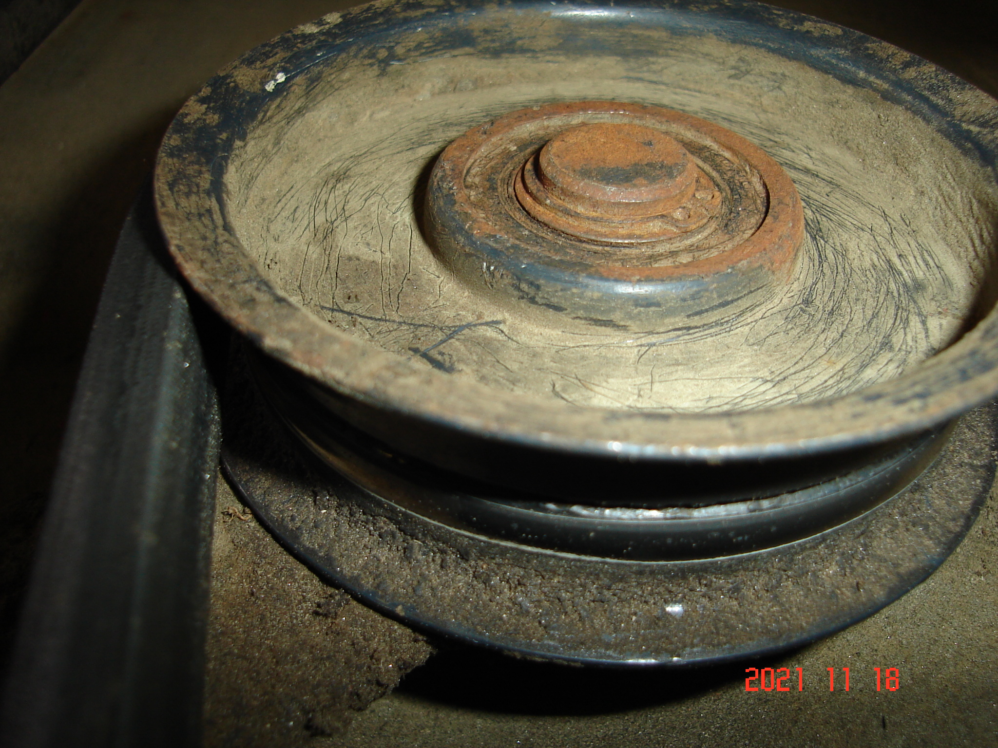

Yep, just went out & looked at my 2360 and sure enough, there's a small snap-ring at the top of the idler pulley "axle." Drilling into that & tapping for a bolt & washer sounds like a great fix, if it holds up. You might want to use some thread locker on the bolt. Here's a pic -- (No extra charge for the dust, as they say....)
That is some good looking dust compared to the red clay dust I see. Thanks for snapping that picture as that lets me know what used to be holding the idler pulley on. Guess I was lucky it came off when the PTO was off. Going with new parts for it as I would rather not have my work spinning that fast under me.

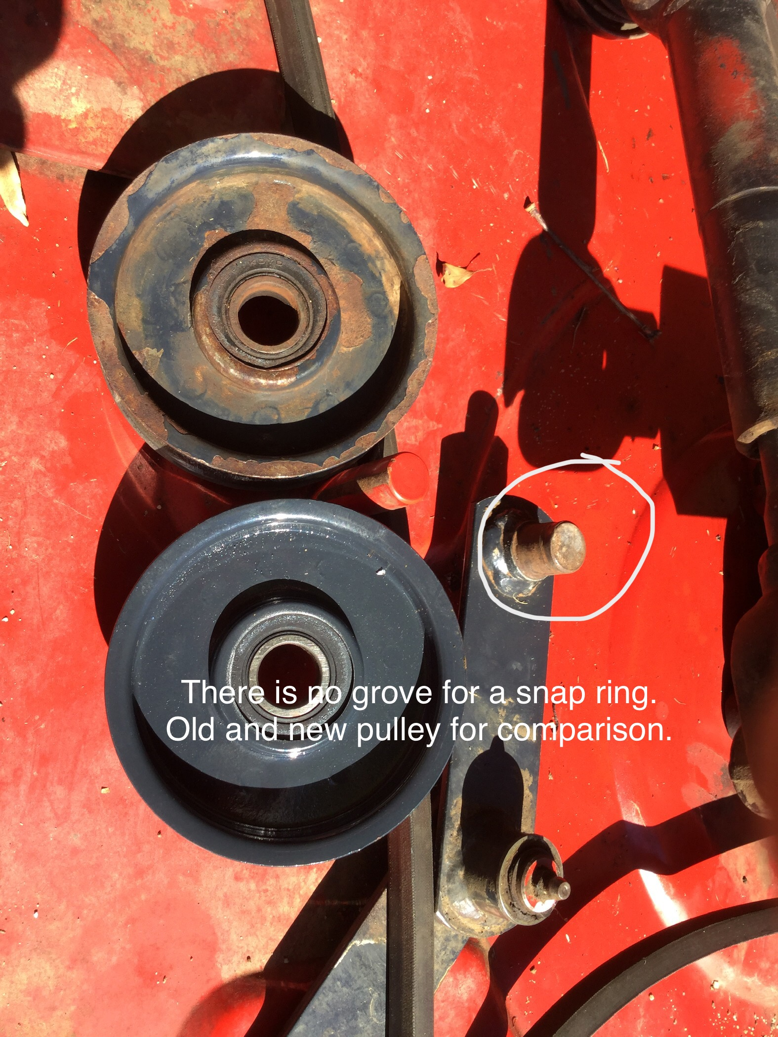

Thanks Dave as I meant snap ring. Here is a photo of a new and old pulley along with where the pulley goes without any grove.
The snap ring shown in your image is not the same in mine as it shows a snap ring underneath the pulley which makes no sense to me.
There is a grove at the top of that shaft in your picture for a snap ring

Could do the washer trick just need washers that fit over post and contact bearing on it's center and not outside rotating part. Use enough washers to build up to top of post then use washer that covers larger washers and loctite new bolt in.

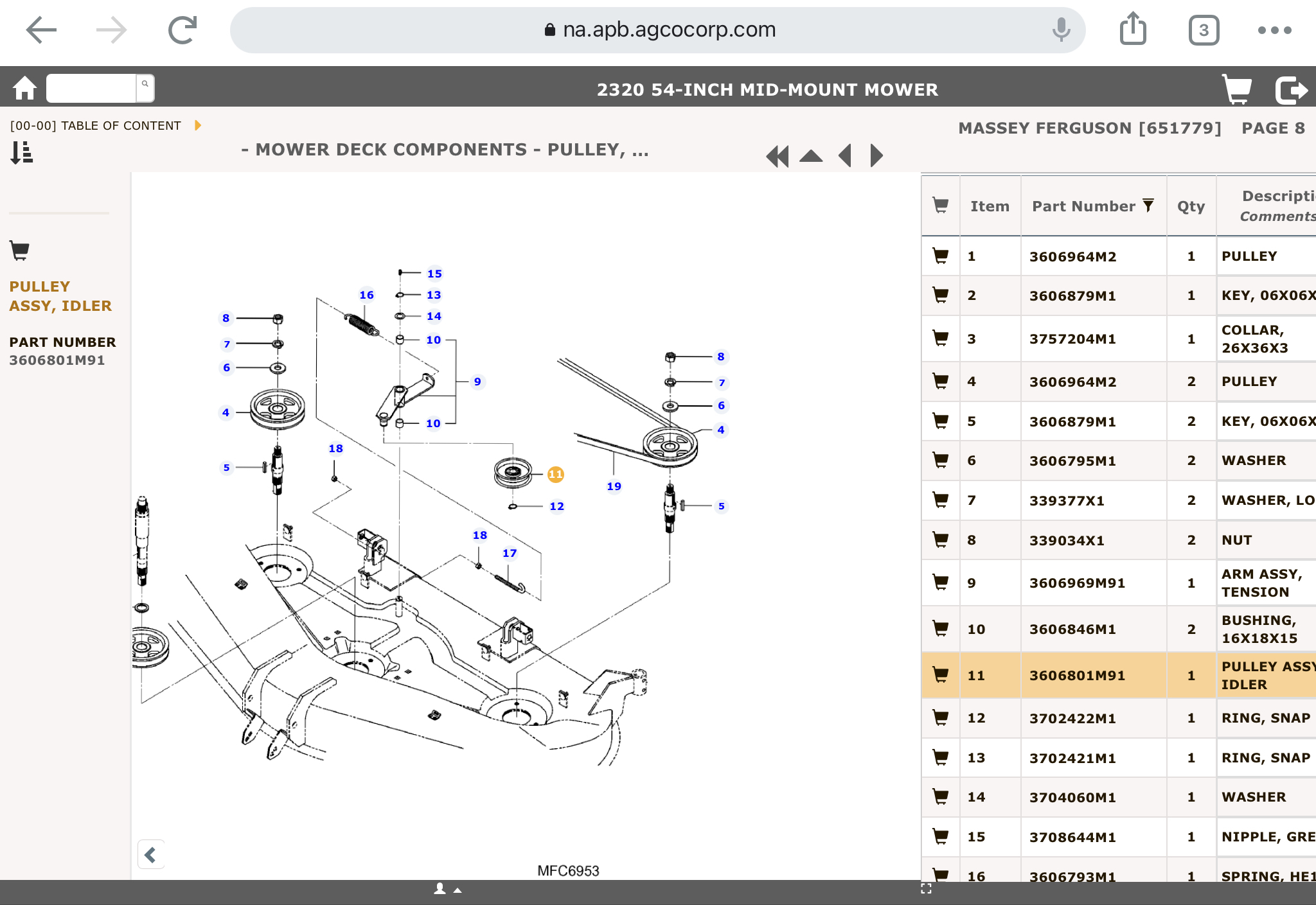

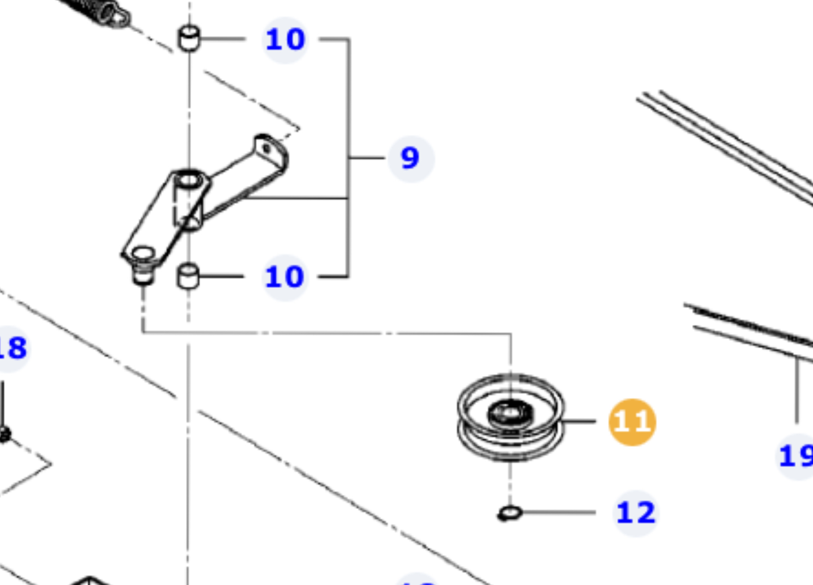

diagram makes it look like pulley sits UNDER the arm so yeah, clip would be on the underside.
part # of arm is 3606969M91 and its approx 110$ before tax.

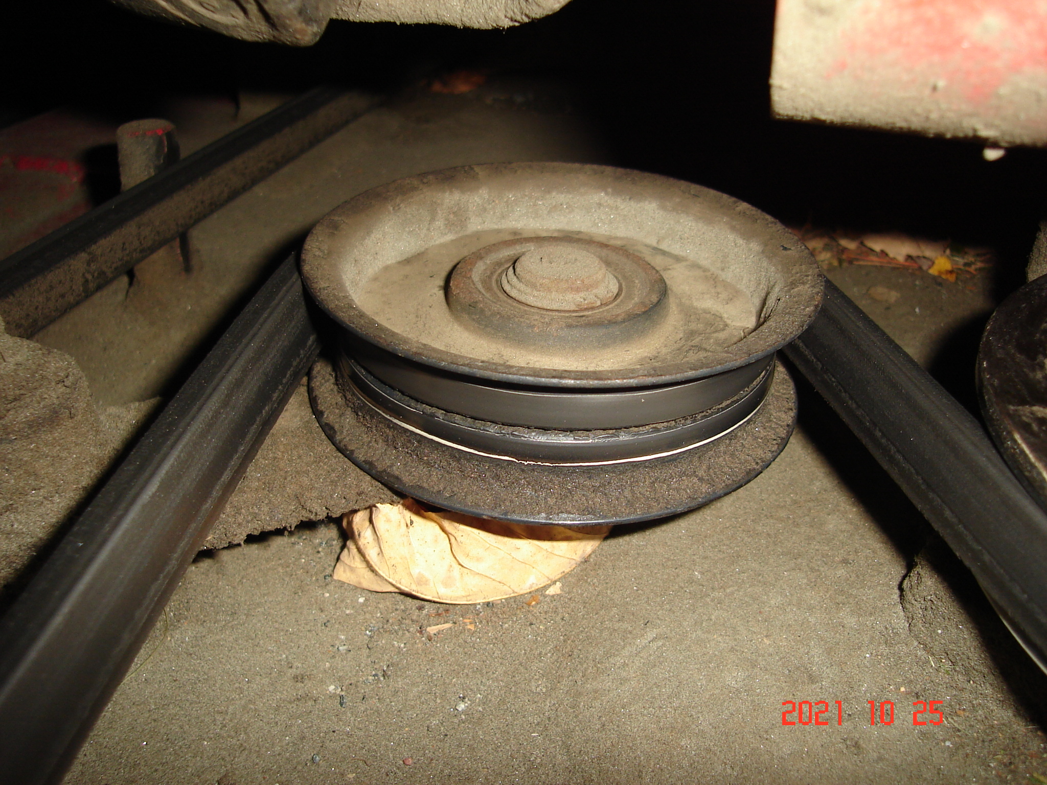

And for those who may be interested... now that snow-blowing season is approaching, I've dropped the MMM for a Full Monty service. Here's a better pic of that snap ring on the idler pulley:
