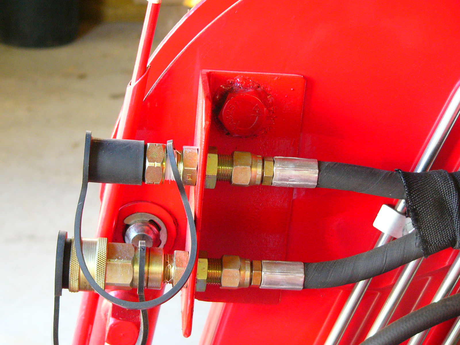

I kinda hope Jeremy is around! :D But if not, does anyone else have any idea what these two 3/4" holes are for on the ML112 FEL's boom??? Believe it or not, I have a legitimate reason for asking... this is not just random contemplation of one's navel. :)
Please don't ask me what the winner gets. You all know the Dougster is broke! :p
Dougster
Dougster: They put that hole there so that my remote connections bracket bolts right up!
So, in other words, I was not the first??? :D
Dougster
