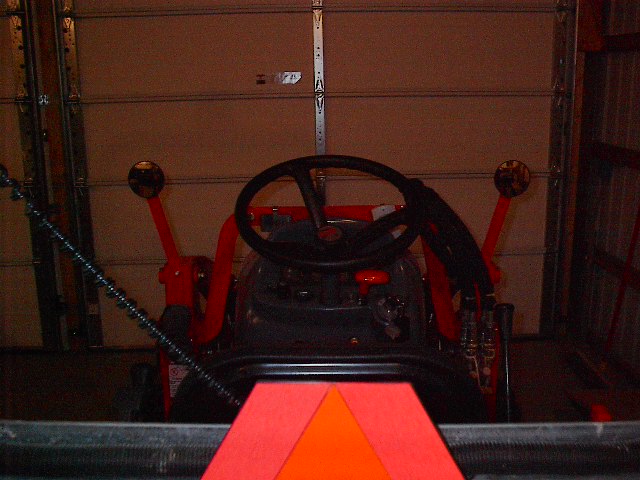

I finally put them on /forums/images/graemlins/smile.gif. Gerard

This photo was taken standing behind the tractor. Gerard

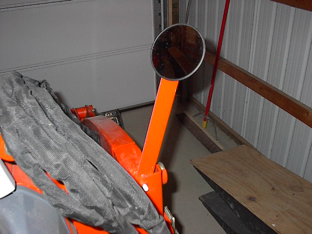

They look great! Did you make them?
   / Mirrors on my CK20....
Thanks JayC.

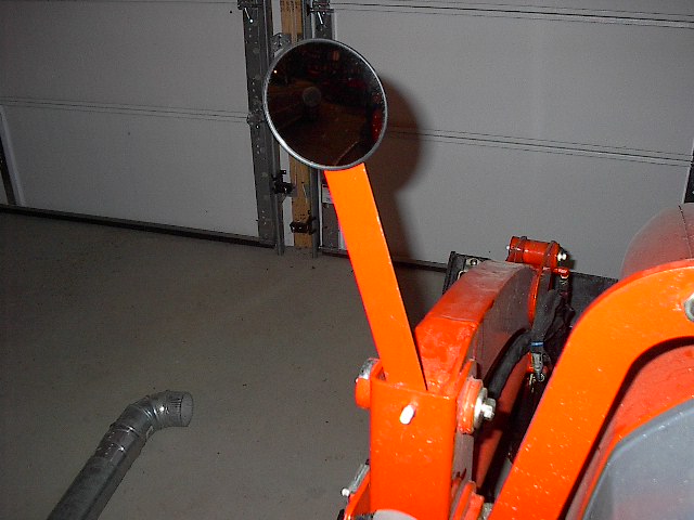

Yes, I made them. I bought some flat stock, paint and the convex mirrors for under $10.00. I used a permanent 2 sided tape to attach the mirrors to the flat stock. Then drilled and bolted them to the frame work. Attached are 2 more photos. Gerard

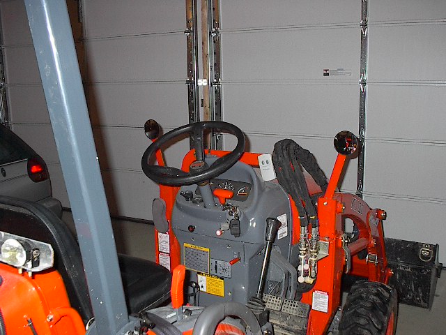

Right side. If you look in both of the mirrors, you can see the rear fenders/tires a little bit. This gives me a good view while backing up as to what may be on the ground. Gerard
