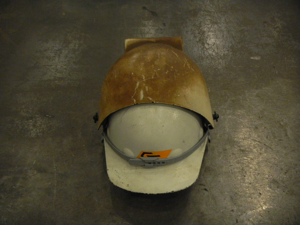

Aren't those fancy hoods awfully heavy? This is what they made us wear, now this is heavy. Especially when you had to tilt your head to the side to weld up under something! :thumbdown:
   / Miller Classic Welding Helmet - HELP #17
That was the number one reason that I quit welding, when we had to wear a hardhat with the hoods. When welding pipe, you always had to lean your head sideways when starting under the bottom of the pipe on each pass and ALWAYS the hood slipped sideways. You could use the ratcheting head band on your hard hat but to keep the hood on, you had to ratchet it down so tight that you would get a headache. Thankfully I got in to supervision and later on QA/QC Manager before I had to weld with them other than a little demonstration now and then when I taught welding at a community college.

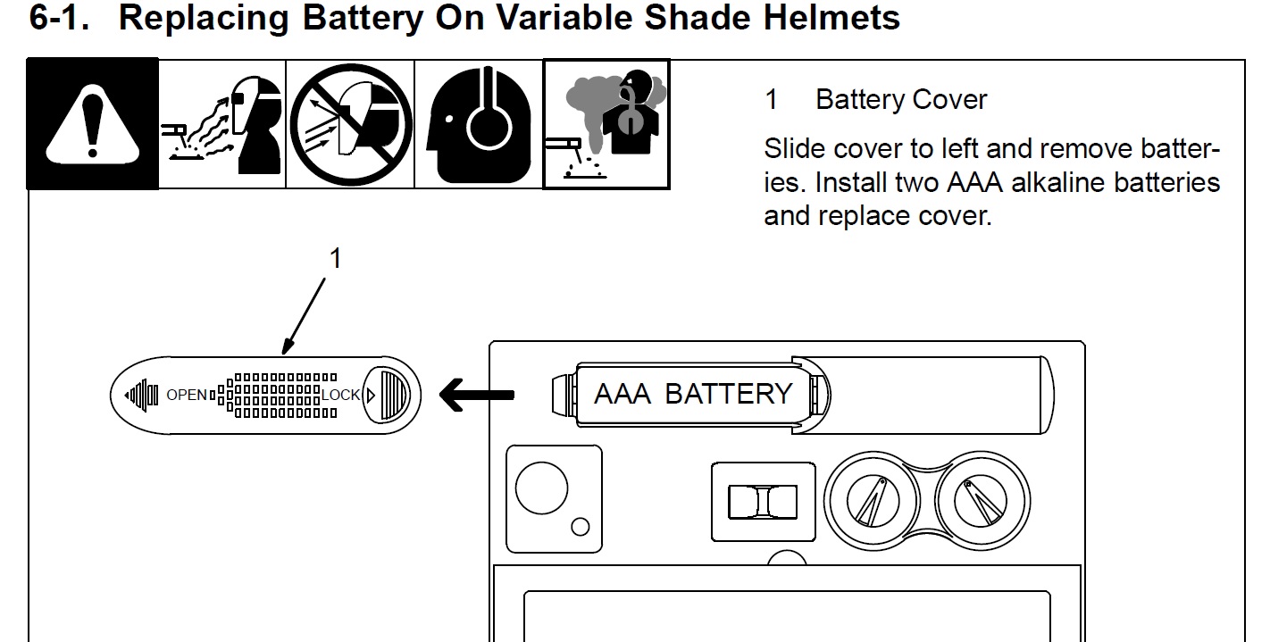

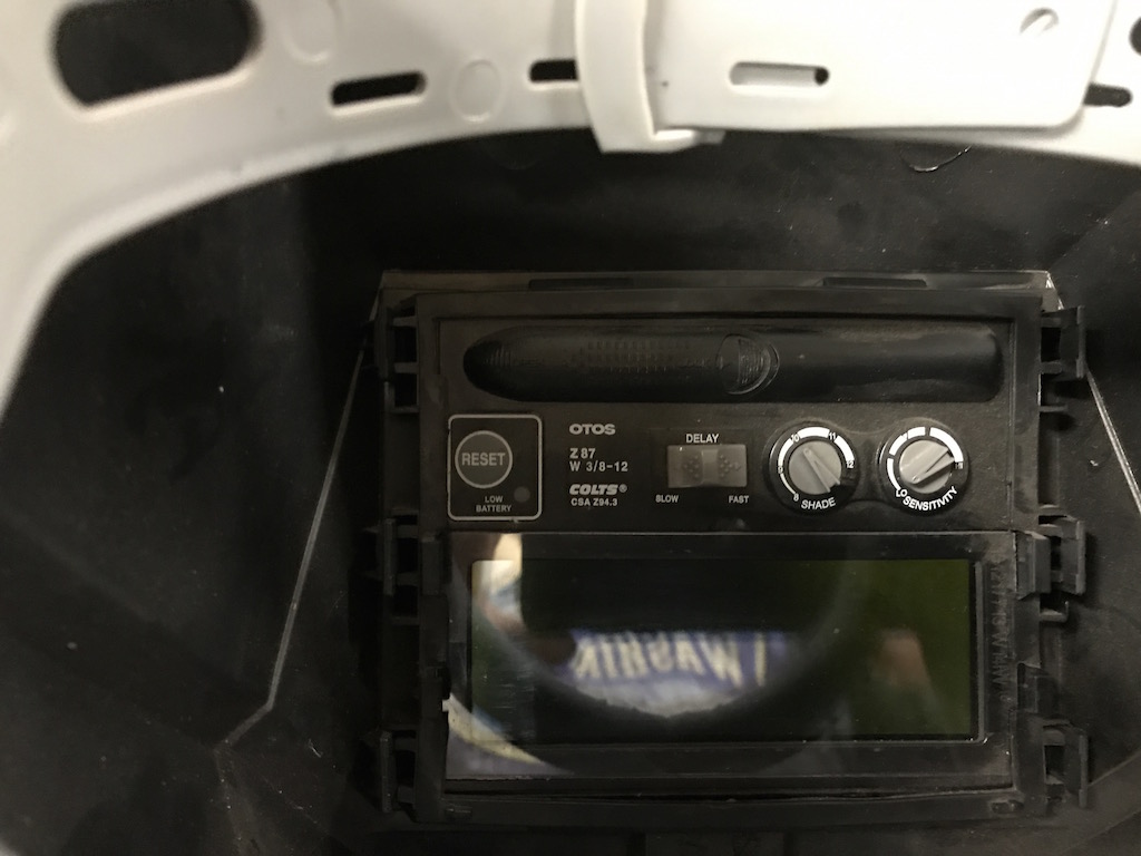

Here is what I am dealing with. This is stupid! I should have popped this off and replaced the batteries hours ago. :pullinghair: Yeah that reflection in the pic is my U@W Husky shirt. Go Dawgs!
Slide that top cover to the left. Push with your thumb on the grooved area with arrow, that says "lock".
