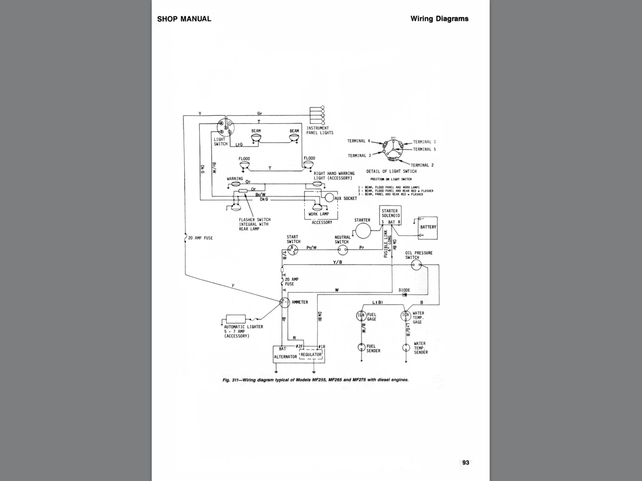

Hi all, the ignition fuse on my 1970's MF 265 has started to blow. I realize I'm looking for a wire that is grounding to the body somewhere, and there aren't a lot of wires on this tractor. I've spent about 4-6 hrs. going over the wiring to no avail. (This tractor does have a cab which does make it a little more awkward).
I finally removed the front end loader to make it easier to see. I still cannot find the issue.
If I put in a new fuse, the tractor will start right up and I can drive around all I want. When I shut down, I can't start it again until I change the fuse. When I do, it's good to go until I shut it down again.
We've had this tractor about 20 years with no major issues until now. (I did change out the starter bendix). Any suggestions out there? Could there be an issue with the altimeter, or the alternator? (They are the originals)
Any help would be appreciated.

I think I would be looking at the back side of the key switch.. seeing it only does it at "shut-down"..

My mind keeps coming back to this bit, "(I did change out the starter bendix)" .
When you put the Solenoid wires back on, are you sure the wire terminals are not touching anything metal ?
I think that fuse is blowing pretty quickly, but as it is a Diesel engine, it just keeps running until you pull the stopper . Then you find the fuse is blown when you try and re start it .
When you say "ignition fuse", you do mean the one that puts the ignition light on and NOT the start fuse that sends power to the Solenoid via a Relay ?

I would use a test lamp and monitor when fuse blows, that may be clue to what problem is... What is happening in system when fuse blows... When chasing electrical gremlins I find test lamp is best tool ever on non-computer systems...
It's simple to use, put alligator clip on good ground, use probe to test if power (12 volts) is there, lamp on you have power, lamp off there is no power....

Hey there. Thanx.
I changed the bendix on the starter maybe 1 1/2 - 2 years ago, thinking about it I also changed out the battery last fall, but used tractor to plow snow all winter, and prepped a field to seed this spring, as well as cut/rake/bale a small hay field this year with no issues. (Luckily, the fuse started blowing right at the end of my baling).
If I change the fuse, start it up, run for 5-10 seconds, then pull the stop, the fuse is still good. Did this 4-5 times in a row, but when it runs for a bit then the fuse is blown when I shut down.
To my knowledge, according to the wiring diagram, there are only 2 fuses on this tractor, one for ignition/one for lights, as this tractor is from the 70's. I have Downloaded the MF service manual, and got the wiring diagram from there)
Starting to wonder about voltage regulator/alternator/key switch?, after all this machine is almost 45+ years old and, to my knowledge, original equipment.

Have you checked to see how much voltage your Alternator is putting out ? Maybe it is overcharging ?
I once had a similar thing happen to a truck I had . The rectifier in the Alternator went bad and instead of the Alt putting out DC, it was putting out AC which blew a lot of things up on the truck .

I have thought of that. I'm trying to get ahold of one of my neighbors who is a retired automotive/aircraft mechanic, to see if he can come down and take a look. I've also thought of a crapped out voltage regulator and key ignition shorting out as well. Think I've mentioned before this tractor is from the mid 70's (that has been rode hard and put away wet, lol). Haven't had to do much to it except oil changes and a couple of batteries, plus a new bendix, but that was a while ago.
