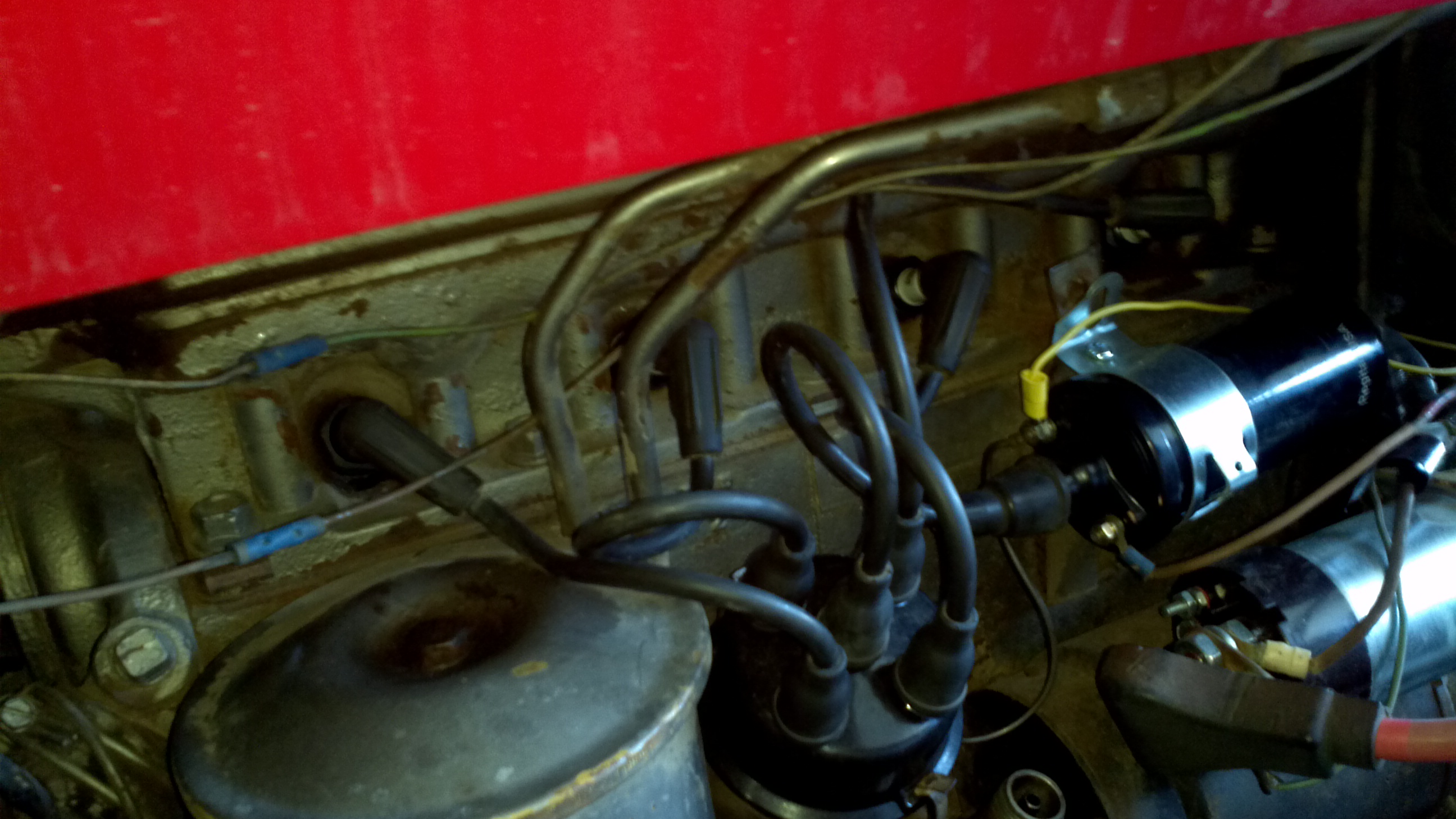

What about the firing order? The picture looks like you may have it incorrect.
I was thinking the same thing. The top of the picture doesn't show all the plugs, but it appears to be wired as 1-4-3-2, where reversing 4 and 3 to make it 1-3-4-2 might correct the firing order.

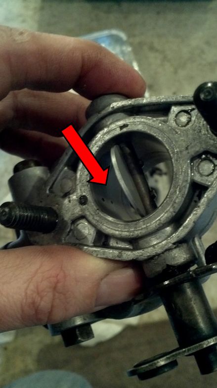

Thanks for all the feedback guys. So I pulled off the carb and determined it's a Zenith 13800 carburetor. My understanding that somehow translates to a model 61 or 161. Not sure how that works, but google seems to think so. I guess the previous owner tried to rebuild it as well, because it had the wrong gasket and they also had to patch with gasket paste.
I put a red arrow to highlight the gasket paste. When I pulled it off I thought for sure a good cleaning and new gasket would solve my problems choke problems, but no such luck.
I got the primary jet out and verified the float, but I couldn't get the idler jet out. I cleaned it thoroughly and verified it wasn't clogged (carb cleaner drained through it). When I put the carb back on and she fired right up with the choke on, but when I tried to lean it up (no choke) she starts to sputter and will eventually die. The throttle works fine and I can get near full RPM. My understanding of the Zenith 13800 is that there is no mixture adjustment. All documentation I can find says the idle adjustment (green arrow) is the only adjustment. Do you guys agree?

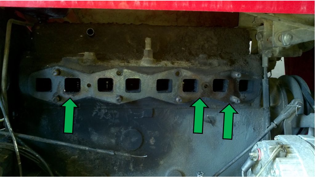

I decided the next step is to check the intake\exhaust manifold for leaks. My gasket finally arrived today and I pulled it off. Sure enough, it appears that I've got some leakage around cylinder 1 for sure, but maybe also on 2 & 4. The gasket itself didn't look that bad, but I'm wondering how tight the manifold was bolted. I was going to clean it up and put it back on with the new gasket. Do you guys know the correct torque ft lbs?
Here's another pic of the distributor. I've got it setup to 1-3-4-2. (CCW)

I found pieces of a copy of the MF230 service manual online and determine the manifold torque spec is 30lbs. I put it all back together and she fired right up....but same as before...would only run with full choke. I've pretty much convinced myself this is a carb problem, but just to make sure I'm not missing something stupid. I tried to run it without the air filter (just in case it was no allowing enough air), but not luck. I also put the timing light back on and verified correct timing and that all 4 plugs are getting spark.

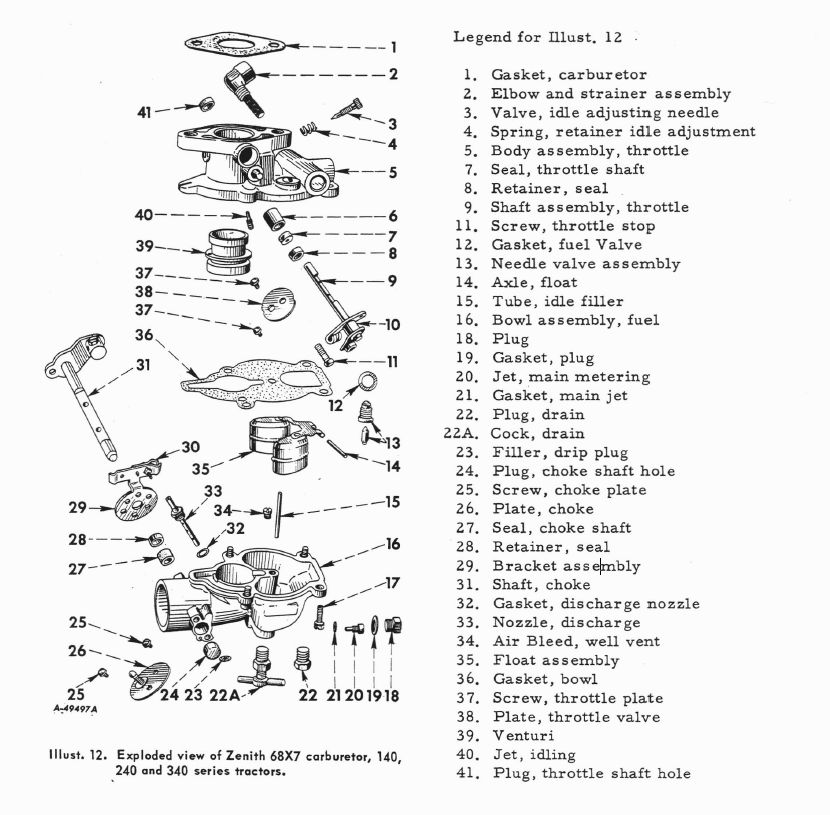

Success!! I'll write this up just in case somebody else runs into this same problem with their Massey 230. First things first. The Zenith carb is a 68x7, not a 60 or 161. I ended up buying a Zenith carb manual and found this sheet.
Most of this wasn't new info to me except that you should be able to remove #15 Idle Filler. I still have no idea how as I couldn't do it without damaging the tube. I left it in and just sprayed the heck out of it. I decided that my problem had to be relate to the idle jet (#40) as that's the only one I couldn't get out before. No change there. I tried spayed it down and tried to unscrew, but I could tell that the jet was starting to come apart at the screw top.

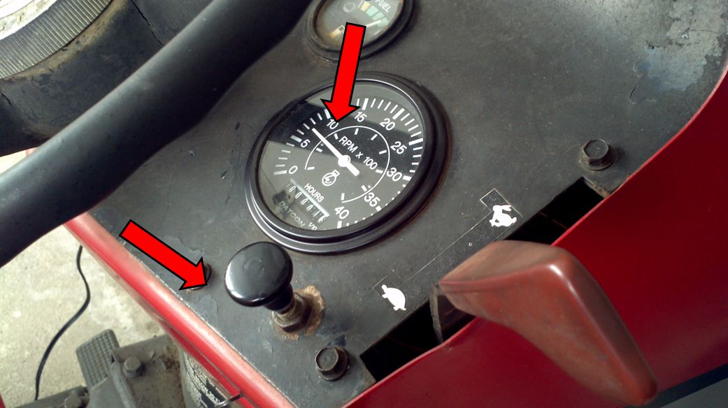

I also noticed that a Massey really wants to be warm before you can pull the choke. I'm used to using choke for <30 seconds on other equipment, but this tractor wants to be warm (~3-5 minutes) before I could completely remove it. During that time I was slowly adding and removing choke while listening to the engine to determine if the mixture was better or worse by RPM. I didn't have much luck with the idle adjust (#3). I'd rotate and out without much difference. I think I'll save that for a warmer day.
Victory Pic! Idling nicely with no choke! :)
