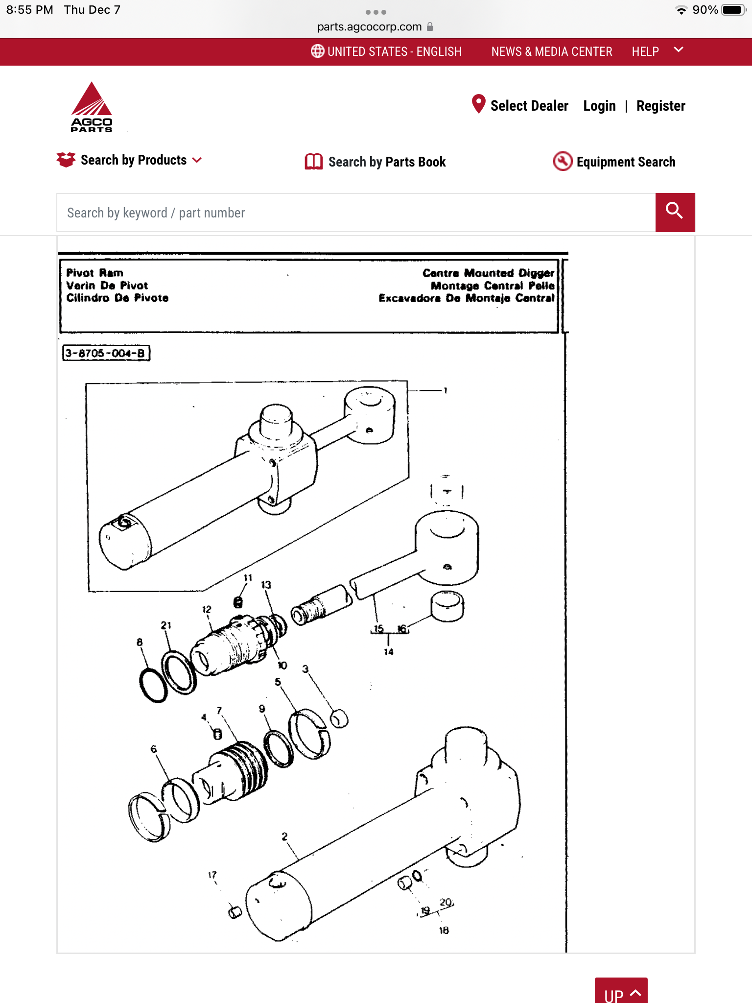

Massey FERGUSON INDUSTRIAL 50D TLB. NEED TO ID HOE. IT HAS TO SWING CYCLENDERS

I believe up to and including the 50D, the swing was a motor. The backhoe was a 54.
The 50H also had a swing motor. The 50H S had cylinders. Is it possible you have a 50H S or the backhoe from one? Do the cylinders look like this?

   / Massey FERGUSON INDUSTRIAL 50D TLB #4
50ds had opposing swing cylinders
Yes that's what they look like

   / Massey FERGUSON INDUSTRIAL 50D TLB #9

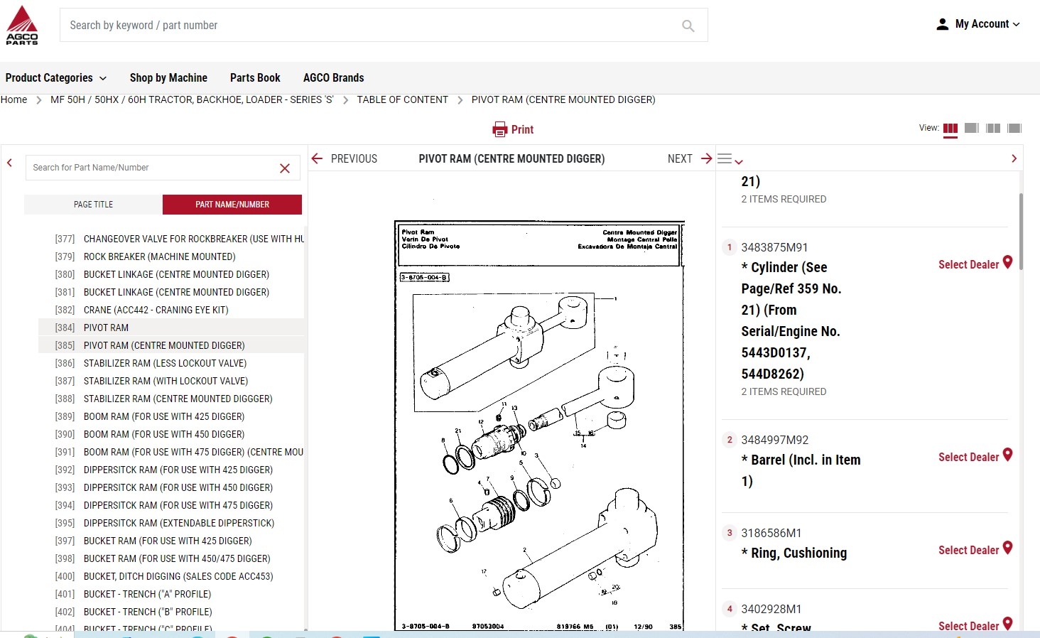

The following swing cylinders are for a 50H S
If the tractor is a 50D, the backhoe could be a 54, 54A or 54B. Picture of swing diagram attached for a 54B and it looks like that of a 50H S backhoe.
Anyway, if you go to the basic AGCO link and hit PARTS BOOK and put in 50H S OR 54, 54A or 54B backhoe and browse the parts book, you can figure out what you have, but probably the backhoe portion is pretty similar on all four models.
