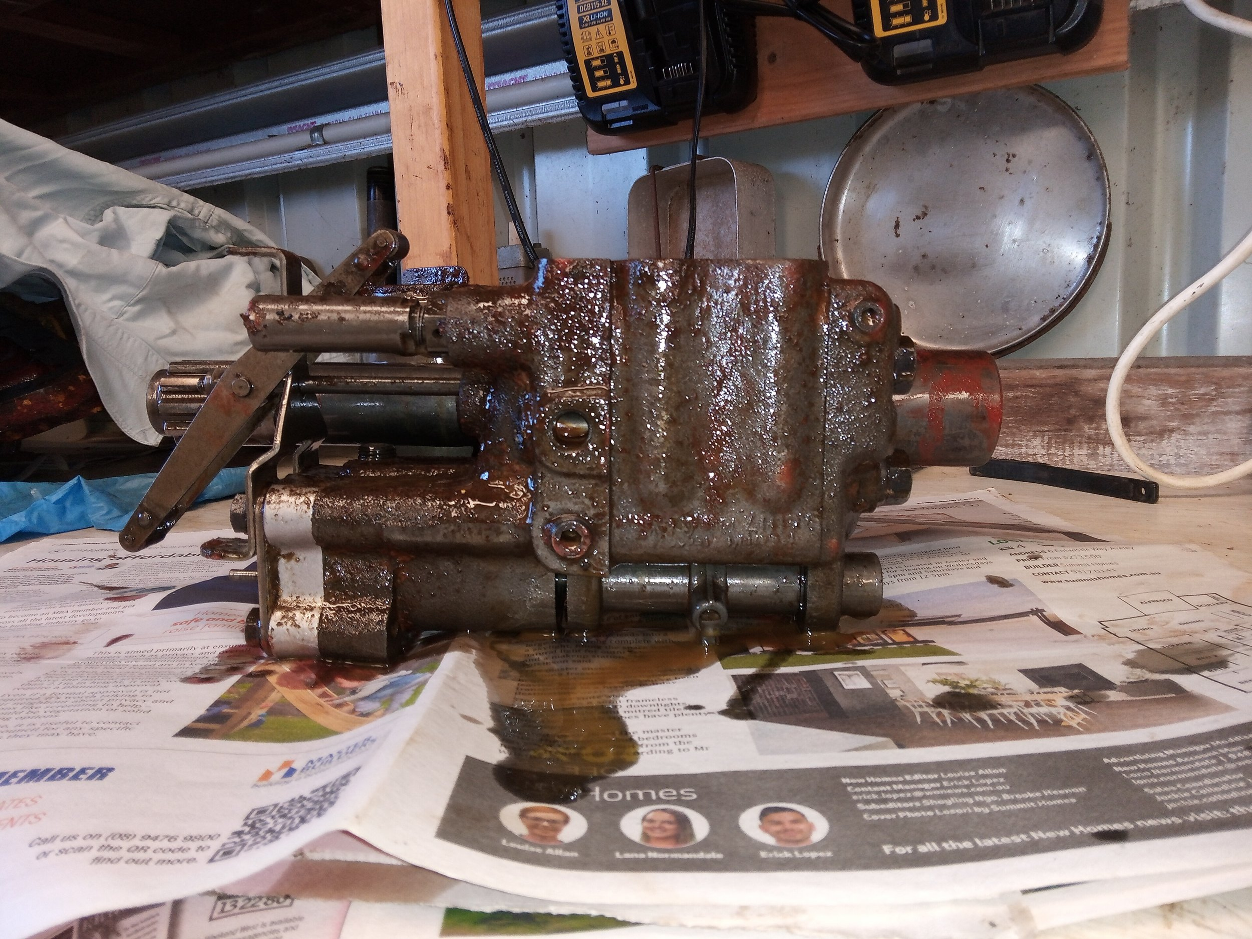

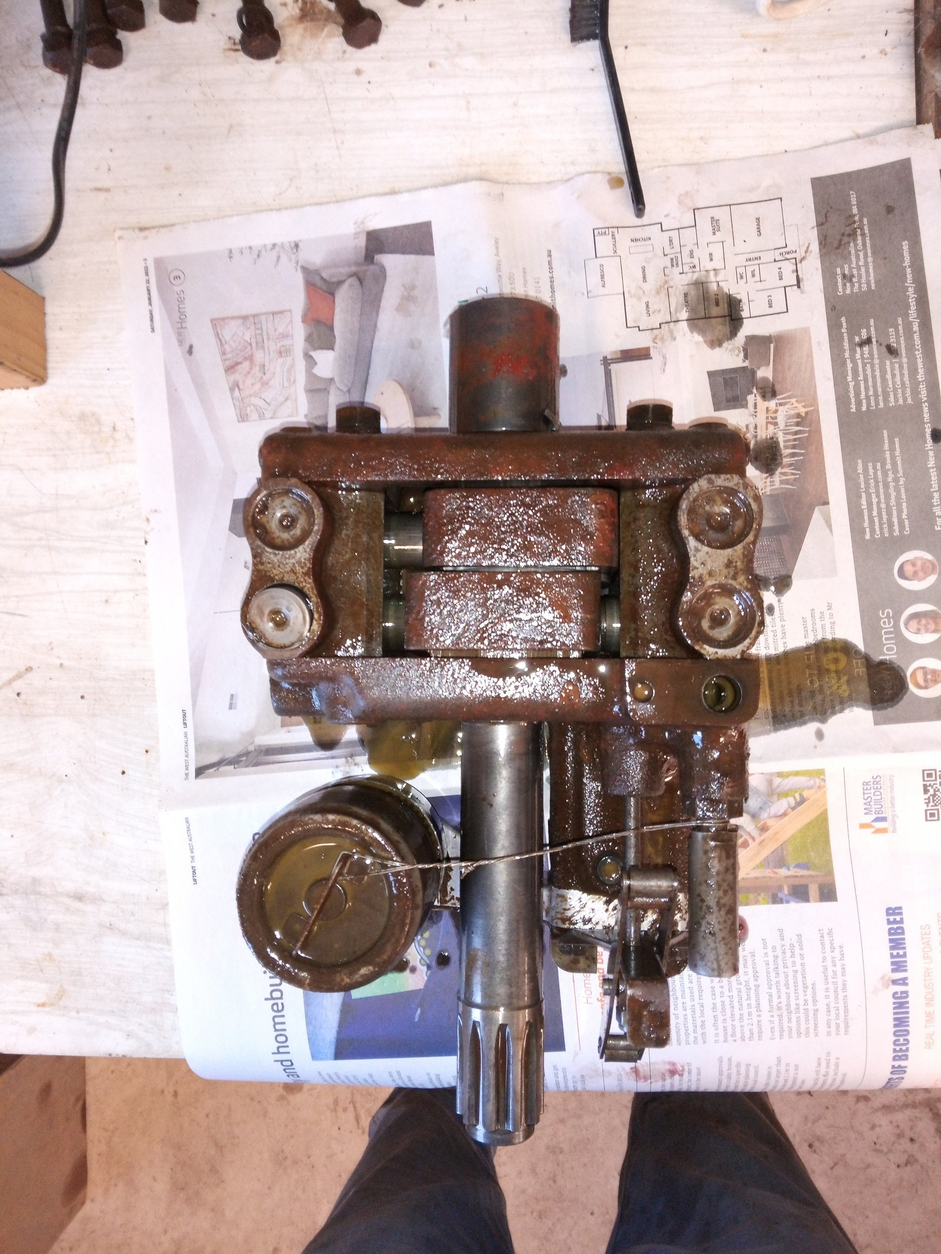

Hi,
Pump is removed from tractor and I found one valve assembly pushed out of the housing - see photo. There may be other issues with the pump as well, so I'm considering just replacing the pump with new from Inside via eBay.
Does anyone know how to tell it the pump in the photo is a Mark1 or Mark2? Does it matter if I swap Marks?
Anyone have experience with the pumps coming out of India?
Thanks for your thoughts.
   / Massey Ferguson 35 Three point linkage suddenly weak lifting
Hi,
For people who may find this useful in the future:
Rebuilt it with a cylinder block, rings and seal kit. It's not hard.
My advice would be mark the alignment of all control valve parts: I didn't and mine is now sticky - it only drops the tpl if the pump is turning which can be annoying when parked.
That burst valve was not causing a diagnostic spray of oil when I looked through the inspection cover.
Enjoy

Thanks for posting back with your findings.
That's odd that it won't drop unless the pump is turning. Is that with your diverter valve installed also?
#9
The control valve has an tendency by design to stick. M F added a "wobbler" that jiggles the valve when in the pump is in motion. Works well, when it's running.
And with a diverter valve in place, the TPL can only be lowered or raised when the diverter set to the the TPL. But that's normal for this configuration on this machine.
