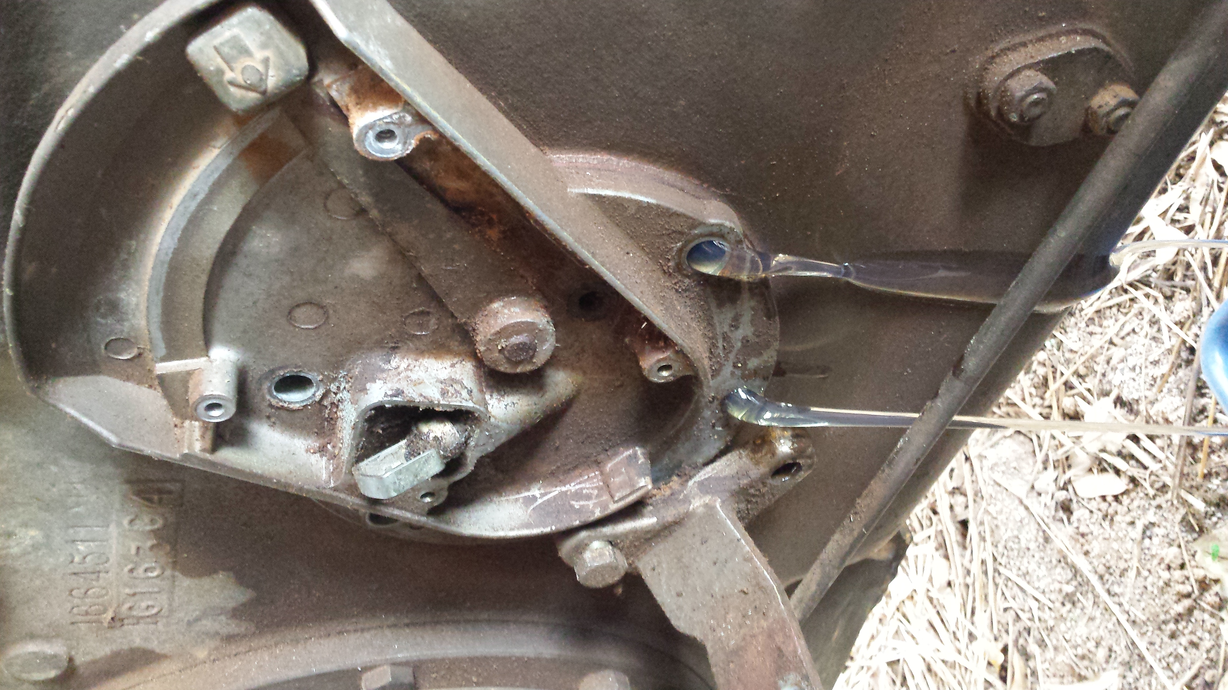

Im band new to the tractor world. I recently bought a home that came with a Massey Ferguson 230. I plan to use this to cut the large yard. I have started and driven the tractor but can not get the 3 point to drop or move.
I reviewed the manuals and see the there is an inspection plate on the right hand side where the dip stick is at. I have started removal of this but have no clue what todo once I get it off. One of the bolts is currently stuck. I have been spraying with PB Blaster.
I'll try to get some picture posted.
Any help with this would be greatly appreciated.

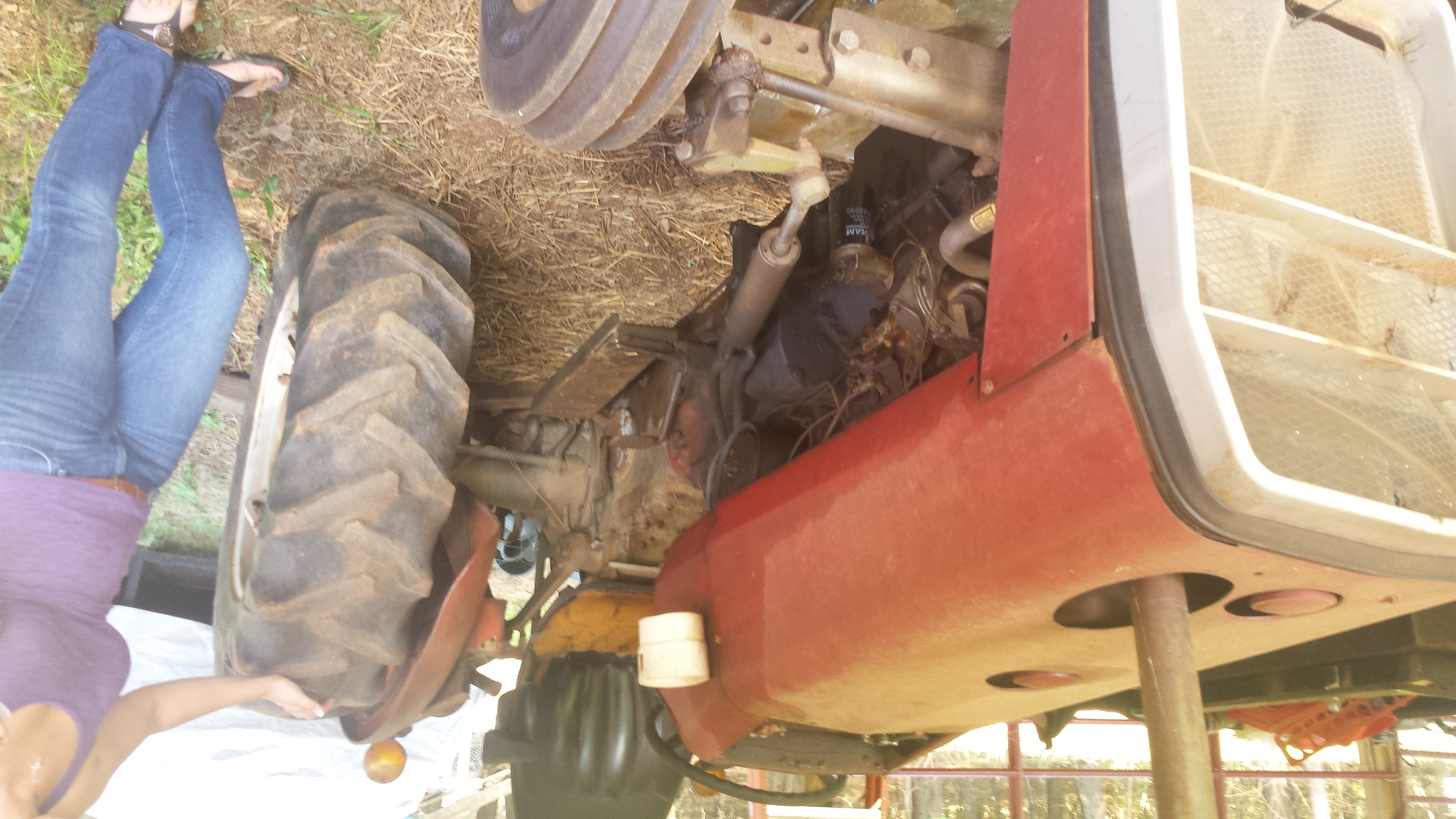

MF230

What is that running out of the bolt holes? Looks like water!
   / Massey Ferguson 230. The little tractor that could not
Its brand new hydraulic oil. The previous owner change the oil and filter when he couldn't get the Hydraulics to move.

That lever is the response rate "slow to fast" The 3 point goes down by its own rate so you might have to push it down a bit cause nothing is on it.
With the response rate lever in the fast position, how much weight did you have on the 3pt to cause it to go down? Remember the 3pt only goes down by the force of gravity. With no weight on the 3pt, many of them if they are a little stiff wont go down at all. 3pt's go up by hydraulic flow to a cylinder, they go down by the force of gravity. With a few exceptions of a few foreign tractors.

The lift control valve is internal and it moves in one direction to let flow out of the lift cylinder and the other to allow pressurized oil out of the pump to the lift cylinder.
