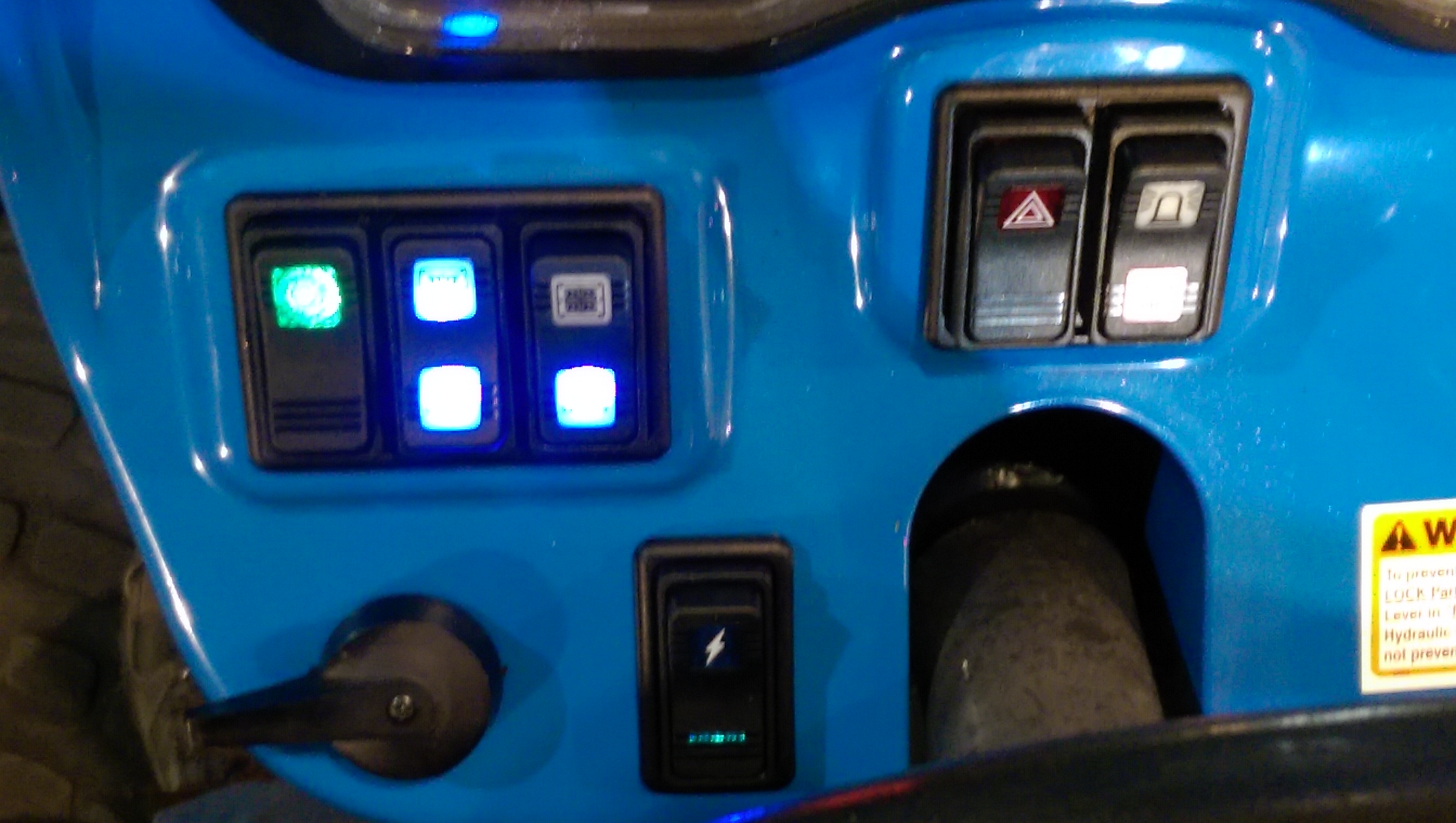

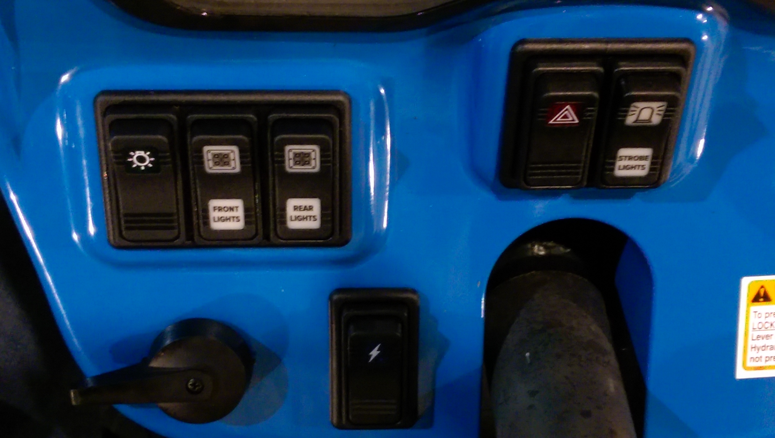

I would be looking at something from Carling Technologies... I personally like the V-Series Contura's (I like the Contura II & III versions).
They are an industry standard in marine, off-road & heavy equipment have been around for years & fit all standard cutouts... you can get them in almost any configuration (SPST, SPDT, DPST, DPDT) with or with out lights. They also make bezels so you can configure a custom switch bank & the switches are IP66/68 rated.
I have used the Contura V-series switches in every application with great result. (2 boats, tractors, heavy equipment & countless cars/trucks/off-road vehicles). I like them because of the many configuration you can get them in & that they are a reliable & quality product. They unfortunately are not the least expensive & sometimes will not fit for a certain application.
They are easy to operate with gloves on...
Here a few pics of the ones I added to our TC40's dash.
From their Website:
"Certified to IP66/68, the V-Series Contura switches offer complete protection against dust, prolonged spray and submersion under pressure and are recognized to UL1500 - Ignition Protection for Marine Products. These switches are vibration, shock, thermoshock, moisture and salt spray resistant with operating temperature ranging from -40ーC to 85ーC"
V-Series Contura II and III Sealed, Lighted, Snap-In Rocker Switches.

Yep, Contura rockers by Carling (and licensed to other brands) are the industry standard in the boating world. Several variations. I've never had a single problem with these switches on any boats over the years.
