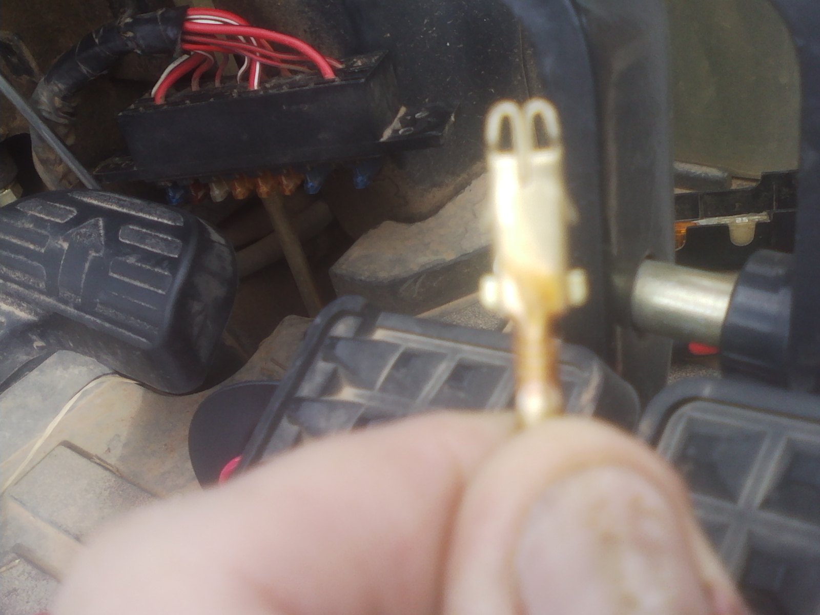

One of the female fuse holders out. Not tabs on the side that need to be flatten for removal

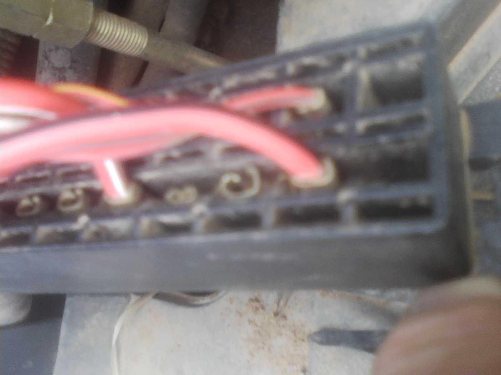

Back of fuse block befor jumper wire installed

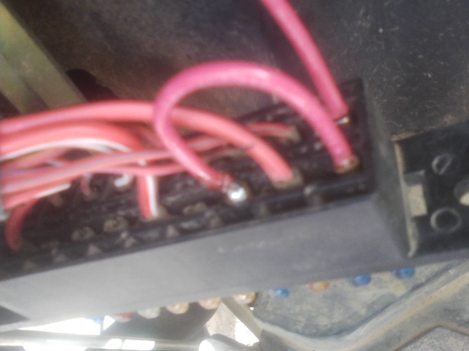

Complleated installation with jumper wire and new line out.
