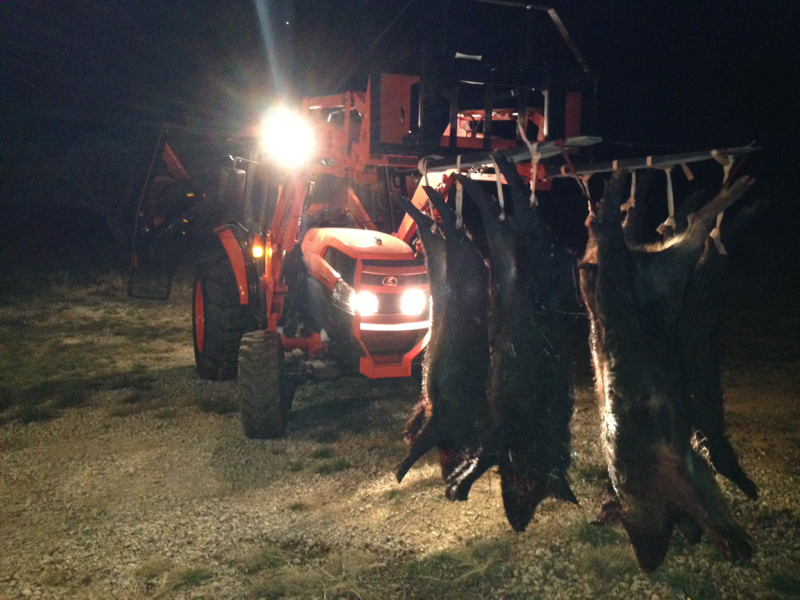

I moved my factory front cab lights to the back.The wiring is already there(wrapped in tape with the flashing cab lights) and purchased the factory switch for the rears.Fits perfectly.I replace the fronts with 27 watt LED's.Easy job to do.As stated your front hood mounted lights are on the signal stalk to the right.
   / Making hood lights on L4740 work #6
Front and rear all lit up :)
