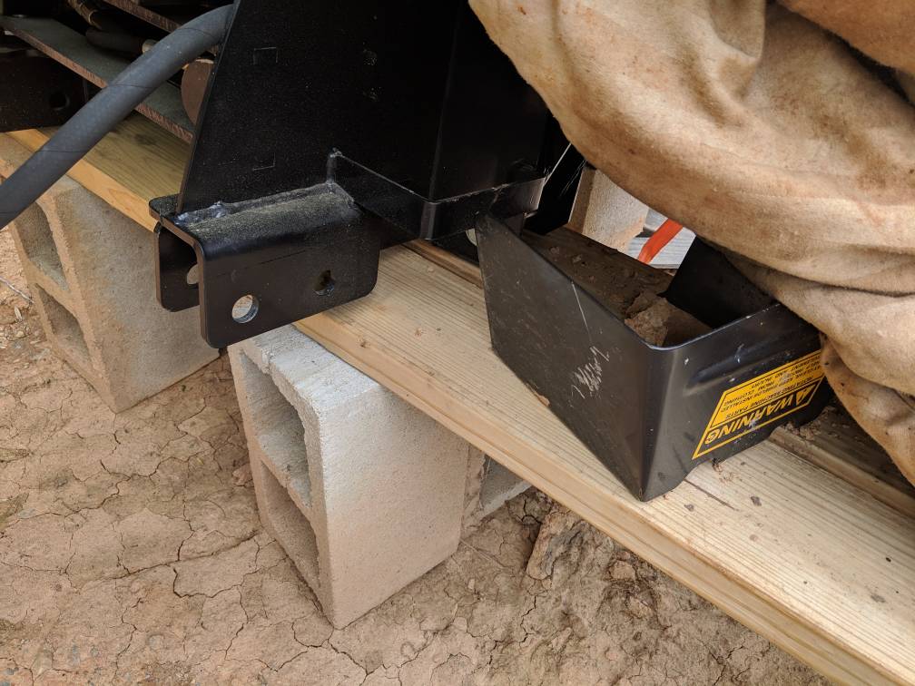

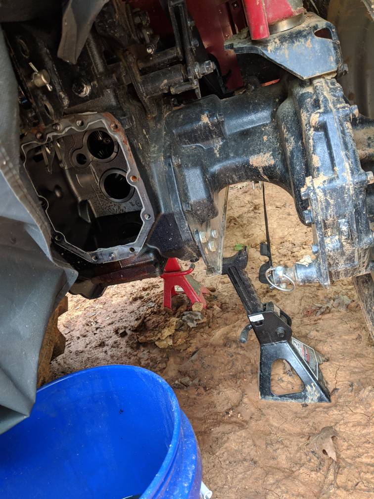

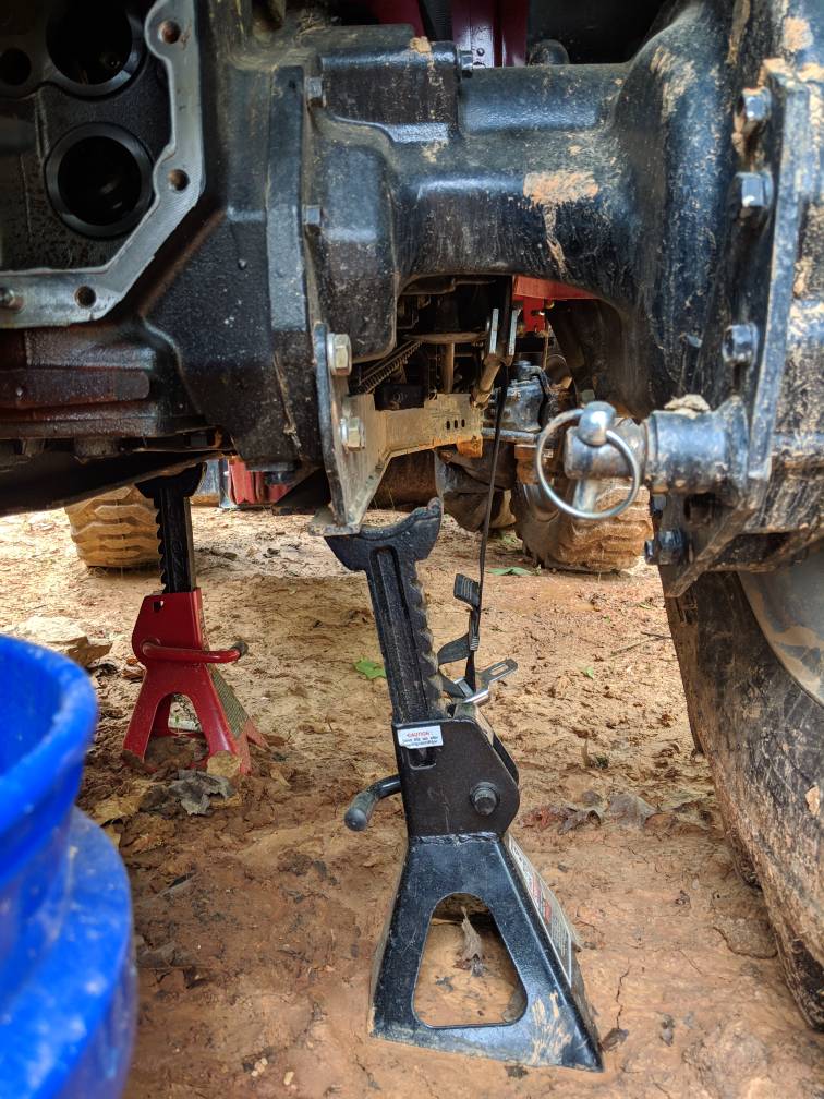

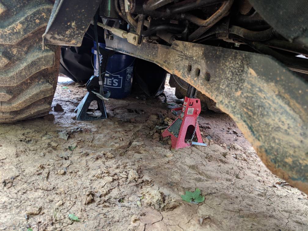

I'm going to add some pics today of what the back of the tractor looks like and the backhoe. I just can't see how anything will mount to the subframe.

Trying to figure out how I can fabricate a subframe to connect to the backhoe MVIMG_20190429_154816.jpegMVIMG_20190429_154809.jpegMVIMG_20190429_155100.jpegMVIMG_20190429_155020.jpegMVIMG_20190429_155029.jpeg
   / Mahindra 1526 and BH5600 PTO 3 Point Backhoe Tractor Excavator Attachment #6
Every tractor is of course different, having said that look at how different setups are done and see what would work best for your tractor, start with what Mahindra does.
Here's a link to a post I did on how I modified a NH backhoe to fit my Kioti. Not great pics I'm afraid. My goal was to make it easy to take on\off, and of course strength. After many hours use I can say I succeeded both ways.
There are many many good posts in this forum showing how people built subframes, look thru those, tons of great info and then you'll have a better idea how to build something yourself.
