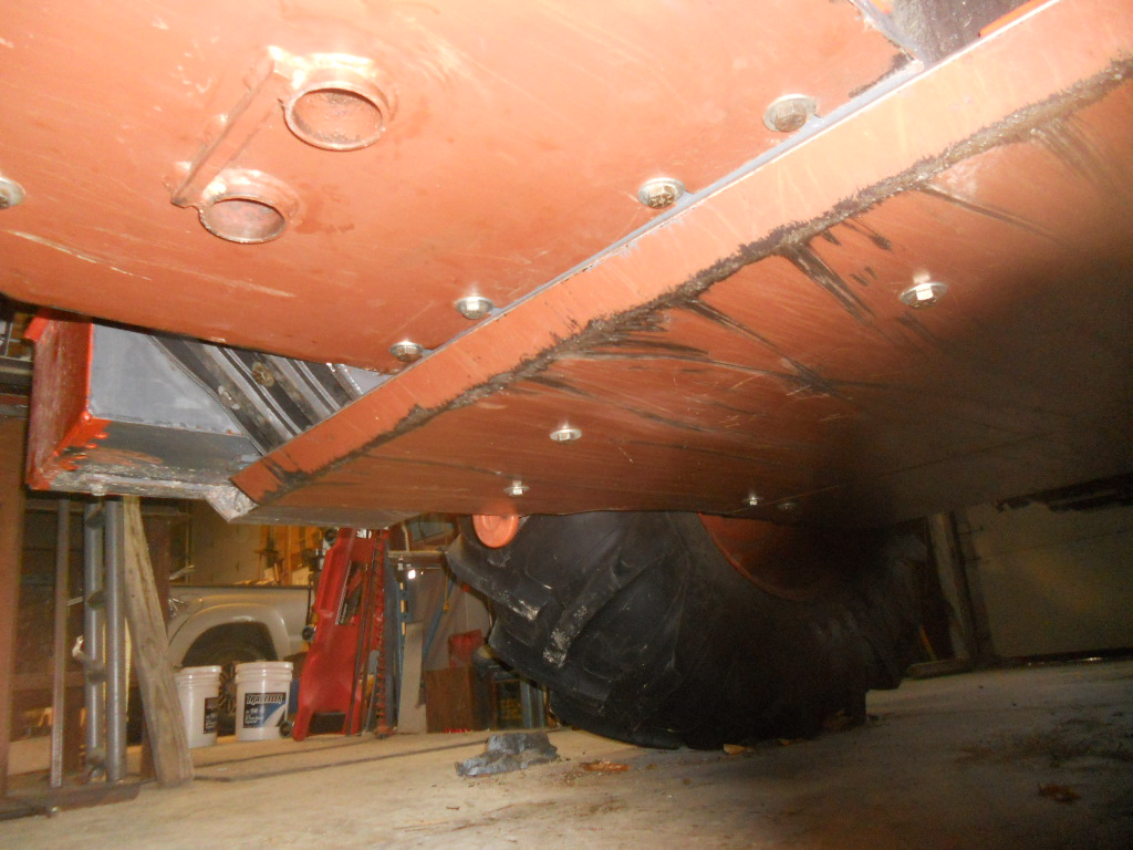

No I understand Richard and have seen your farmland property. Im on all timberlands keeping logging roads open and not a single "field" on all of my acreage. Then where I'm trying to beat back some invasive stuff there's the rocks that were left by the glaciers. Some as big as a school bus.
This pic is from 2016, I built the skid pan in 2013 and sticks don't leave a mark like these.:laughing:

NOW THAT'S A SKID PLATE!!!! :cool:

I’d love to see what all those bolts are connected to under that skid plate.

He posted pics of his really subframe for skid plate.

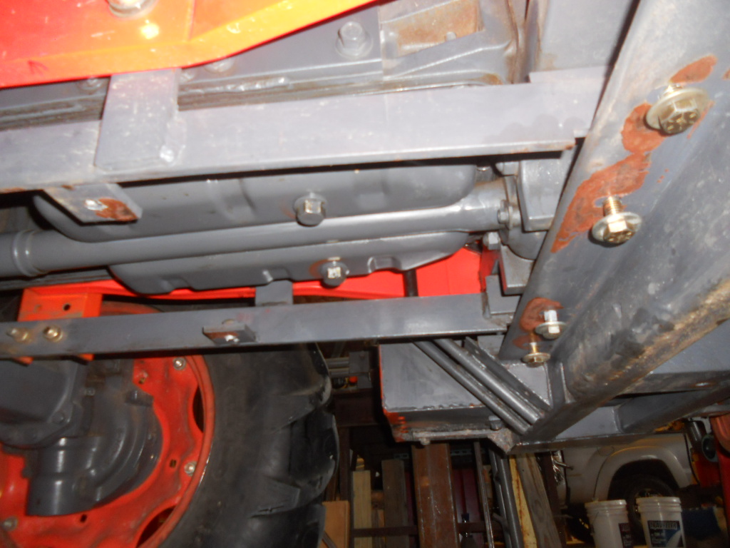

I壇 love to see what all those bolts are connected to under that skid plate.
That's where all the work is, the plate is the easy part. There's not a lot to fasten to on the bottom of a tractor.

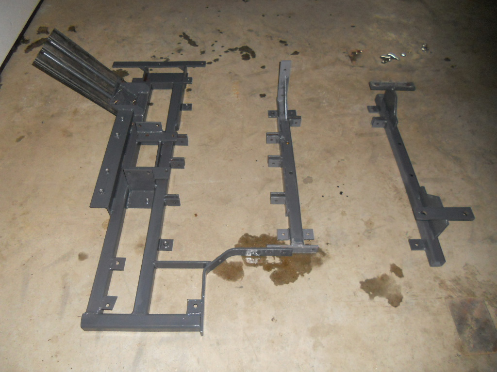

These are the 3 "sub frame" parts that run from the trans to the rear.

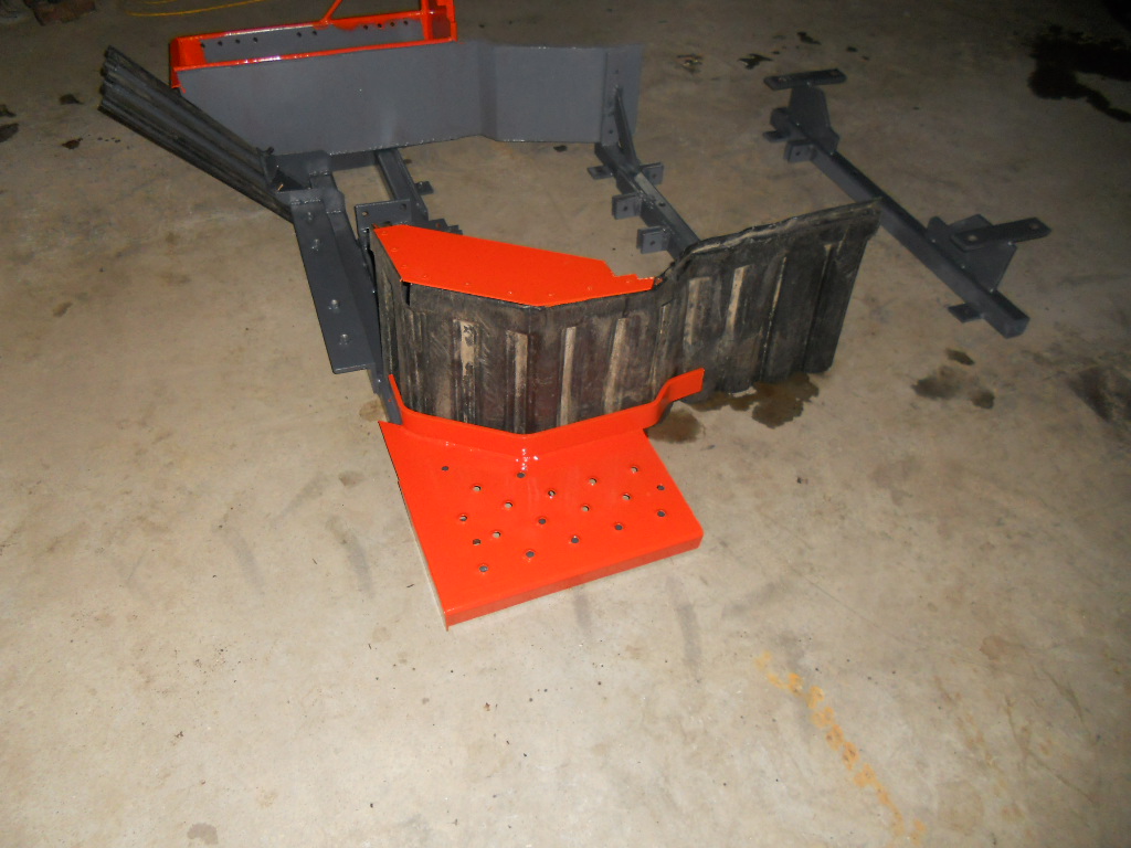

This is all the back half parts arranged as it will go on the tractor.
The fuel tank sides are vulnerable and the factory step is minimal. This view is from the left and shows the new step and one of my favorite materials (yes that's an old plastic pu truck bedliner):laughing:
The far side is a tool box and saw holder with a side panel that closes up that side along with the skid pan at the transmission filter area.
For some reason I quit taking a lot of pictures for the supports for the motor pan, but by the time I finished the back part the front was very simple.
Here's the front pan support, I used a lot of 2x3/8 bar stood vertical to carry the weight between my new sub frame parts. Got "tabs" everywhere for them and the actual skid pan.
That angle piece on the far side protects the loader hydraulic QA fittings and hoses and you see the back side of the toolbox.
