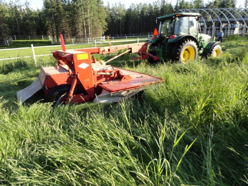

Looking to put up 1000# round bales of premium brome/orchardgrass horse hay. What size baler/bales can this tractor handle?(specs in sig. 70hp) Its an 8x8. Gently sloping 45 acres.
I was thinking about running a disc/conditioner and some kind of tedder/rake combo. Some people say 70hp is good for 8ft disk cutter others say 9ft? I prefer leaving the widest swath I can. Need to get the hay up quick and green. :)
Any advice would be much appreciated.

I would think at 75 hp you have enough hp for most round balers. For 1000 lb max rolls, you could probably get by with a 4x4 or 4x5 baler. The 9 ft should not be a problem for the hp you have. We sell a new Fort 8 ft disc mower for $6995 delivered in the crate to Co. We do have several used hay rollers that you can look see at www.sweetebay.com . Click on Hay Equipment. Ken Sweet
   / M7040 making round bales #3
I think you'll be hard pressed to make 1000# 15% moisture rd bales with a 4X5 rd baler. Several yrs back I bought several 18 wheeler loads of Brome 4X5.5 rd bales that averaged 950#s baled with a nearly new NH baler. I own a Kubota M7040 that I use to pull a Vermeer M7030(9'3" cut) disc mower(no conditioner) and it handles 4X5.5 bales very well. I like the hyd shuttle shift very well for handling rd bales.

Jim, would you expect any power issues on a 9' with conditioner? I'd like to get the max out of my equipment. Working is fine, just dont want to be tearing things up.
How did the 4x5.5 handle? I'd like to stay 4 wide for transport reasons but some people say 4x6 topple too easy and pita to get stabbed?

you can pull a 4 by 5 baler and a 9ft disc mower with a 7040 easy.i would just buy a wheel rake.
   / M7040 making round bales #6
I would stick with a 4x5 baler max or an older Gehl 1865 or something similar since they didn't pull as hard. 9ft 3pnt disc cutter max. (you can get a bit bigger on a Vermeer Rebel trail mower) the new high speed V rakes are hard to beat for that size operation... built much stouter than old pipe wheel rakes. I wouldn't get into MCs unless you plan on doing a lot more hay.

Do you think a M7040 will easily pull a 9' disc mower with a conditioner cutting Brome/Orchardgrass?

Your going to be sitting right at the minimum of the PTO requirement of most MCs with the 7040. Always good to stay a good bit over the minimum but im sure it would pull it.. just a bit slower

That's what I was thinking also. That's the reason I was questioning bigbull338's statement about a M7040 easily pulling a 9' cutter.

I've been told conditioners are needed in order to get the hay up quick and as green as possible. (In 2nd/3rd i doubt its doing much as thrres little stem?) Even in the dry Colorado weather the guys I buy premium hay from all seem to condition, tedd and rake grass hay to get it up so green?
