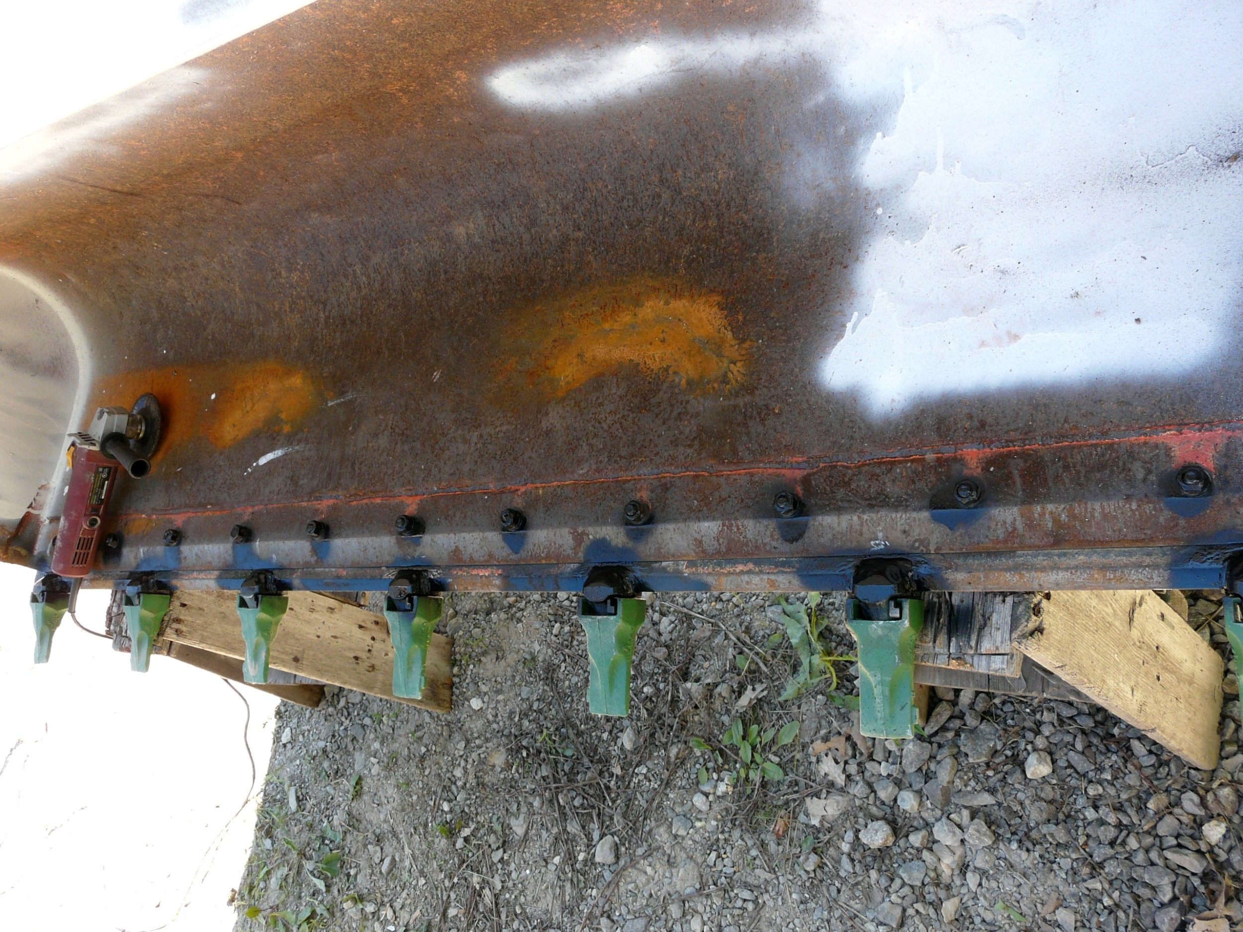

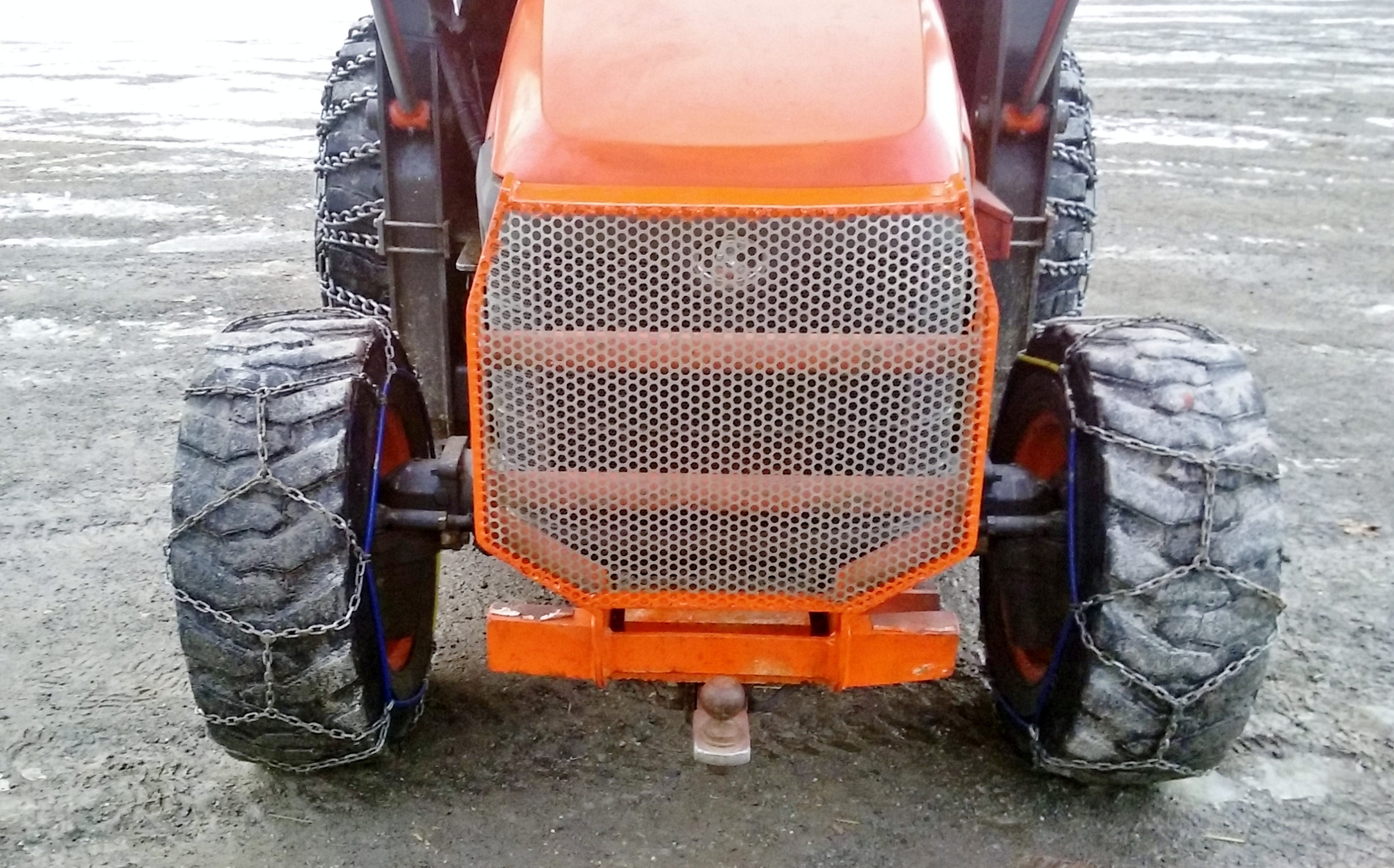

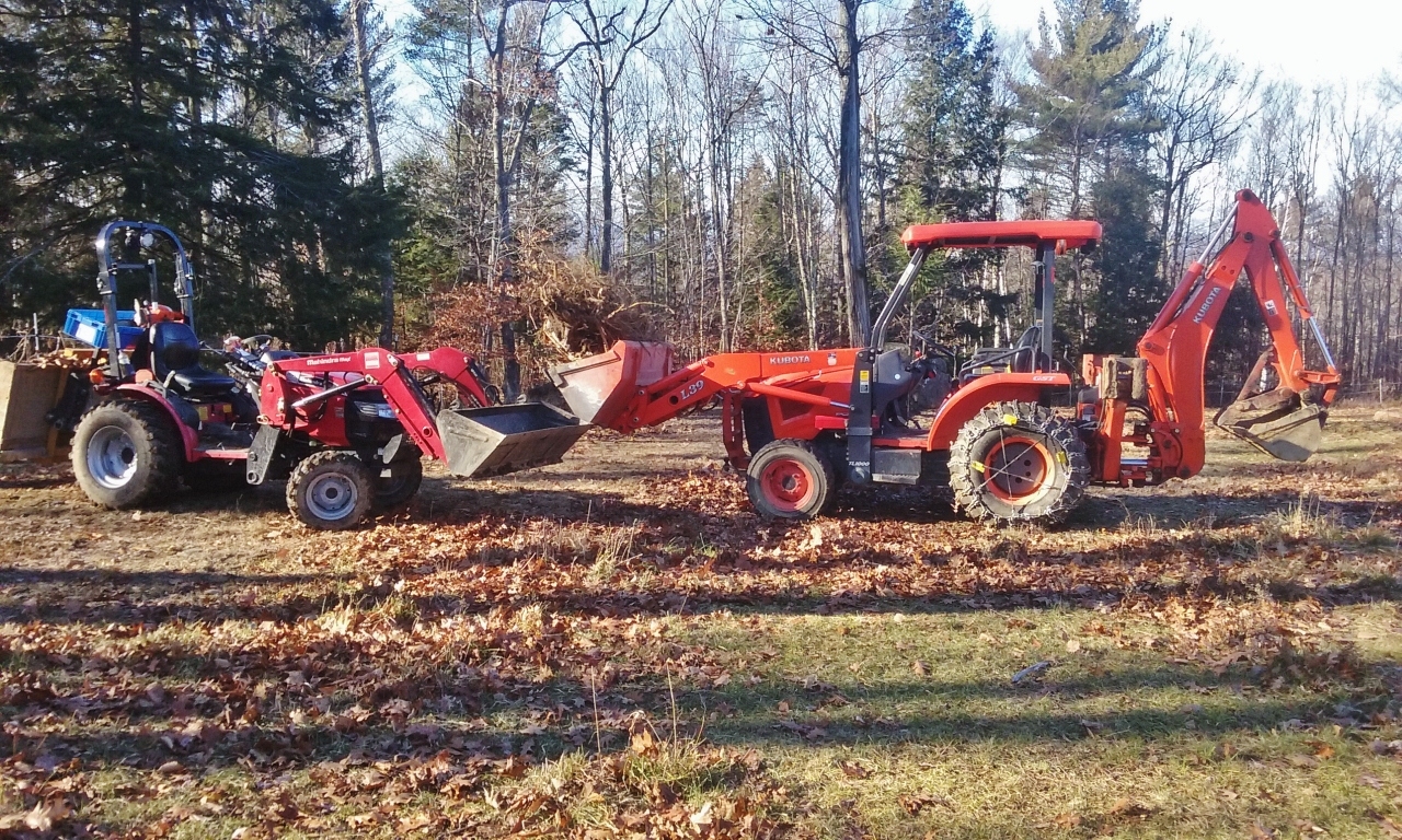

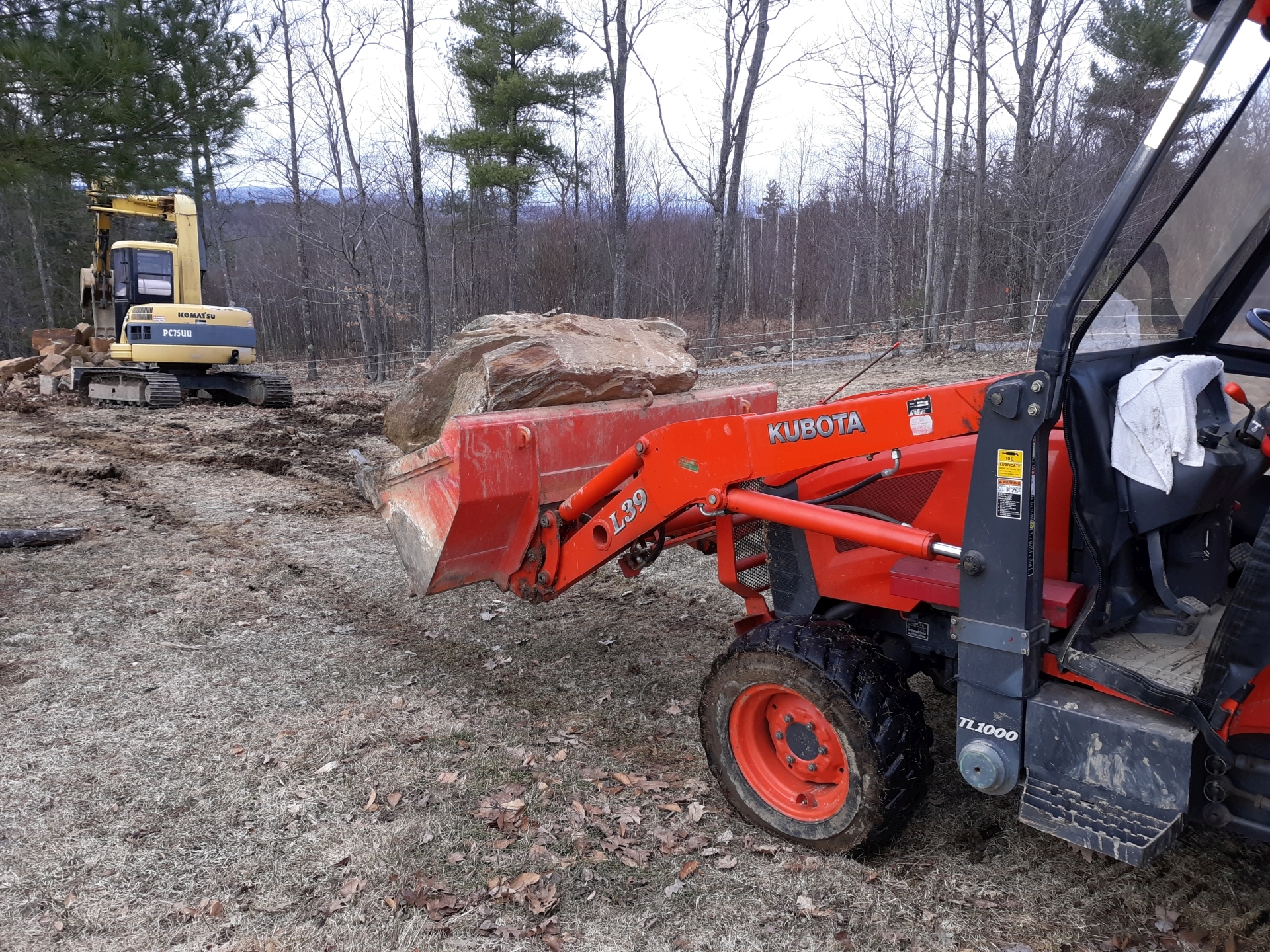

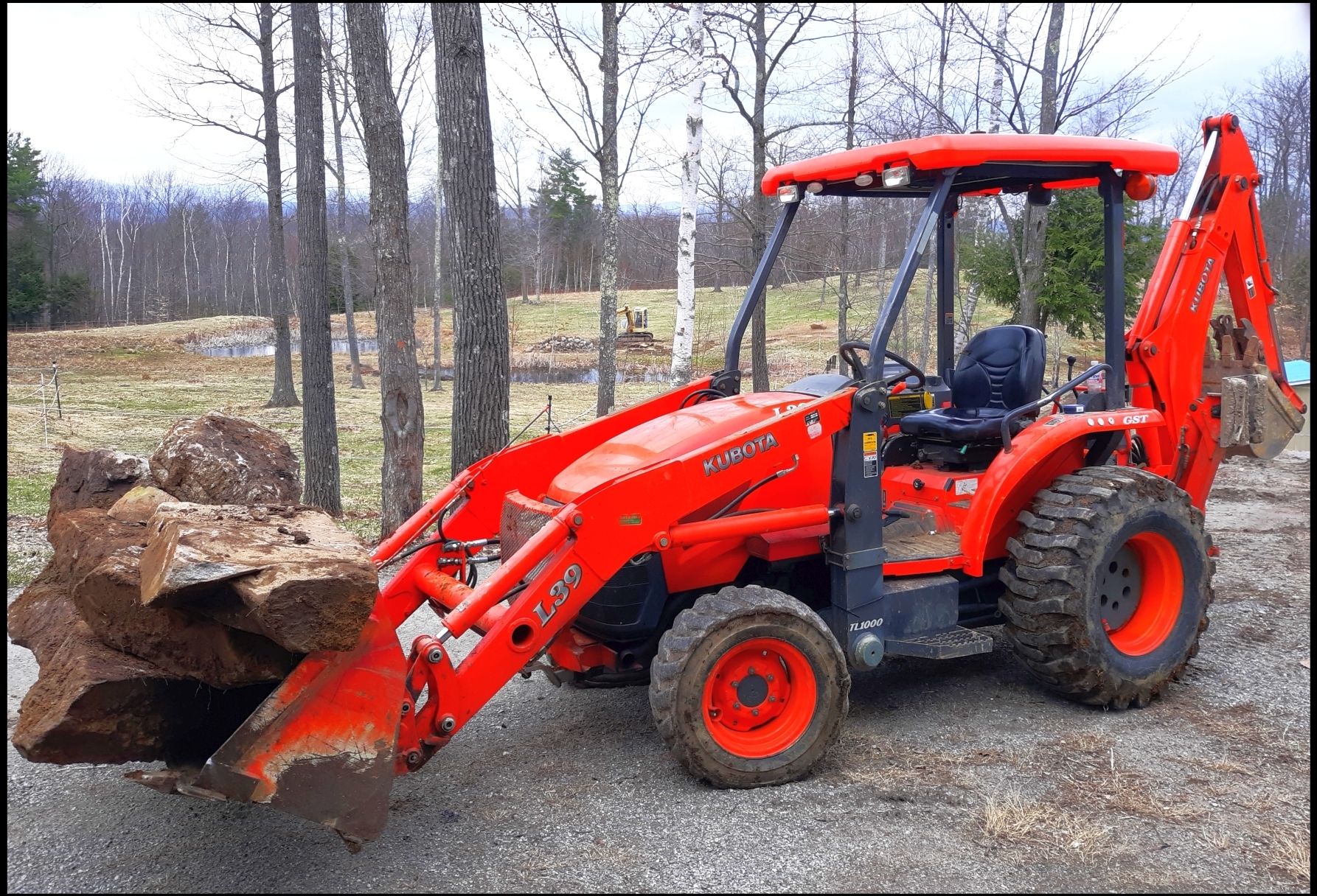

On my L39 I filled the hollow Loader tubes with Durabar adding about 130 lbs midsection. On an M62 having larger tubes, guessing this would add another 200 Lbs. They were set using epoxy cement and have not gone anywhere. I also have welded up the front guard adding a trailer hitch and a front counter weight adding another 75 Lbs to the front. It is still very light on the front end without the bucket, especially with a HD +100 Lb thumb on the hoe and reinforced bucket.
